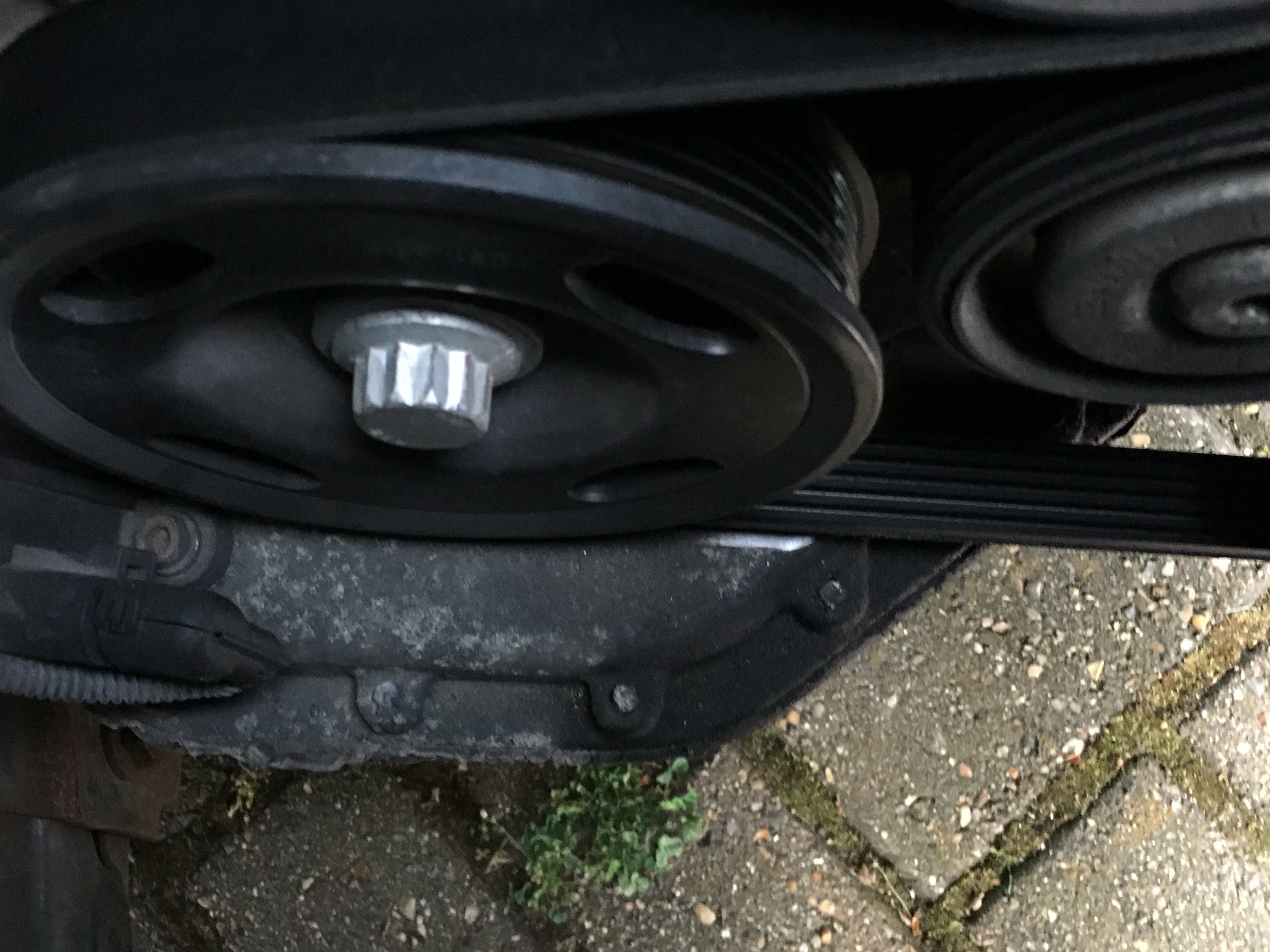

Also, when i look a the belt, it has or is touching now and then as can be seen by the shiny patch below the pulley, would this be a stretched shiny pulley or the tensioner? Cant feel any play by hand on the tensioner and I suppose if the coil spring has broken, it would allow play and very noisy
https://uk-polos.net/download/file.php?mode=view&id=454
Any feedback or advice appreciated
Cheers
Andrew

- Posts: 5900
Re: Engine sound when pulling away 9N
That is a horrible noise!
These engine mounting are very compliant so I'd think that they are okay.
The shiny bare metal area - I'd think that you should be concentrating on working out why that has been happening and stopping it.
Sorry no more ideas!
- Posts: 146
- Joined: Tue Mar 01, 2016 1:01 pm
- Drives: Polo 2004
- Location: Leigh on Sea, Essex
Thanks for quick response
Presume the belt can either be stretched as its very very shiny or the tensioner has weakened. There again, I'm not convinced a tensioner with that sized spring can weaken. That only leaves a soft or stretched belt, can't be anything else surely.
Although then engine mount is captive rubber and may not be knocking, a soft one would surely allow the engine to rock more and even the exhaust movement would be affected etc
The mounts appear a reasonable price Borg and Beck I have seen for £35'ish on ebay so maybe worth replacing anyway, not sure
Thanks again
Andrew
Thanks again
Andrew

- Posts: 146
- Drives: Polo 2004
Ok, today finally got round to removing the belt and wow, noise gone. Presumed and replaced new belt tensioner and alternator tesntion wheel. All done and noise now back.
The air con pump seems to be the problem when I listen with a stethoscope I can here erratic knocking.
What puzzles me is that you seem to hear this noise when steering is on full lock or when youre pulling away. At low revs. Why should it do that?
Looks like it’s eBay pump and get it topped up
Andrew
