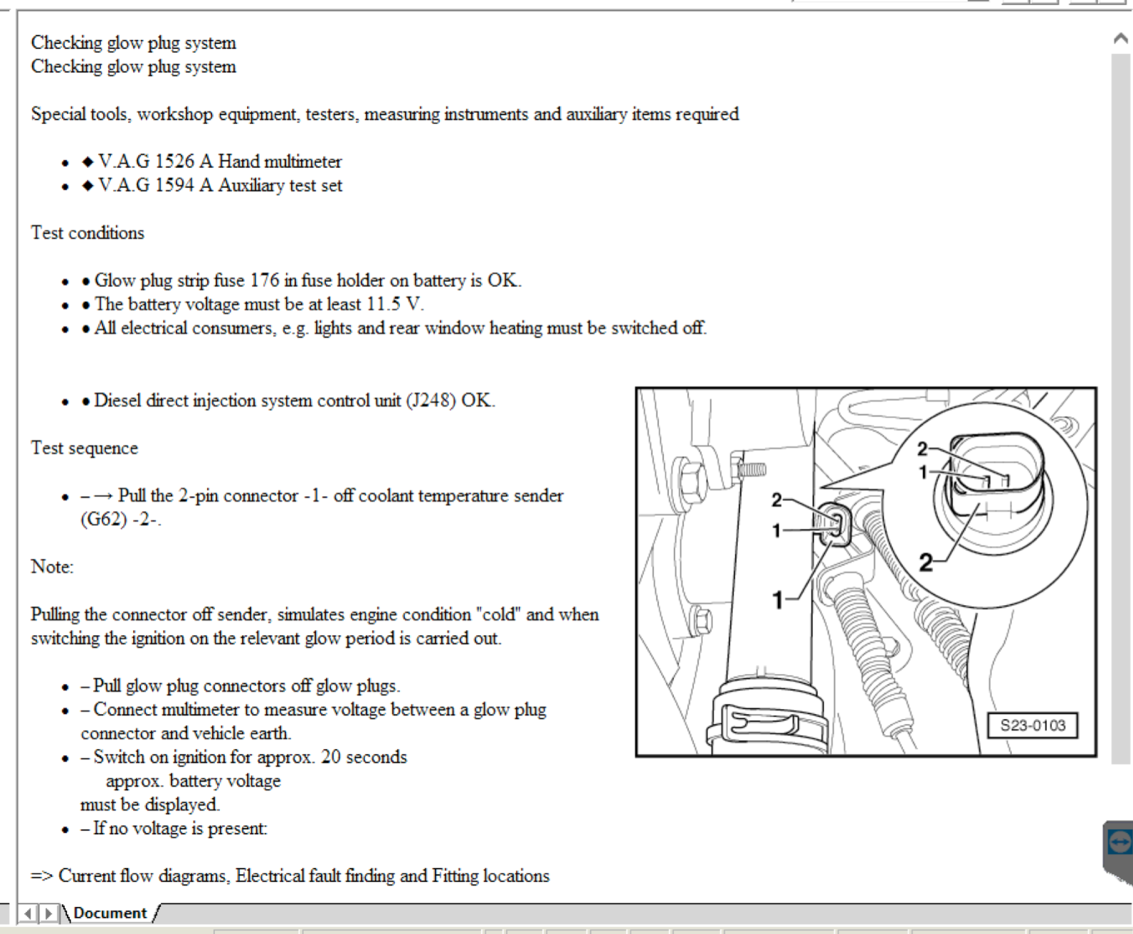

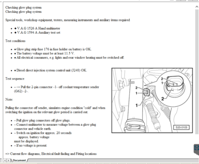

From the workshop manual
Pull the 2 pin connector off the coolant temperature sender (g62) to simulate a cold start and see if they work

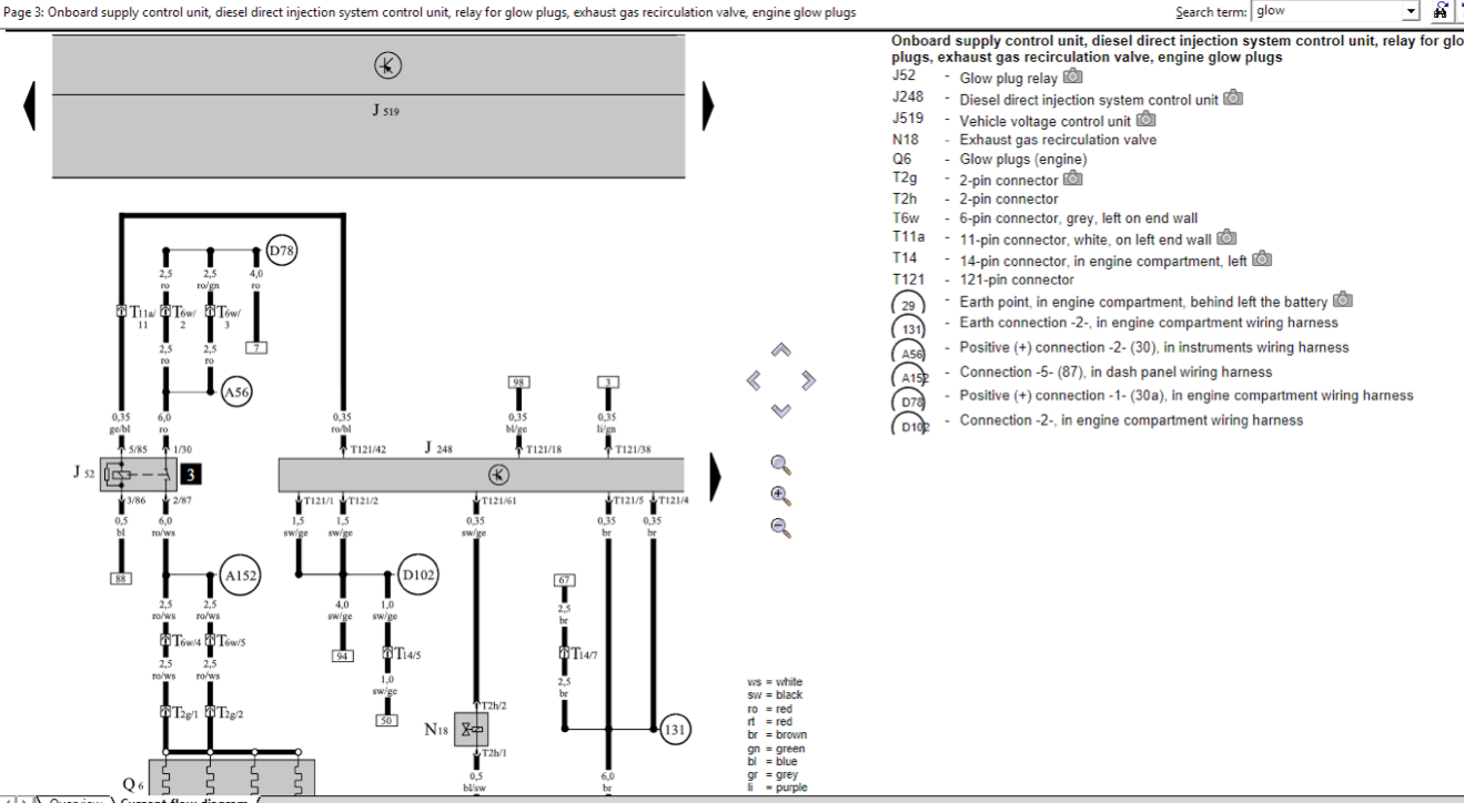

Re: please help!!
Wiring diagram.
The trigger for the relay comes from J248 - the diesel direct injection system control unit (which is actually, the engine ECU)

Yes, when I pull off g62 connector and switch on the ignition I can ear the glow relay "click" sound and glows start to heating.
