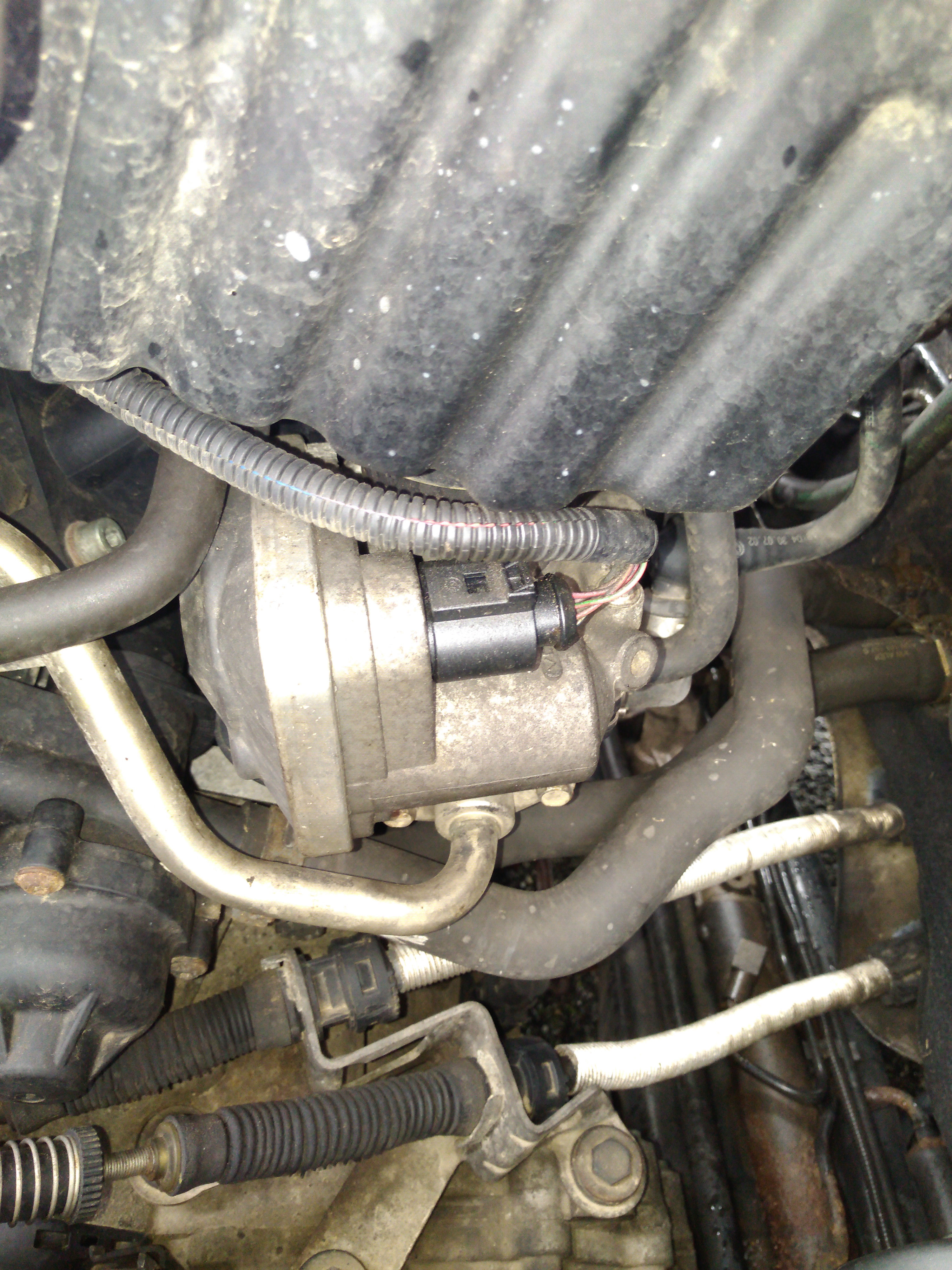

Ran the engine today 1.2 3 cylinder,and i have a sound which is like lots of small ball bearings,coming from the rrear of the cylinder head on the right side below the rocker cover as you look under the bonnet.You can only just hear it but quite loud when you take a closer look.It has a aprox 3" plastic cap with some pipes and is bolted to the head,a electric connector which is pointing to the winscreen.I have looked in the Haynes manual but could not see it illustrated.I have had the engine running on idle before but never have noticed this before.Thought it could be the fuel pump but not sure.Anybody know what this component is, the car runs fine and idles ok

Just had another closer look after a journey it does not seem to be so noisy it looks like it is fitted to the manifold with a alloy pipe running underneath with a sharp left bend held with two bolts fitted just behind and lower than the component.

I think i have found out what it could be the EGR valve or throttle body,but is it supose to rattle like lot of small ball bearings?

Re: Mystery component on Cylinder head.
Please take a photo and post it up showing the part in question
That looks like the Throttle Body though it could be the EGR and no it should not rattle
Thanks for that info,thought it might be EGR but wanted to make sure.The car has been running ok and it passed the MOT last November ,i do not know how long it has been sounding like that and if it only happens now and again.If it was like that during MOT time i would of thought if the EGR was faulty in any way it would not of passed the MOT emmisions test,could be wrong.i do not know what is inside them only a valve of somekind which can get dirty and needs cleaning now and then. I will keep an eye on it to see if it gets worse,Thanks Alex.
It’s just a solenoid that opens and closes the valve. The EGR doesn’t operate all the time. The MOT emissions test wouldn’t make it operate
Apparently that is the throttle housing and the EGR is on the right front of engine .I have booked it in for a Diagnastic (has not had a full blown diag for few years)to find out why it is running bit rough on idle ,took air cleaner off and it was clean (suprised) so have to see what comes up in the test.The egr in the front might need cleaning so will wait for the test results.
Hum, now that you have said "throttle body" I can see that it is exactly that, prior to that I was thinking "that is not the EGR valve" - but no more than that.
In my experience of EGR valves in VW petrol engines, they normally stay clean - so that means that they do not suffer the horrible life that TDI engine EGR valves suffer - if that helps at all.
