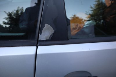

Anyone repaired paintwork to the window pillars/boarders? I was wondering if there's a particular type of paint or finish to use for the polo 9n models?

These are made of aluminium
A decent primer and satin black automotive paint will do the job
