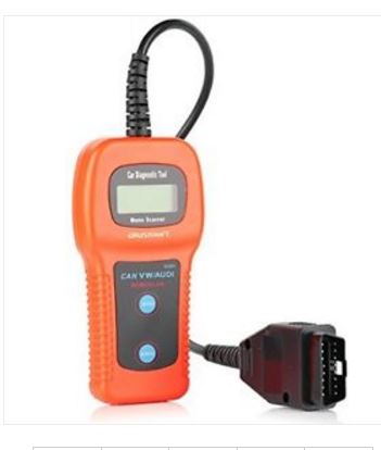

When we got our Polo I bought a cheap VW compatible scan tool and it has worked ok so far.

Any recommendation on scan tools?

I got a cheapie (model U281) off ebay a few years ago - works fine - easy to use and will erase codes and will extinguish EML lights.
I am sure their are better/more modern ones available.

Thank you for the suggestion for the scan tool.
