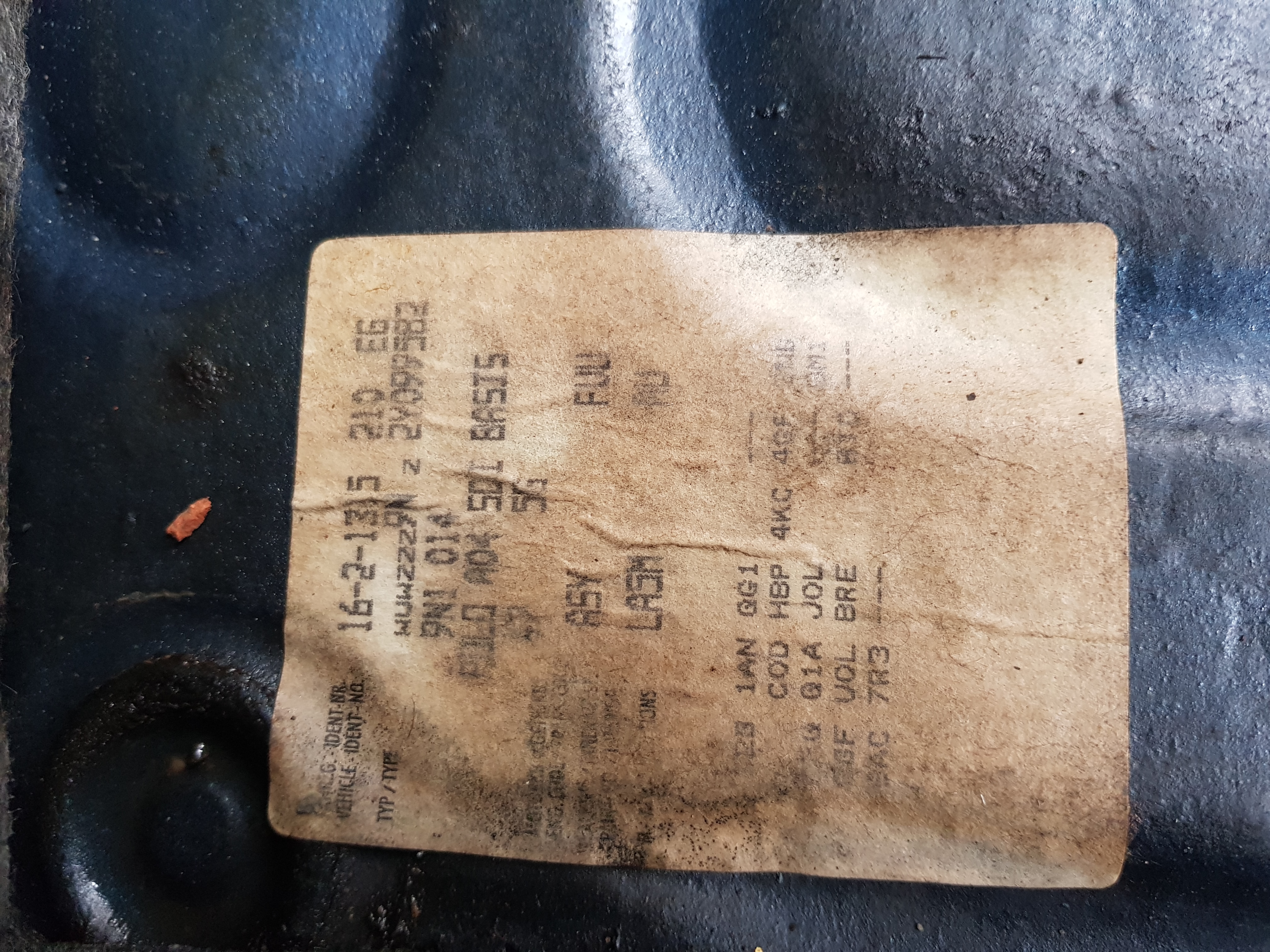

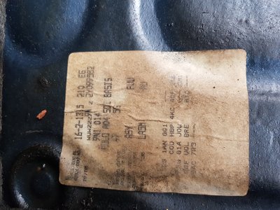

Any idea on the engine code? Pop a photo up of the sticker under the boot carpet if you can

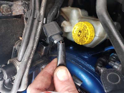

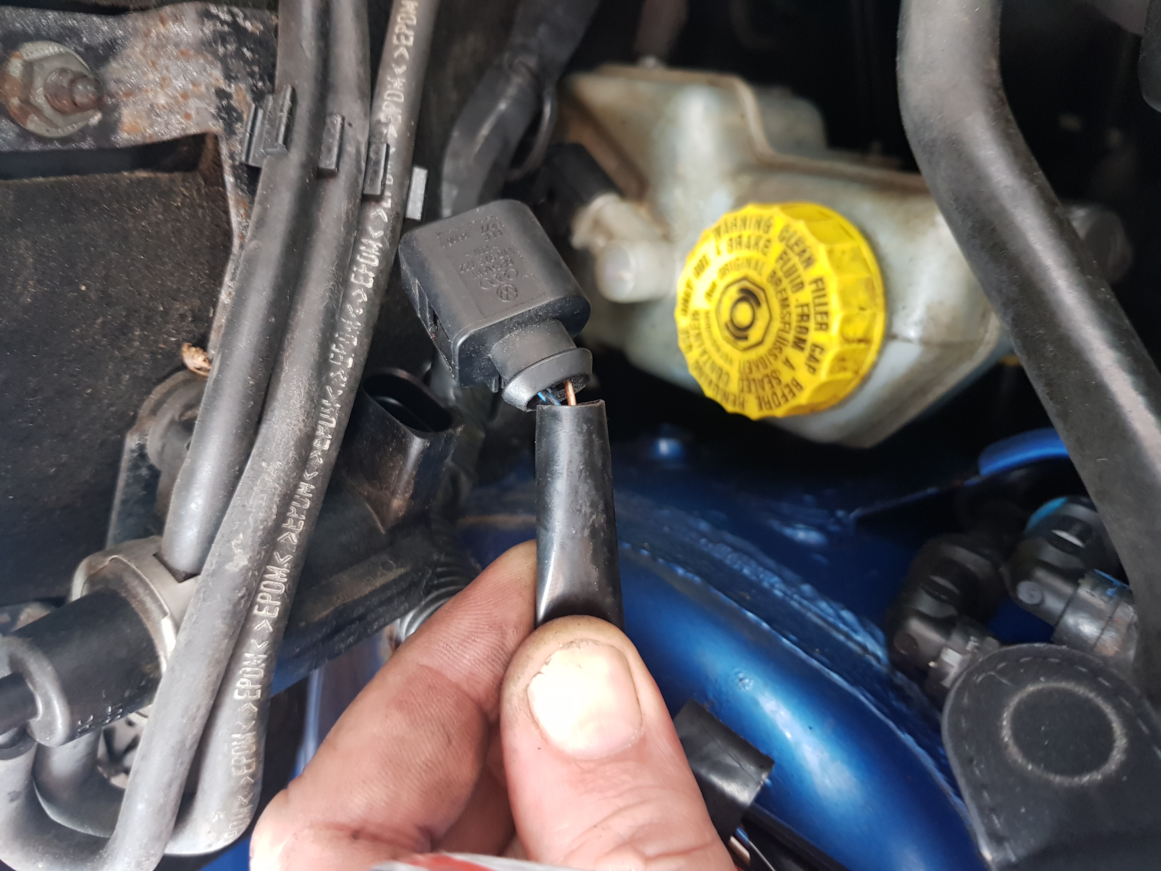

Re: Polo 9n SDI 02
Here the sticker just going to go through engine bay and drive ers fuse box
Re: Polo 9n SDI 02
Both wires brown and brown have continuity with live ? The brown has a white tracer
- alexperkins
- Site Admin
- Posts: 14866
Re: Polo 9n SDI 02
Which plug is that off? Thats brown/white so it might well be a power feed. Ill check the diagram once you confirm
