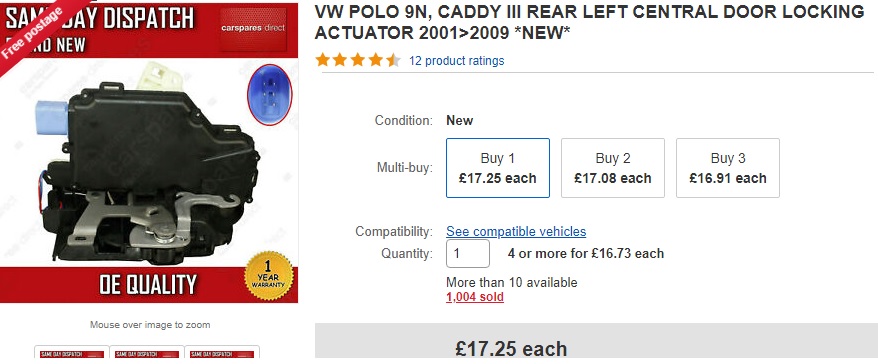

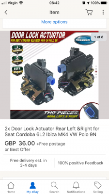

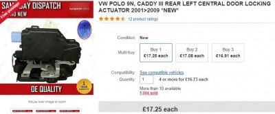

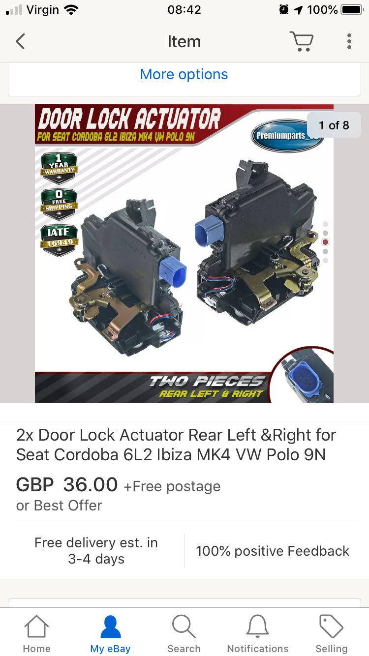

Sourcing a new lock. There are quite a few locks on the bay at around £20 . Has anybody had experience of these locks as looking at the complexity of the lock I find it had to believe these can be produced at this price

I first ordered a £17 aftermarket one made by SENCO comfort systems , then thought twice about it so also ordered a 2007 one with VW stamped on it from a VW dismantler £45
Before deciding which one to fit I tested both by plugging in direct to the door loom. To my surprise both worked fine, the motor in the £17 sounded quieter than the £45 one.
