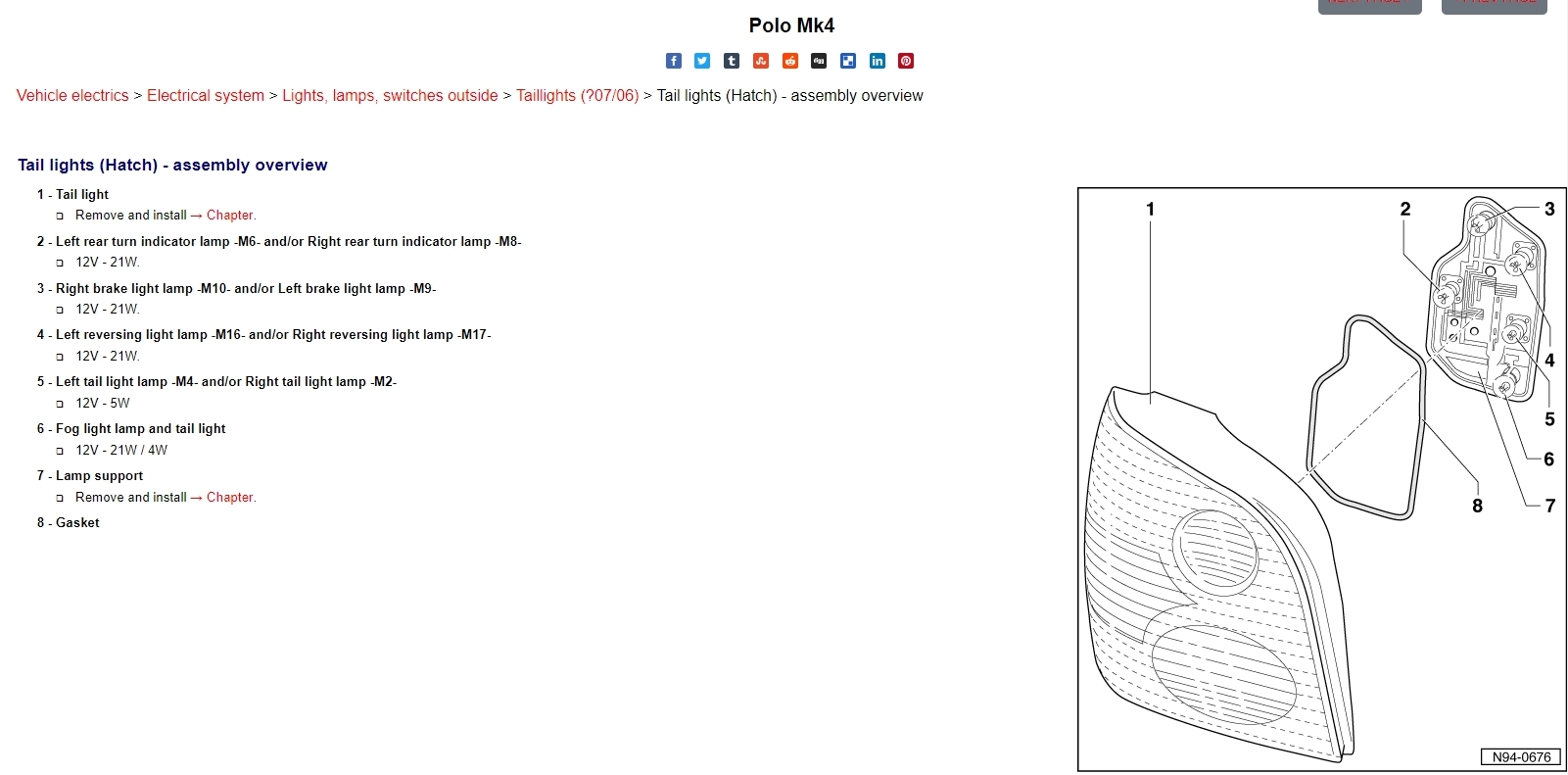

As for the bulb, following your message I did some digging online and found this. There are two bulbs, and the one that's gone is [5] on the diagram. Just got to work out which bulb it is now as it's not a stop-tail (the stop light being [3]) and don't know if it's a 380 or 382. Every car I have involves detective work to find out what bulbs are used!

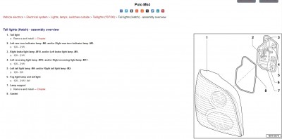

Yes there is def two bulbs as i replaced mine yesterday with half circle on rear drivers sidefoolhandy wrote: ↑Sun Dec 22, 2019 4:13 pm Thank you. You've confirmed my thoughts that I really need to get a new unit - the boot is wet again and that's where it's coming in. Just have to make sure that the top clip comes with the replacement unit...

tommy.horsman wrote: ↑Sun Dec 22, 2019 7:16 pmYes there is def two bulbs as i replaced mine yesterday with half circle on rear drivers side the bulb is a 12v r5wfoolhandy wrote: ↑Sun Dec 22, 2019 4:13 pm Thank you. You've confirmed my thoughts that I really need to get a new unit - the boot is wet again and that's where it's coming in. Just have to make sure that the top clip comes with the replacement unit...
