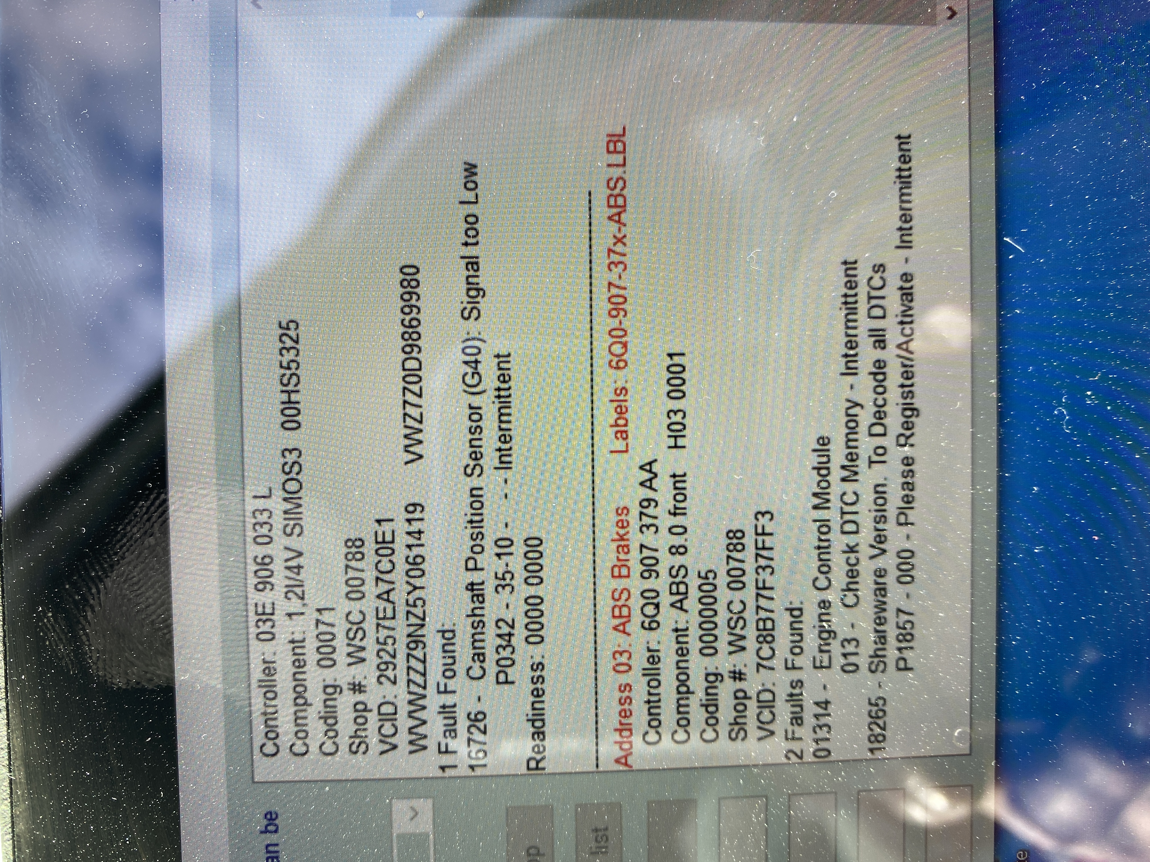

hi all any help with this code? polo 00816 power steering sensor g250 30 00 open or short to plus..
recently had a steering rack change - second hand one, and ive had tracking done. also tried a different g250 sensor but still get the light come on dash with steering wheel picture
also a abs code comes up also,anyone help me check the values of the steering rack when it moves in vcds and all i get is activate it? do i go on single reading? ive got the free version

As for the ABS code check that the main harness is securely connected to the ECU. ECU is mounted on the top, right hand side of the firewall in the engine bay next to the ABS pump.

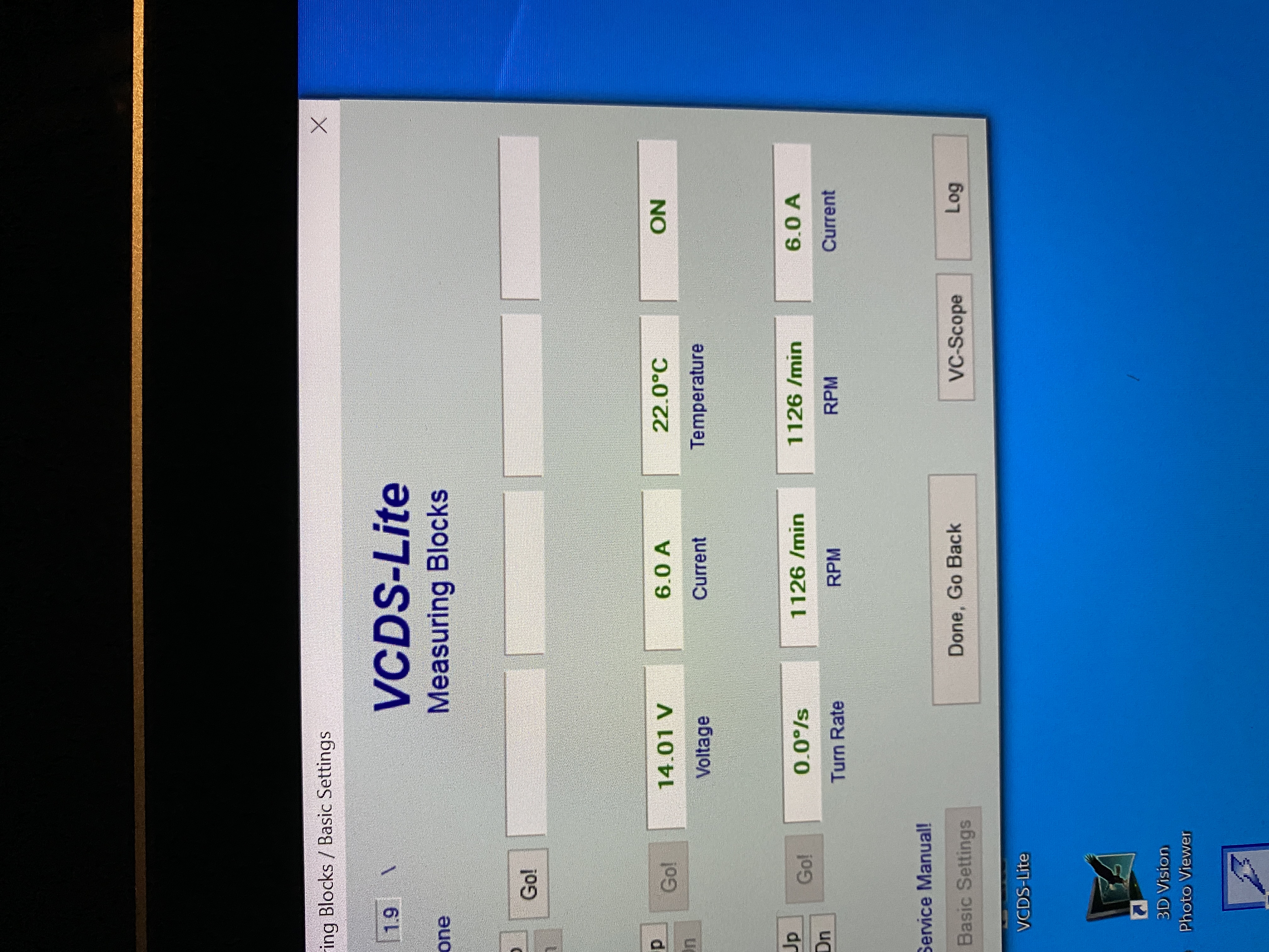

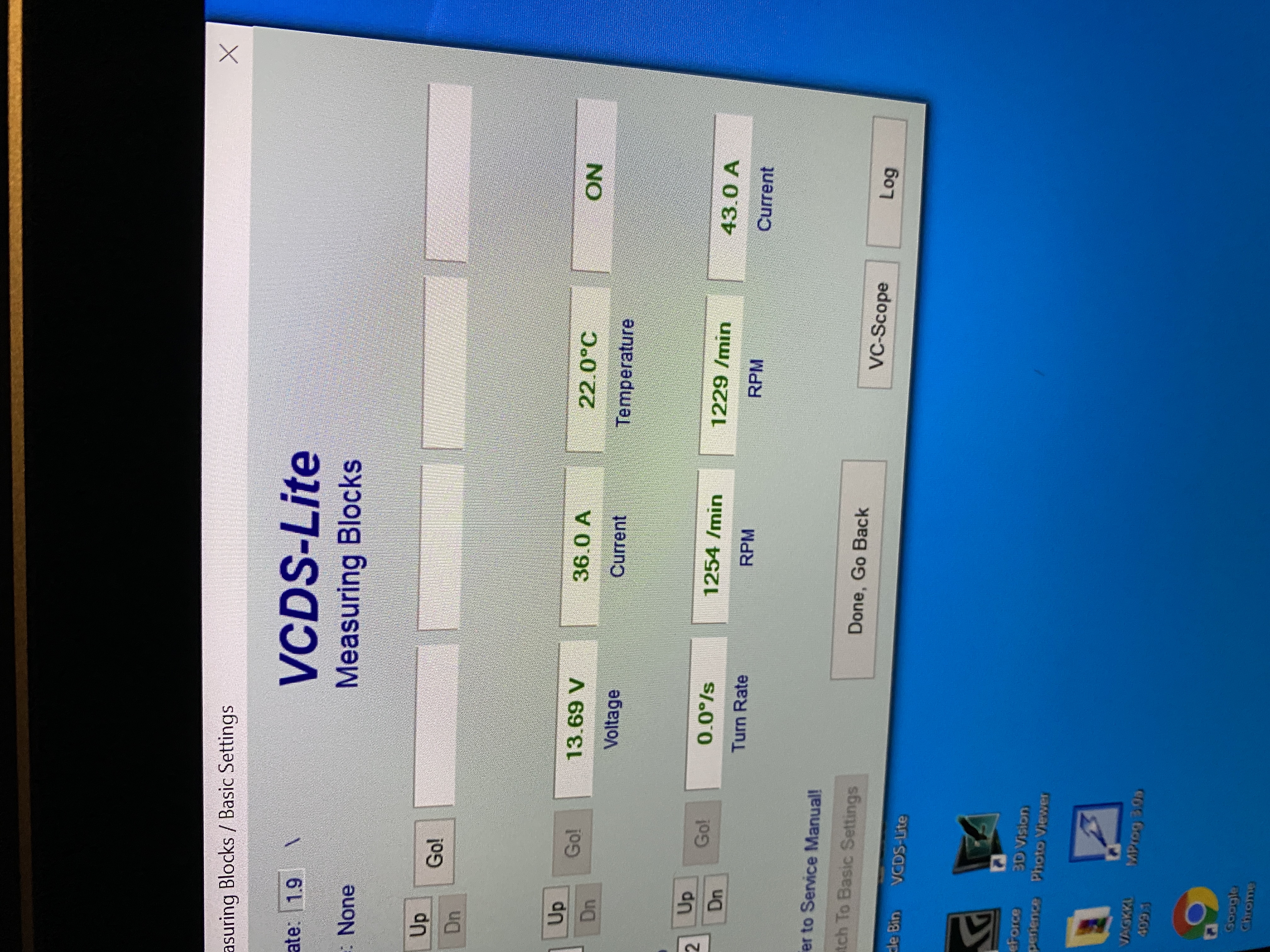

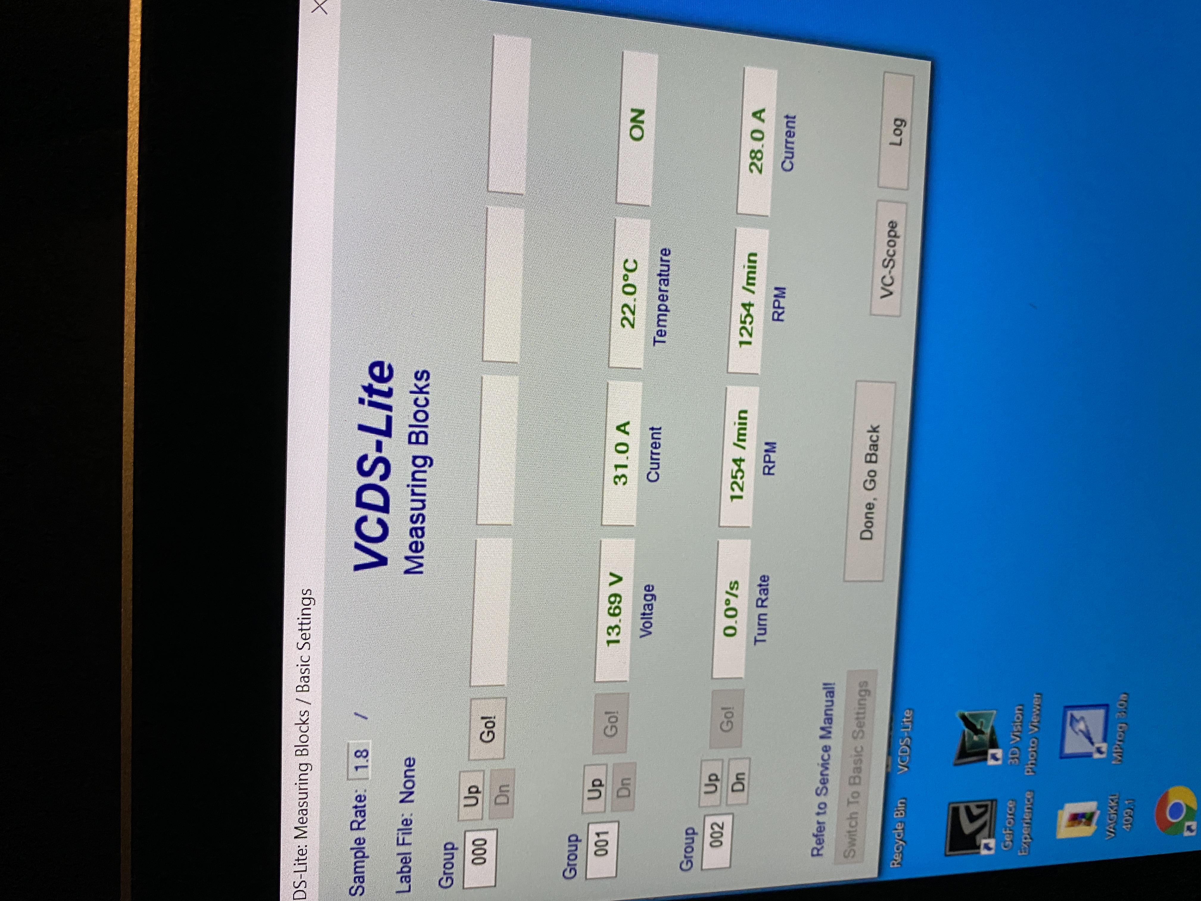

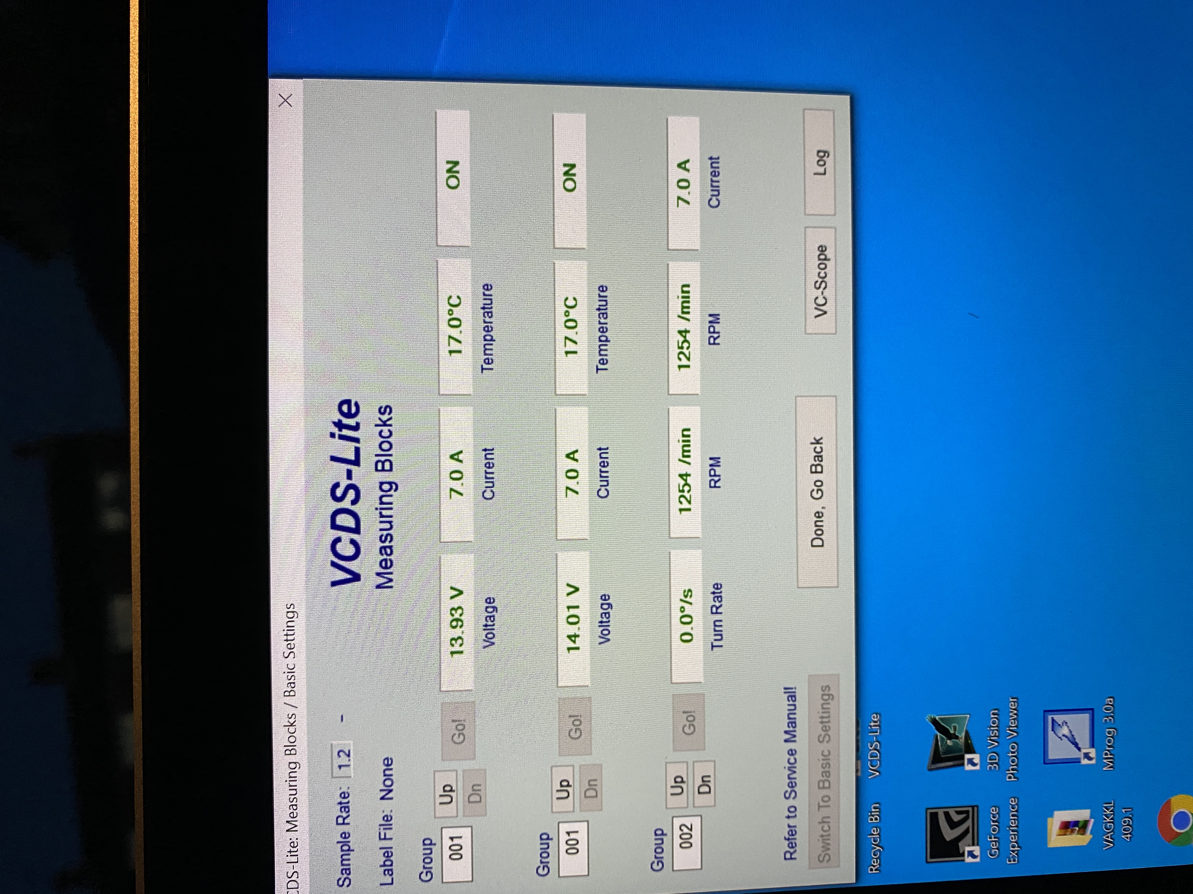

readins with wheel turned left and right and 2 other readings

only thing i noticed when i turned the wheel was the amps would go up? when fault light come on dash and gives a code in vcds couldnt clear it unless i switched engine off - then cleared it fine, the turning sterring wheel left or right fault light came on, wouldnt let me enter basic settings in vdcs - saying must register or something, so not sure how to get angle sensor readings

Current will go up as the pump will have to work harder the further you turn the wheel so that's normal
