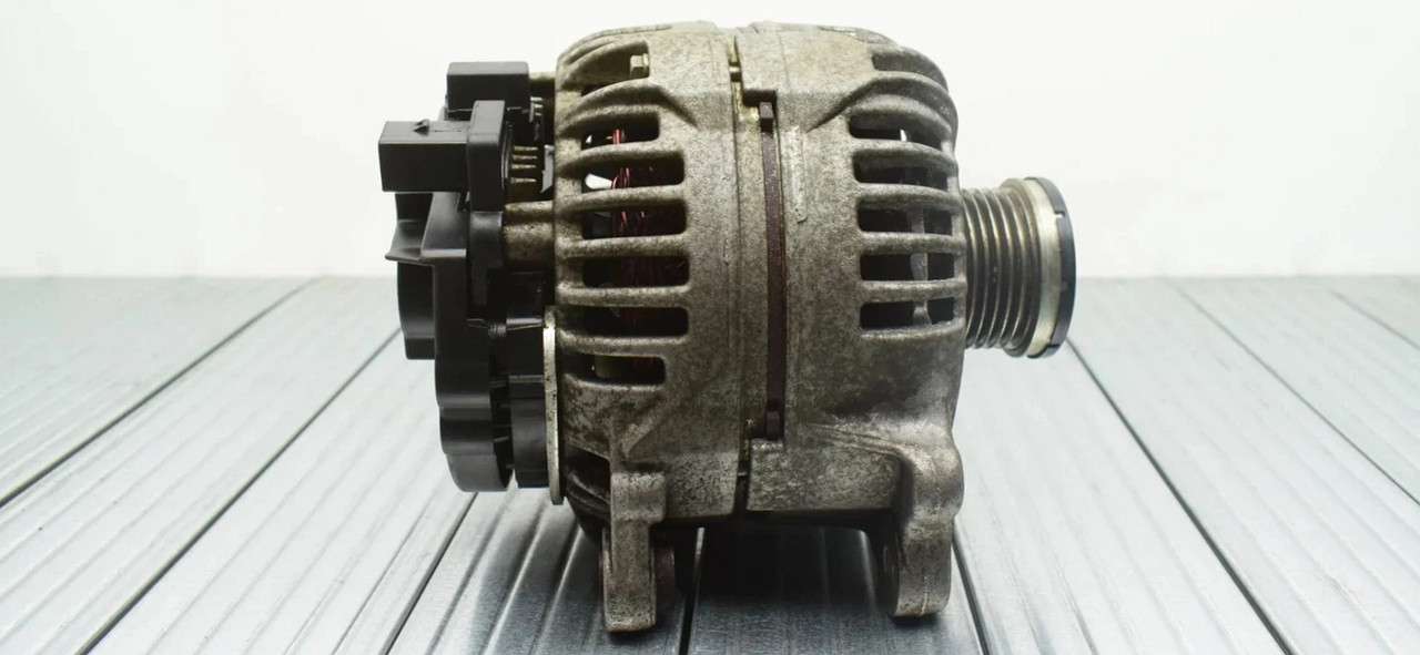

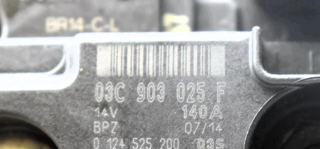

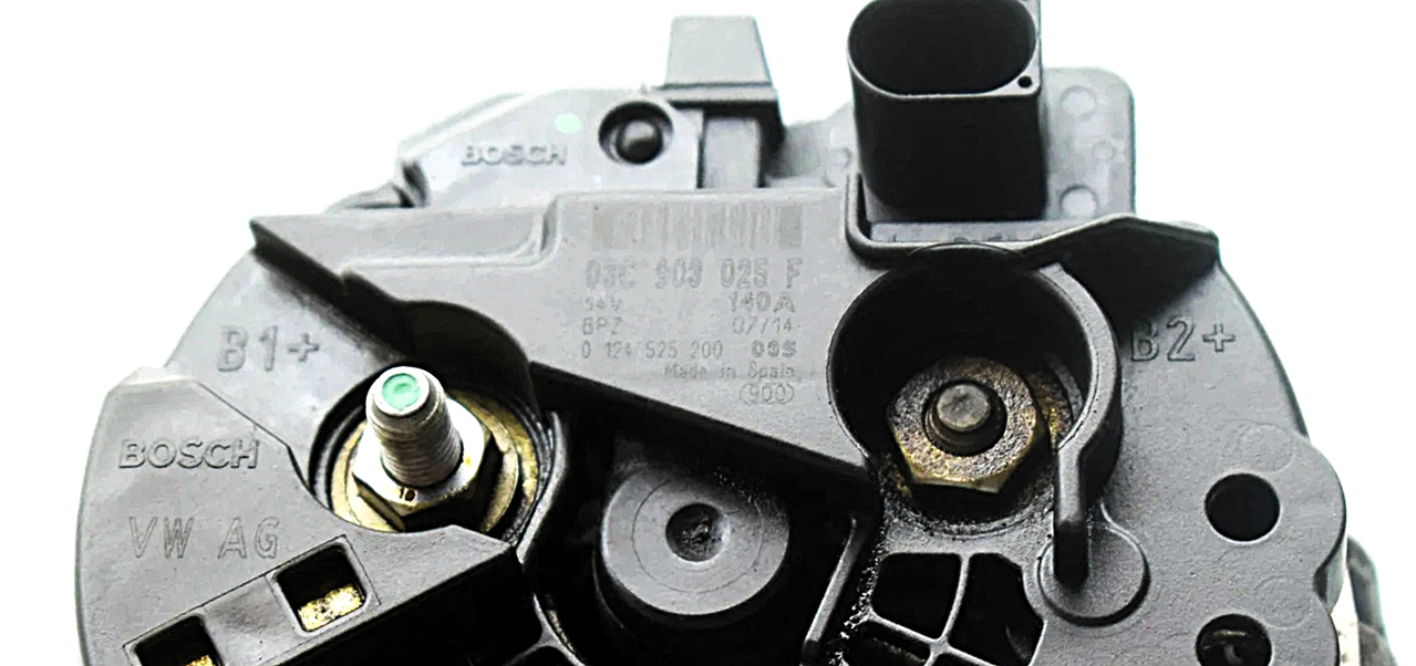

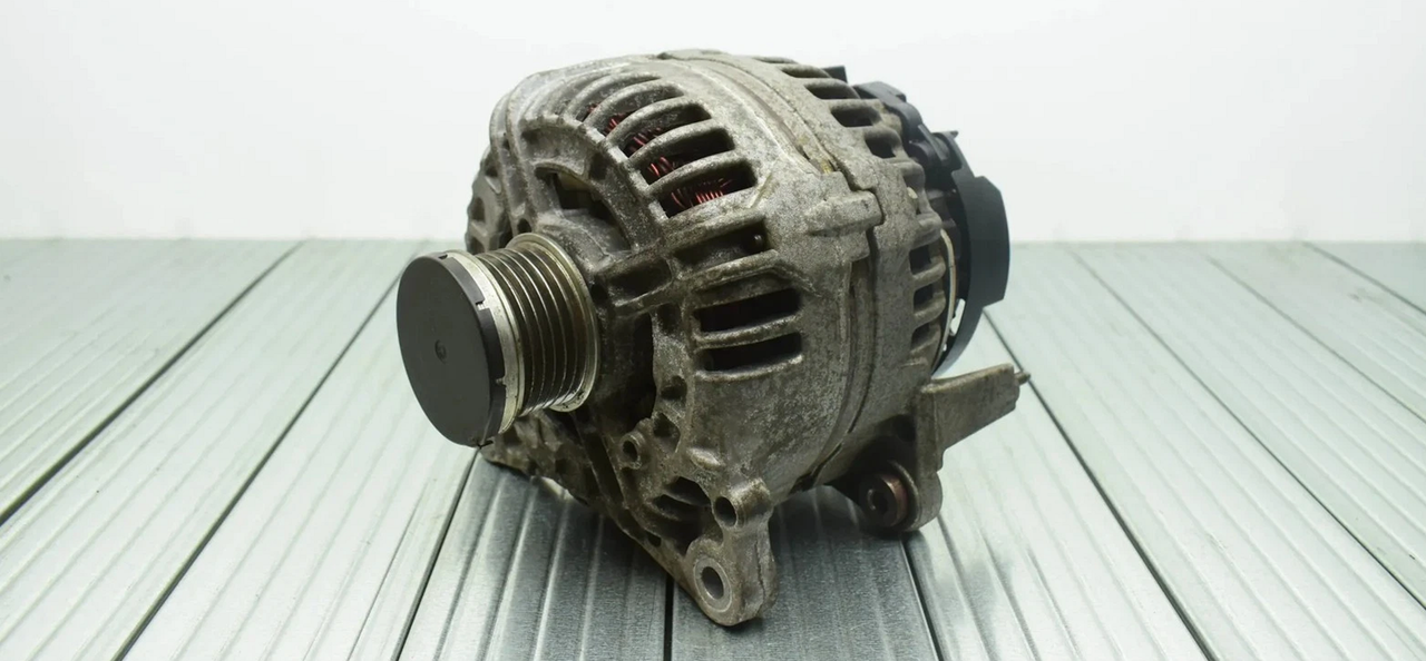

I bought this 'nice' 140A alternator on eBay.
Honestly, it was the cheapest and least repulsive/disgusting one. :)
According to the seller, it has 97,000 km. I have to receive it, clean it, inspect it, and if the essential parts are within tolerances, I'll replace the freewheel pulley and the voltage regulator (LIN).
The average lifespan of these alternators is around 200,000 km (25,000 +/-). It can be extended noticeably by replacing some easily replaceable parts.

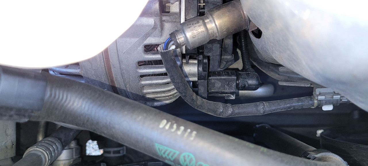

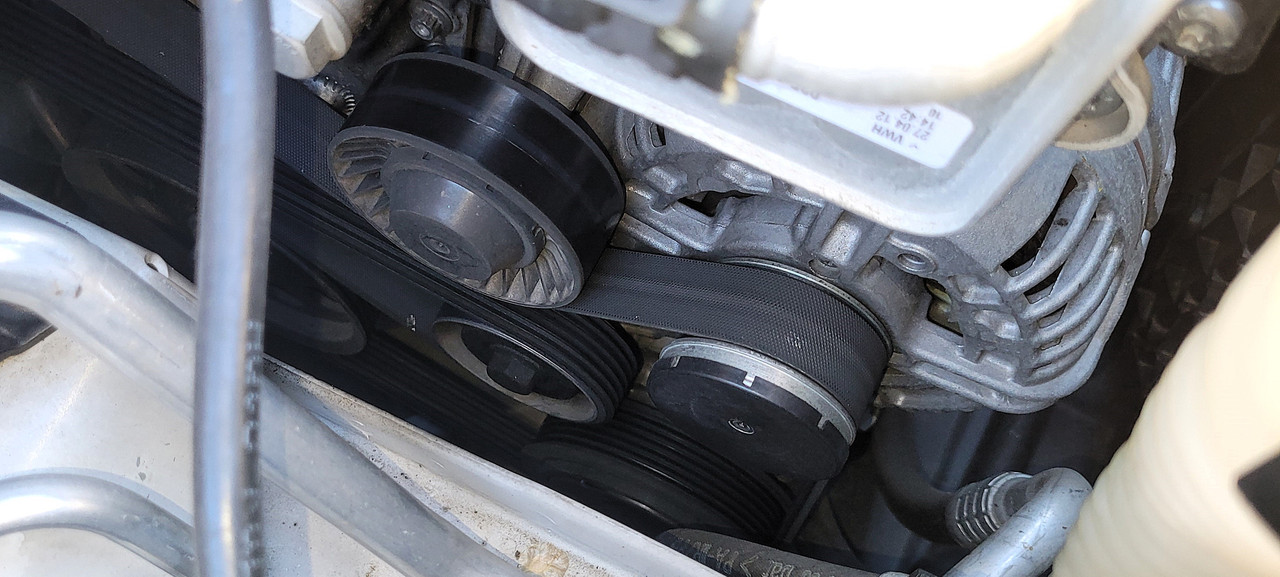

My current/factory 140A alternator.
It works perfectly (PWM - DF). 100,000 km.
This is a project I left unfinished because I decided I wasn't willing to replace the factory alternator at the time.

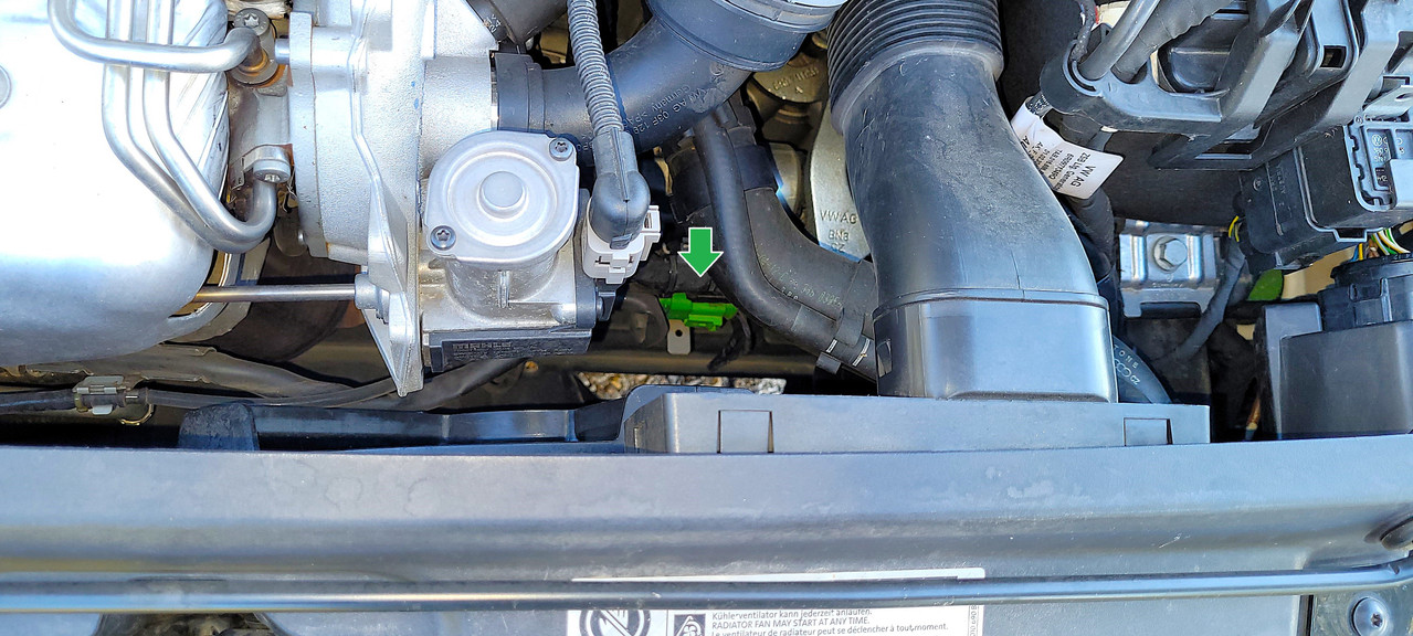

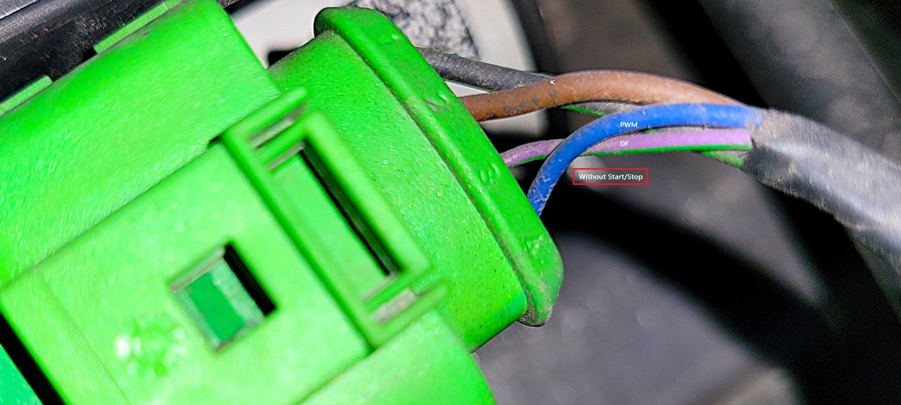

Some NOTES on the diagrams. Start/Stop vs no Start/Stop.
Click on the image and download if you are interested in enlarging the image.
...the green T4 connector (the key).
Note:
This connector may be different on other models.🤷‍♂️

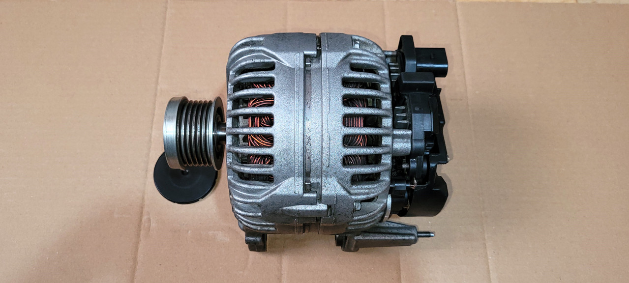

UPD: Second-hand Smart alternator received!🤸‍♂️
-As a first observation, when turning the pulley it doesn't make any kind of noise, the rotation is solid, 'smooth', and consistent, so the bearings appear to be in very good condition. Even the freewheel pulley (INA) works, it releases when the shaft is retained.
I think I've been very lucky.😊
It's time to clean, disassemble and check the condition of the copper slip rings (tolerances), etc.

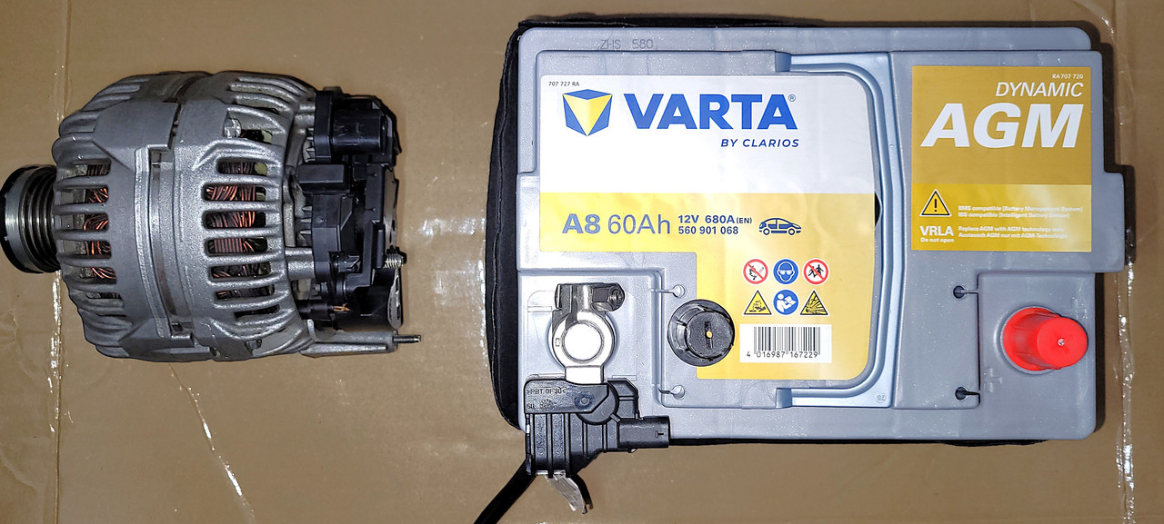

...this is the AGM battery I'll be installing.
PowerFrame® Grid technology, by Clarios.✅
OEM: 4P0915089B (000915105CB 000915089BB 6R0915105A)
A relative bought it due to poor advice from a Norauto center 🤷‍♂️, the car in question really needed at least a 95Ah battery. Related: :arrow: viewtopic.php?p=609919#p609919
Once I sorted things out —a nice, albeit laborious, task— this AGM was given to me and became part of the collection of batteries I keep in the garage storage room (only two 😁, the EFB and this AGM).
This was the catalyst before starting this new project.

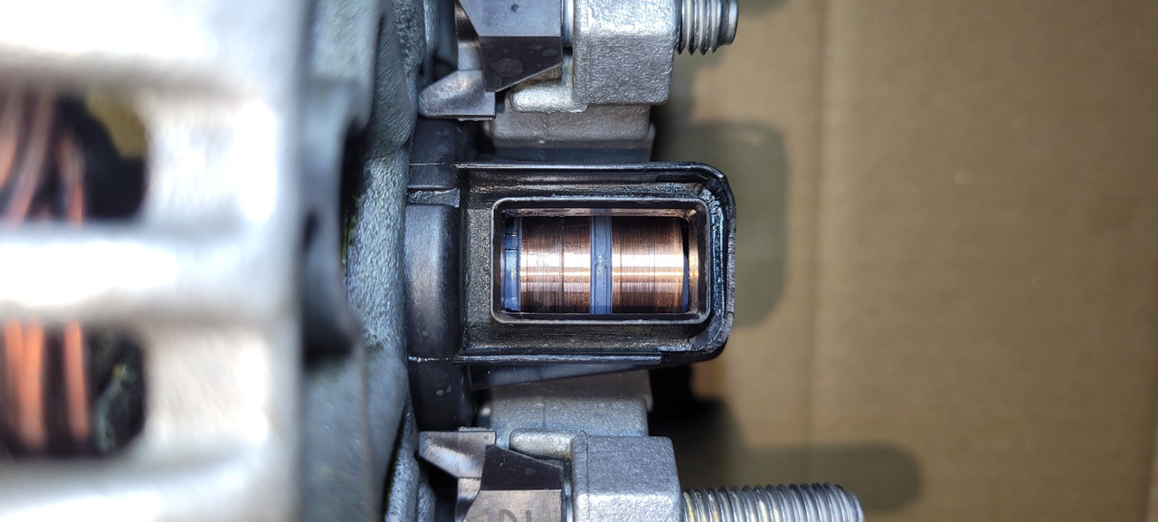

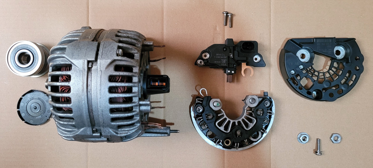

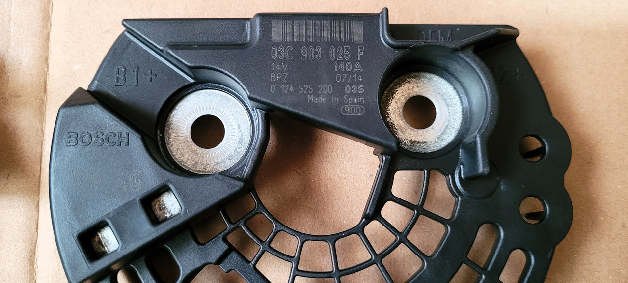

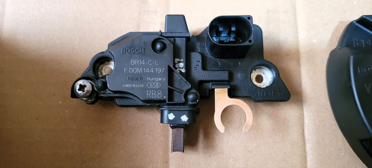

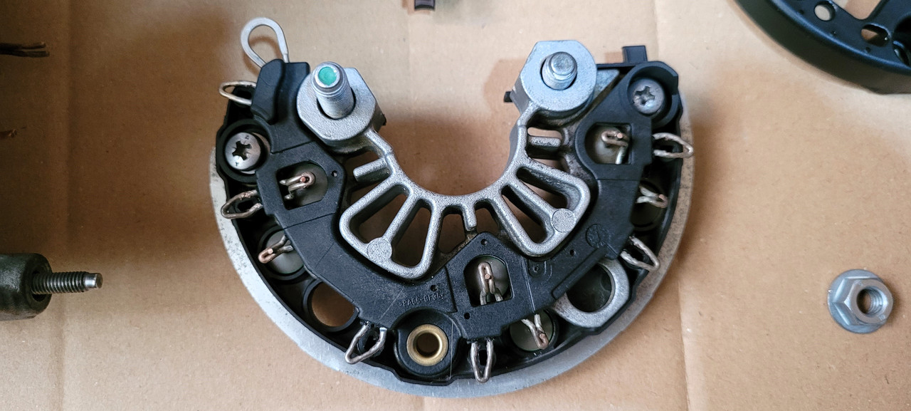

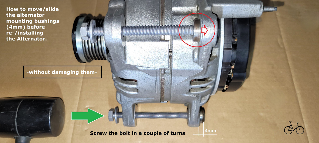

Results of the cleaning and inspection of the LIN Alternator before starting the new project. :lol:
Home inspection:🧐
- Brushes 11mm, longer than 5 mm. I will not replace the voltage regulator as the brushes are in very good condition. (new brushes ~15mm)
- Grooves in copper slip rings = 0.13mm deep (Tolerance = <0.5mm), without appreciable eccentricity. Rotor not short-circuited.
- Low coil resistance. No short circuits or visible damage to stator.
- Correct conductivity of rectifier plate diodes (3+3).
- Balanced shaft, without vibrations or unusual movements. Silent bearings. Smooth and solid rotation.

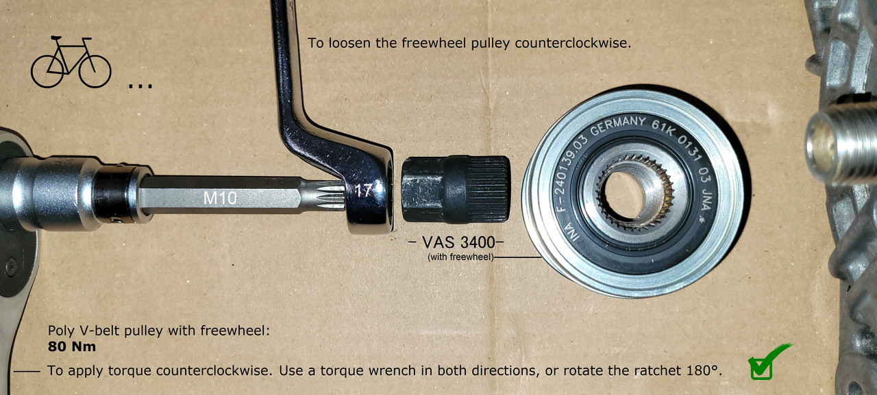

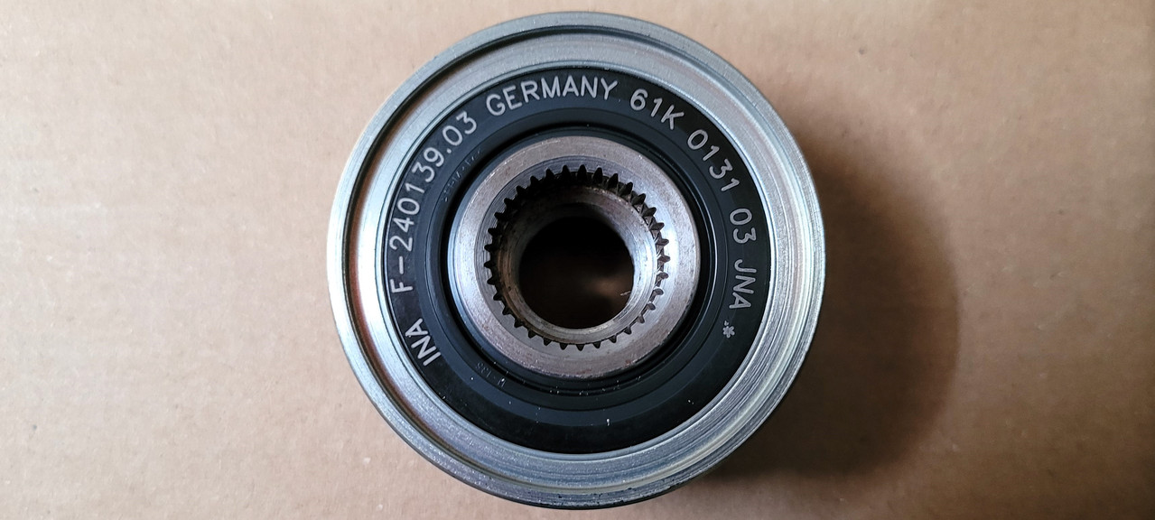

- Freewheel pulley is functional, but will be replaced.
Now I have to wait for the alternator pulley, idler pulley, tensioner pulley, and poly V-belt to arrive.
I assume a week, although I'm really looking forward to starting this new project.
I'll replace the 'water' pump when I change the G12evo coolant again. The current coolant pump isn't showing any signs of failure.
Items parked in the room. I'll be looking at them with some fondness during the week of waiting.

Re: ciclo's Polo. R-line 1.2 TSI 90hp 119gr.🤝
Genu-INA. Autodoc.

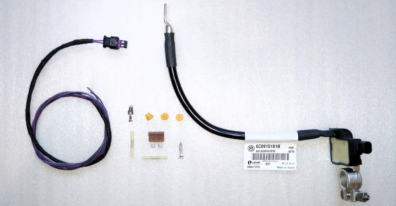

New Battery Monitor.
The most refined/debugged battery monitor software for the Polo 6R/6C and other PQ25/26 models is HW10 SW 9070.
I have version 6C0915181B, with HW08 and SW 0270, but I'm also going to test version 6C0915181D HW10 SW 9070 for my PQ25 Max4 H84 0772 BCM/GW and SIMOS10.22AH10 5466 ECU.
This refined software was widely used in many VW Group models before the new regulations ('evo', 'unece', etc.).
