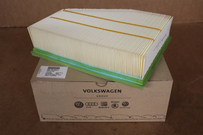

New mod:
Seat Ibiza / A1 2.0 TDI CFHD air filter box
6R0129601J 6R0129607G 6R0129620C
Plug and play, I just had to move the vacuum lines to the N75 valve a little bit.
Re: iichels Polo 6R 1.6TDI DSG Bluemotion --> OEM++ R-Line conversion
Does it use a panel filter?
I would advise you to keep to oem style air filter. Darkside says that aftermaket filter damages the turbine of the turbo
Yes, OEM filter 6R0129620C
Cleaned up the vacuum lines a bit more, and installed 2.0 TDI air mass meter 03L906461A
Still need a 6R0129618E
