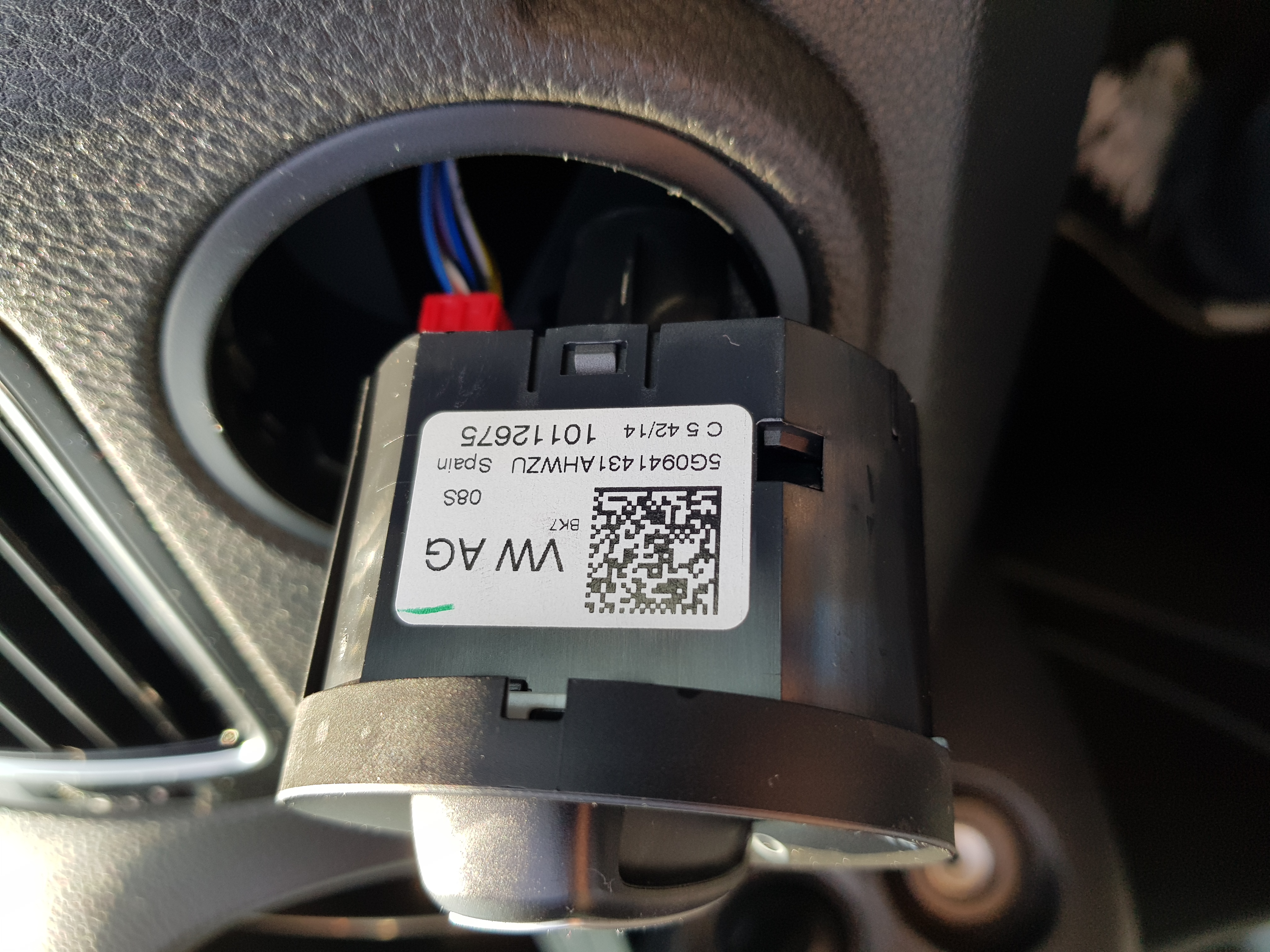

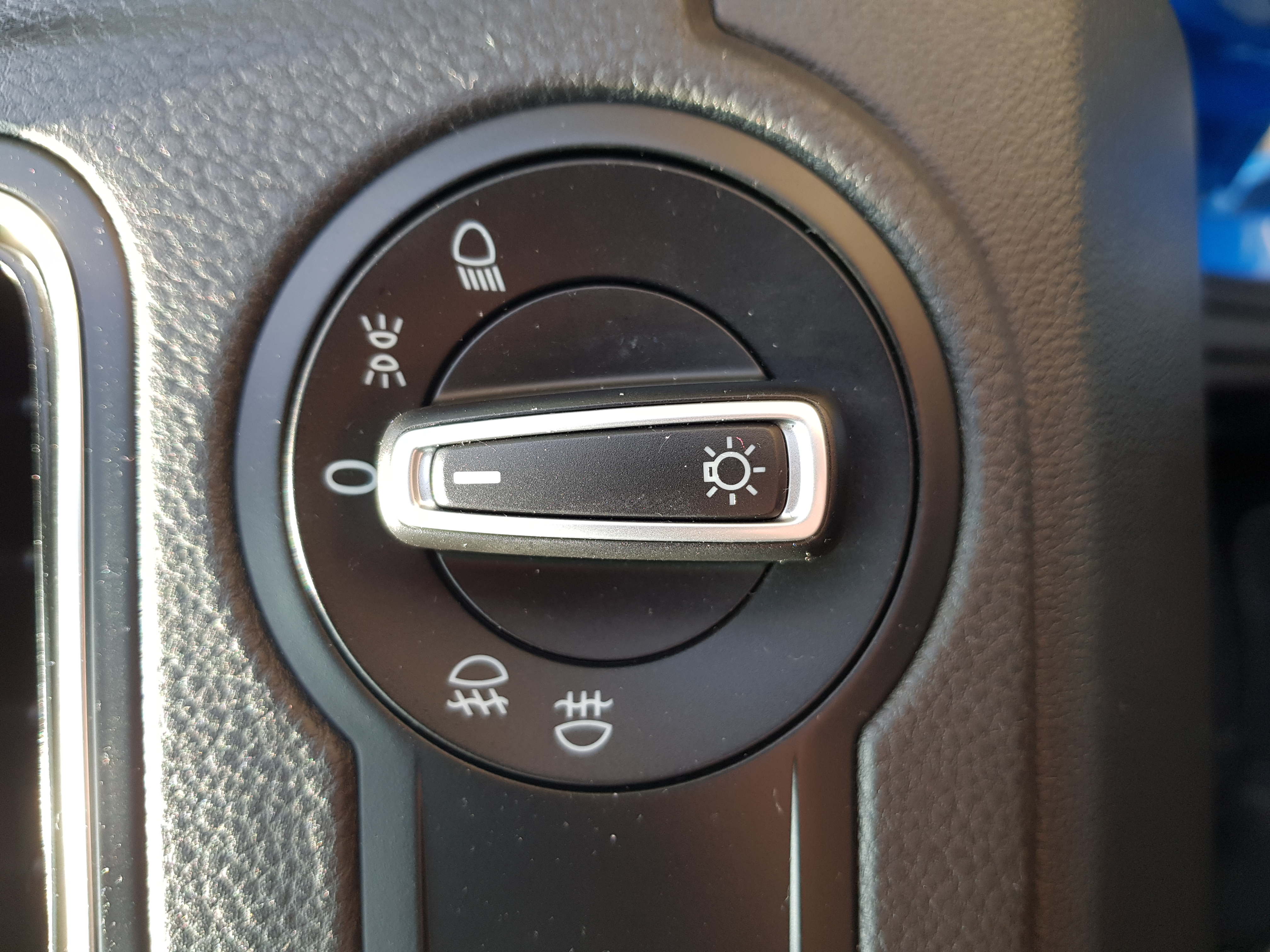

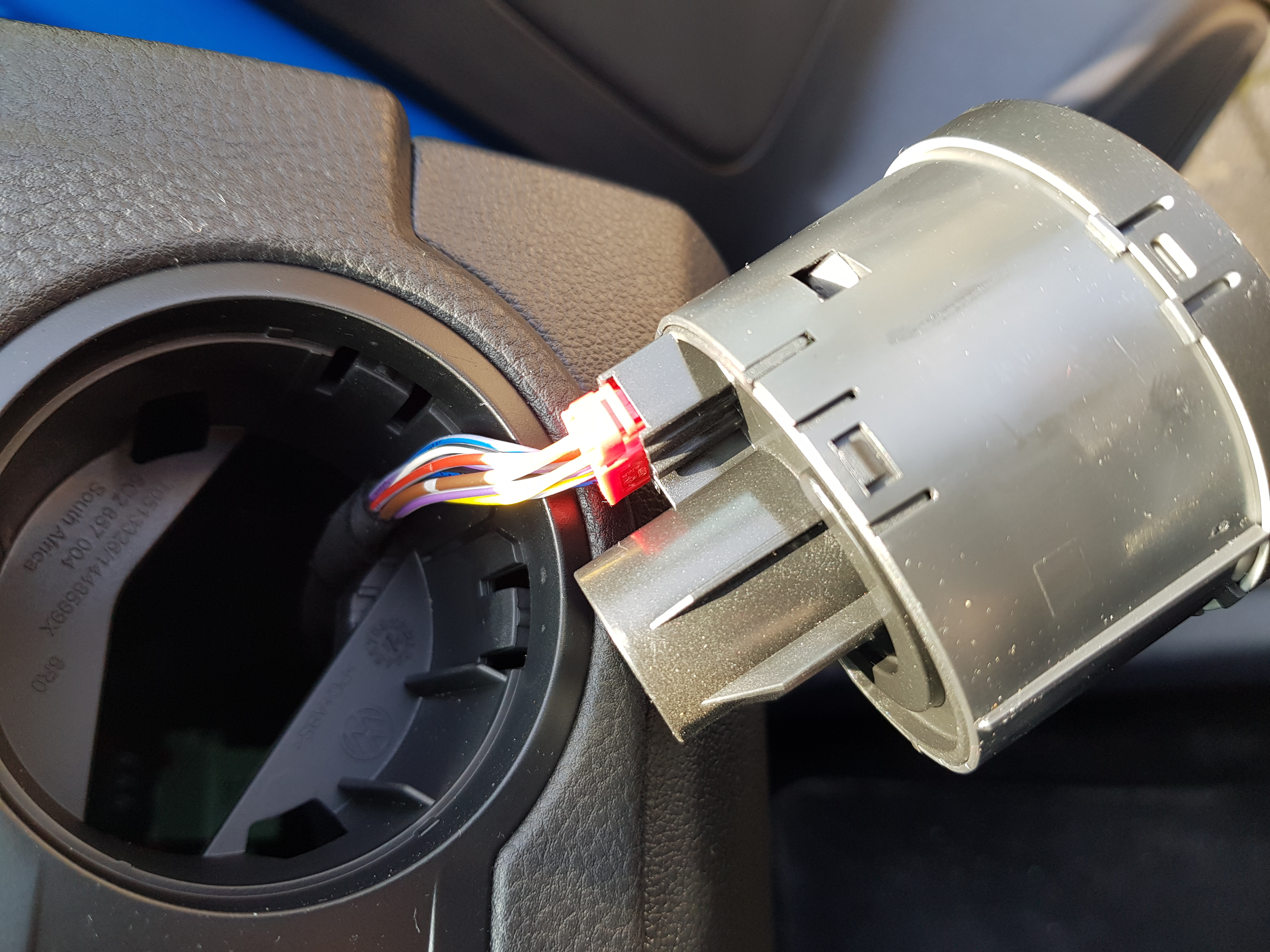

Hello, I have a 6c fitted with the light/rain sensor but no auto lights switch. I’m wondering if I can simply replace the switch for one with ‘auto’ position and update through Carista to have coming leaving home lights? Or is it more complicated? (i.e - replacing any wiring and what not).

You may need to add a wire from the light switch connector to the BCM. Check slot 2 of the light switch connector.
https://i62.servimg.com/u/f62/18/94/39/39/sin_ty21.png
You need a New 6C light switch with Auto function. (6C light switch, very important)
After that, the BCM coding for automatic lights. I do not know how to carry out this coding in a 6C, but I suppose it will be similar to how it is done in a Golf 7.

Thank you for replying! I acknowledge that I need the 6c light switch, I thought that because I already have the oem sensor its just a plug and play deal. When I'll have time I will further investigate on this. By the way - Does the new tiguan/ golf light switch will fit the 6c? Visually they're the same.

No. For the 6C you'll need the Polo 6C auto headlight switch (red illumination). Don't get the one from Golf 7, Golf 6, whatever. Polo 6C only.
Furthermore you must have the RLS installed in the front windshield, it often comes together with the auto breakaway interior mirror.
With VCDS, do the following:
09 Central Electrics
16 Security Access: 31347
Adaptations:
IDE04926-ENG116601-Komfortbeleuchtung-Coming Home Verbaustatus,automatisch
IDE04926-ENG116604-Komfortbeleuchtung-Coming-home Einschaltereignis,Driver door
IDE04926-ENG116605-Komfortbeleuchtung-Helligkeitsschwelle Infrarot-Messung,72.0
