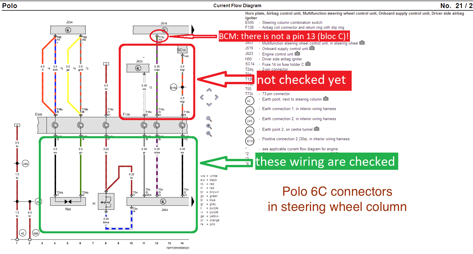

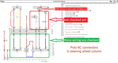

I already found a diagram here in the forum for "polo 6c connectors in steering wheel column"
the model I chose does not contain cruise control can my BCM support multifunction keys even without cruise control?

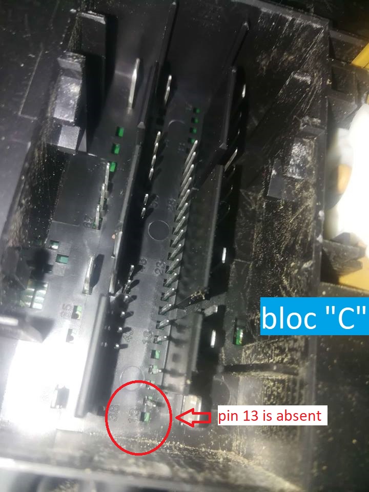

I suppose you could start wiring running a wire from pin 3 of the 16-pin connector on the steering wheel to T73c/13 (LIN) and a power wire form pin 4 to fuse SC14 (or another permanent 12V fused slot in the fuse box)
I'm afraid you'll need to replace the BCM, this is not something you can do yourself since the Polo 6C had the gateway in the BCM, and the gateway is subject to component protection. This needs to be done by a VW dealer.

I think, als long as your BCM doesn't have the T73c/13 pin, there's hardly any chance for this mod to work.

After verifying the connector of slip ring I have found four wires (photo) Pin number 02 is not white like scheme, is there another one for my car (trend) or is it a common scheme for all finishes?
Can I add juste the pin n°4 (12v)?

no, you need to check if pin 13 of block C is present.
if not, choose to stop the mod or replace the BCM (I don't know how to do this).
after changing BCM:
add pin 4 (12V), pin 3 (LIN to BCM) and do the coding for MFSW.
after changing BCM:

What about pin n°2 (white) / the mine is brown with black?
- Posts: 6387
Re: Retrofit "MFSW" for POLO 6C, 2015 [help]
it's for cruise control (GRA), but your steering wheel doesn't have it so you can ignore it.
