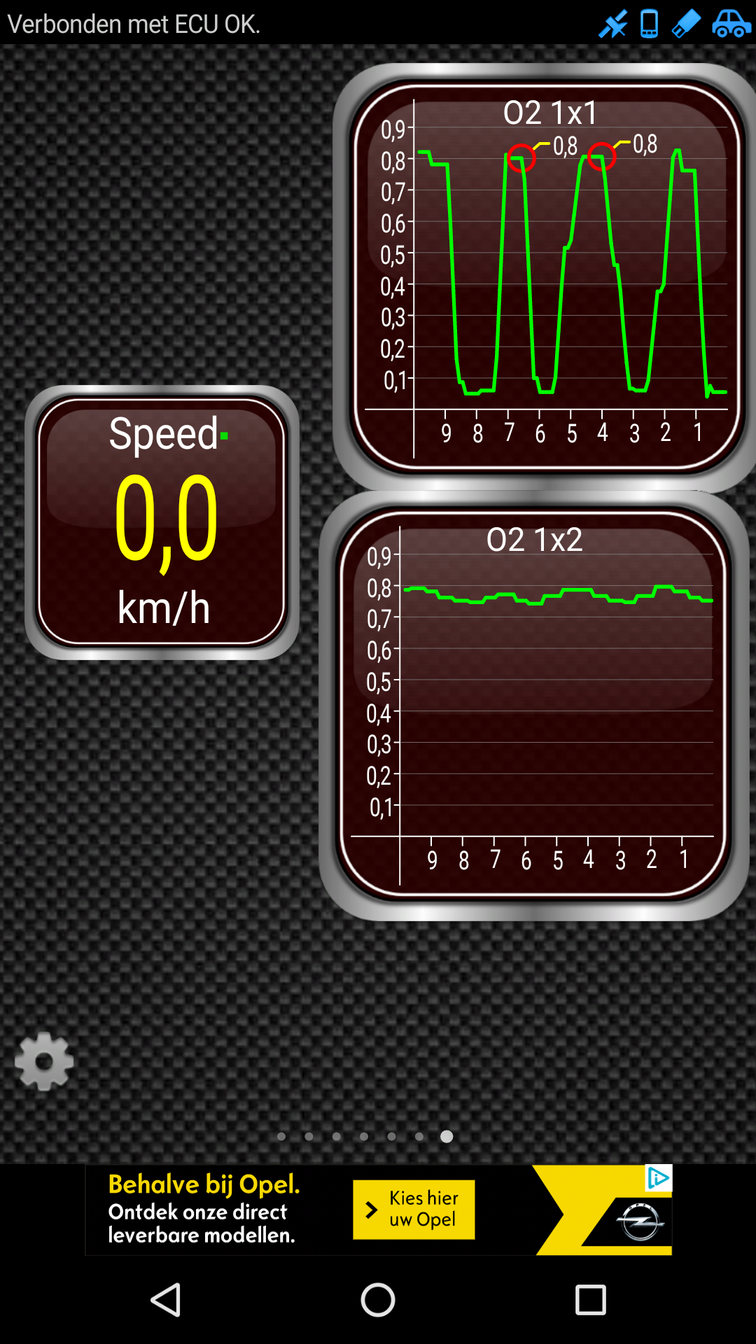

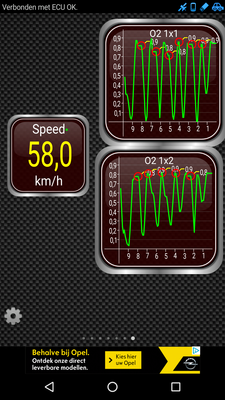

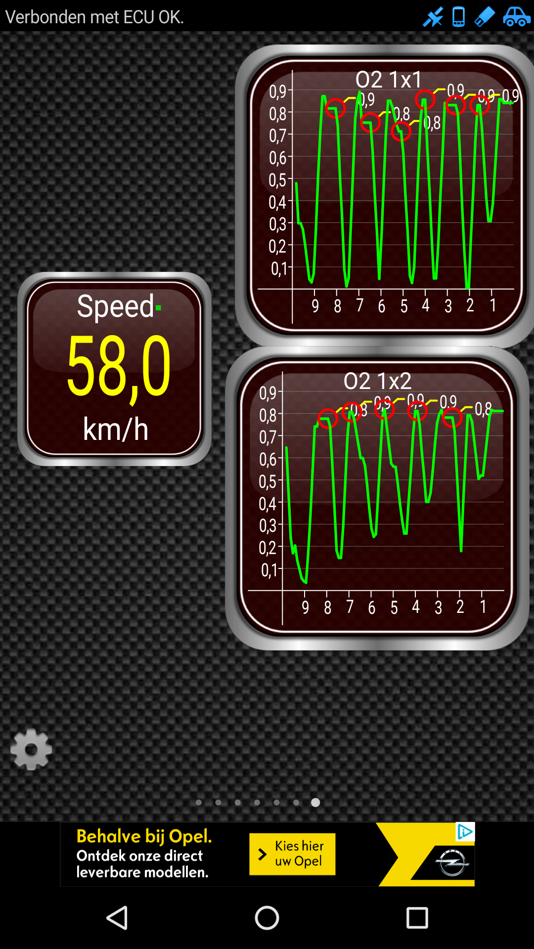

Yesterday I went to a VAG specialist with the car. He connected a diagnostics tool and did the following measurements:
On idle, lambda probe 1 (before catalytic converter) is switching like it should between 0.1 and 0.9V and lambda probe 2 (behind catalytic converter) has a static output voltage of 0.75V. This is all like it should. (See Screenshot idle)
With the engine at 2000 rpm, lambda probe 1 is switching like it should, and lambda probe 2 is doing exactly the same as probe 1. Thus telling us that the catalytic converter is not working properly. (See screenshot 2000 rpm)
Then the VAG specialist took the following conclusion:
The catalytic converter is probably worn out and cannot convert/handle the extra exhaust gasses compared to idle. The ECU is measuring on lambda probe 2 that the exhaust mixture after the catalytic converter is not OK and is trying to make a better mixture by injecting less fuel. Lambda probe 1 is measuring that there is not enough fuel in the mixture and is setting the 'P0171 - System too lean' trouble code.
The solution would be to replace the worn out catalytic converter .
What do you guys think about this diagnosis ? Thanks!

- Posts: 6385
Re: P0171 Fuel Trim too Lean
Makes sense to me.
- Posts: 419
- Joined: Fri Oct 09, 2015 4:46 pm
- Drives: Polo '14 6R, Golf 07' Edition 30
- Location: NI
Yep same as iichel, makes sense. Should be alright to get a used one if you want to avoid paying for a new one.
