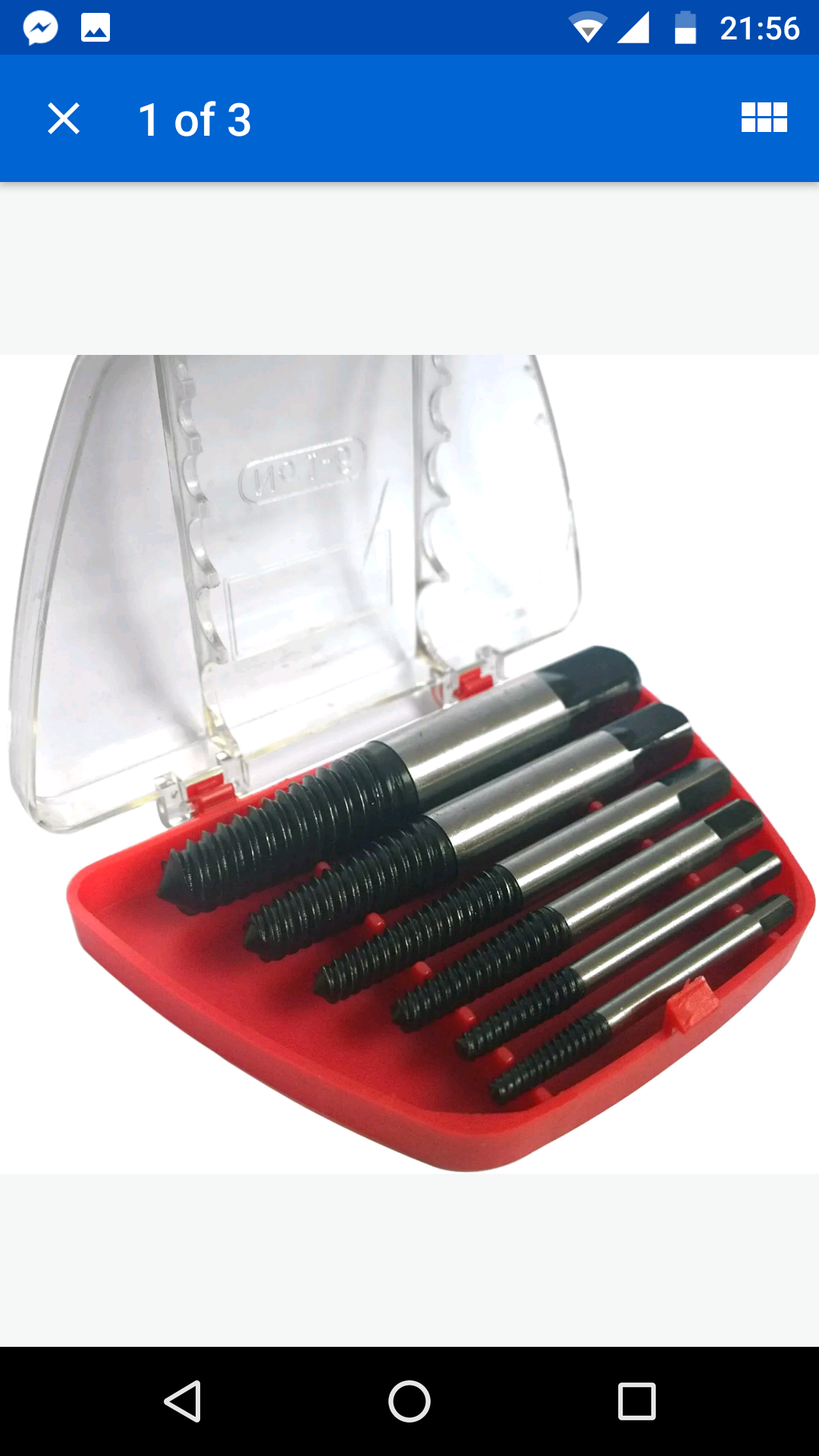

Not much left to grab unfortunately, yeah was gonna get a set of these, reckon they'd do the trick? Got the bolt moving ever so slightly with a little effort but all of a sudden the head went like chocolate... got it soaking in penetrating fluid overnight. Will also need a new bolt, don't suppose you know the size off the top of your head do you mate?

They will but be sure to buy a decent set. Cheap ones much very easily. They are designed to be hand extracted too with a handle and not a drill

Extractors, the proper ones tend to be "ezyouts" and are tapered with 4 faces and get taped/hit into place, personally if buying a set of these "reverse" threaded ones, I'd aim to buy Dormier as, as Alex hinted at, ending up with a broken end of a cheap but hard extractor in that hole is only going to add to your troubles.
Also make sure that you can find out the correct drill size for use with these extractors, using either too small or too big size of drill is not good, good luck.
