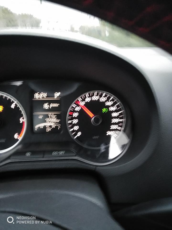

hi guys, at the end I checked the connector of the ECU, check the cable of the cruise and actually the mqs is not stuck. pull the cable to let out the mqs, salt to 3/4 of the race coming out halfway from the outside, I try to get it out pulling it with a pliers but .... the mqs breaks in two parts !!! I try in all ways but that half does not decide to go out .... in the end I also do the damage by breaking the red-white cable near the cruise, I decide to do things right and disassembly all the connector. the divine in the 3 parts, cut the red rubber to insert the cables to the side, repair the red-white cable with sheath + solding and that of the cruise with a new mqs inserting it directly into the lower half (the connector is nice long!), I do leave the car and everything seems to work, I go on the road cruise switch on, 30km / h but nothing comes on! then I remember someone said that it worked only after 40km / h, so I try again and .... tadan!
(photo like takumi)
thanks to everyone especially ciclo :D

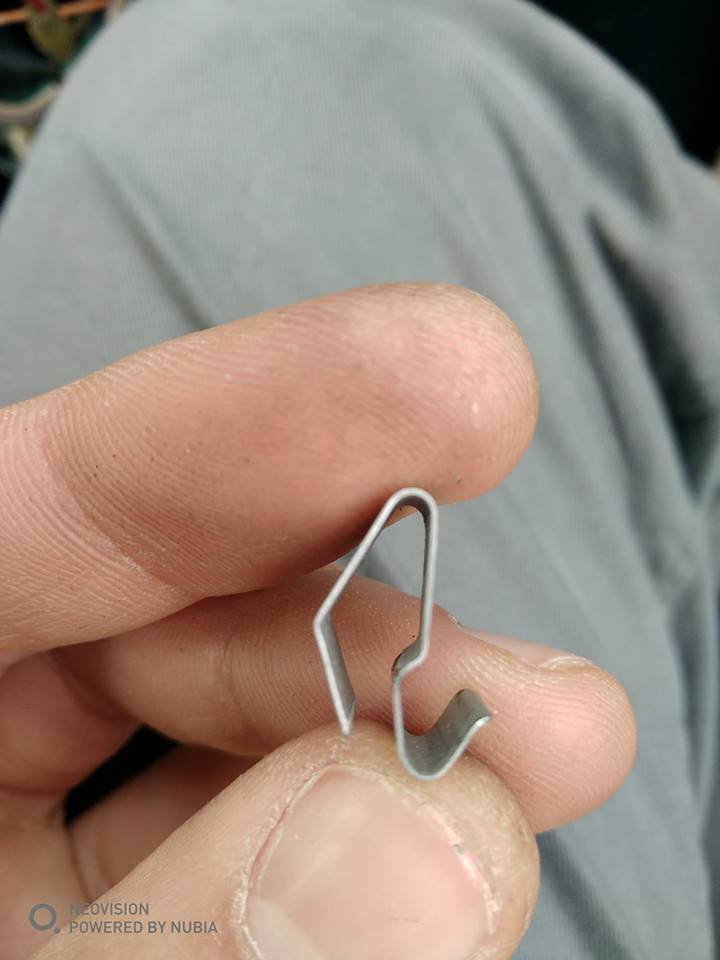

OT:
where to find these hooks (the tongue has broken on the left), also the other black in plastic of the driver side sill, only in vw? thx

Luigid wrote: Fri Dec 07, 2018 8:52 pm where to find these hooks (the tongue has broken on the left), also the other black in plastic of the driver side sill, only in vw? thx
You can buy them on eBay, etc... or at your VW dealer.

hello ciclo , the problem is that I had them in fact the mqs had unhooked, the problem was at the beginning of the connector, thanks for the code :D
