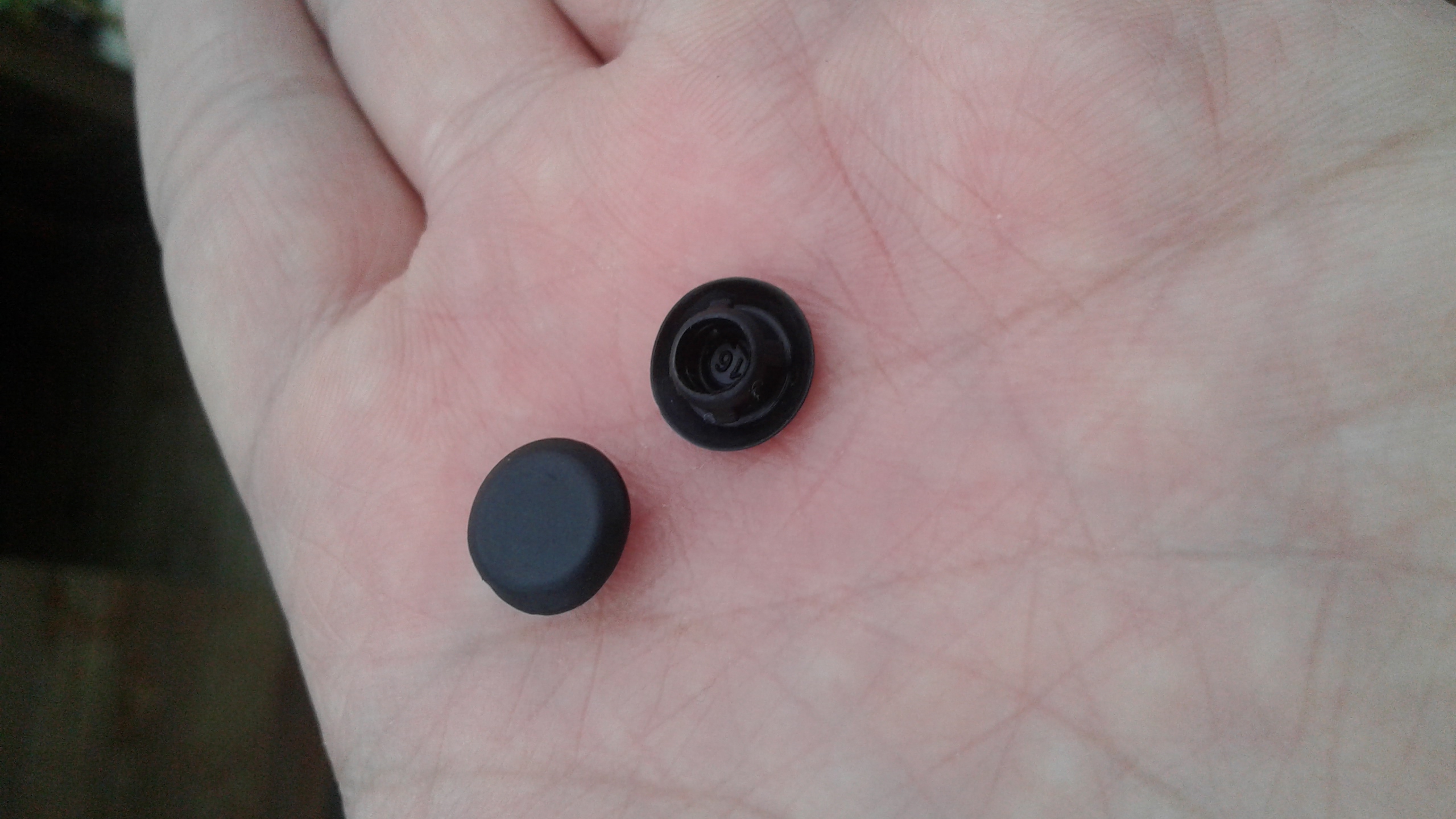

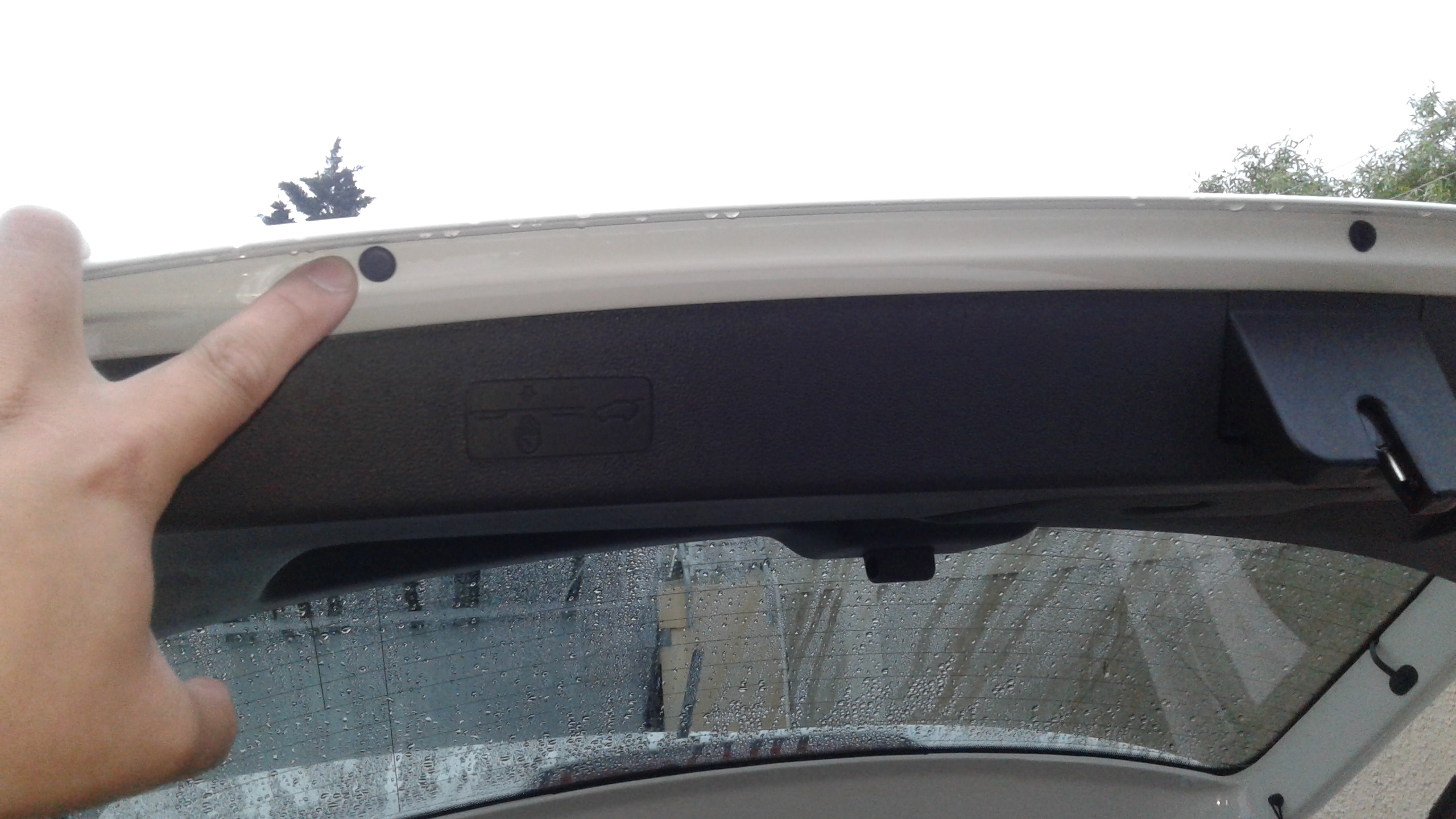

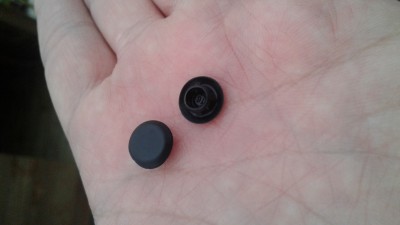

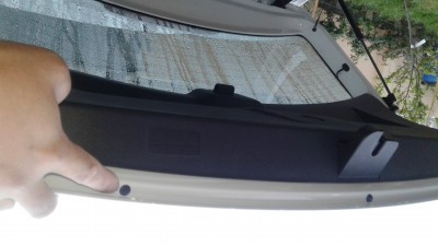

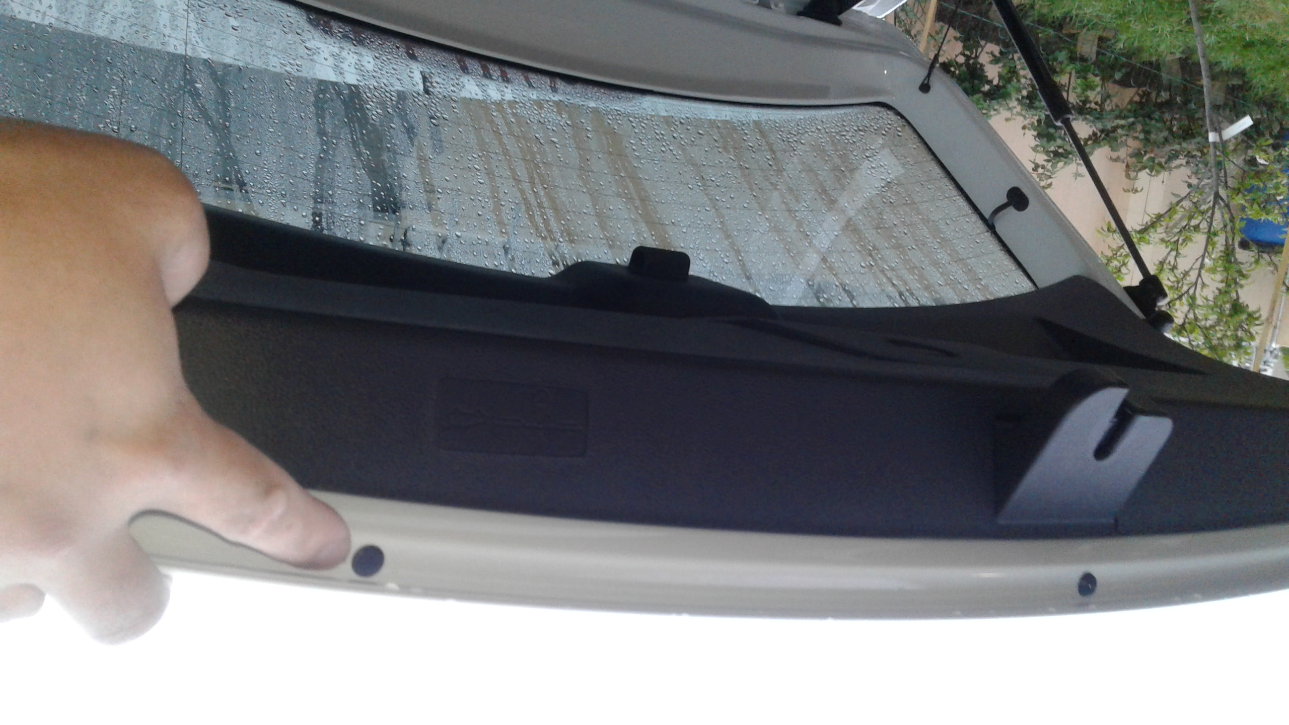

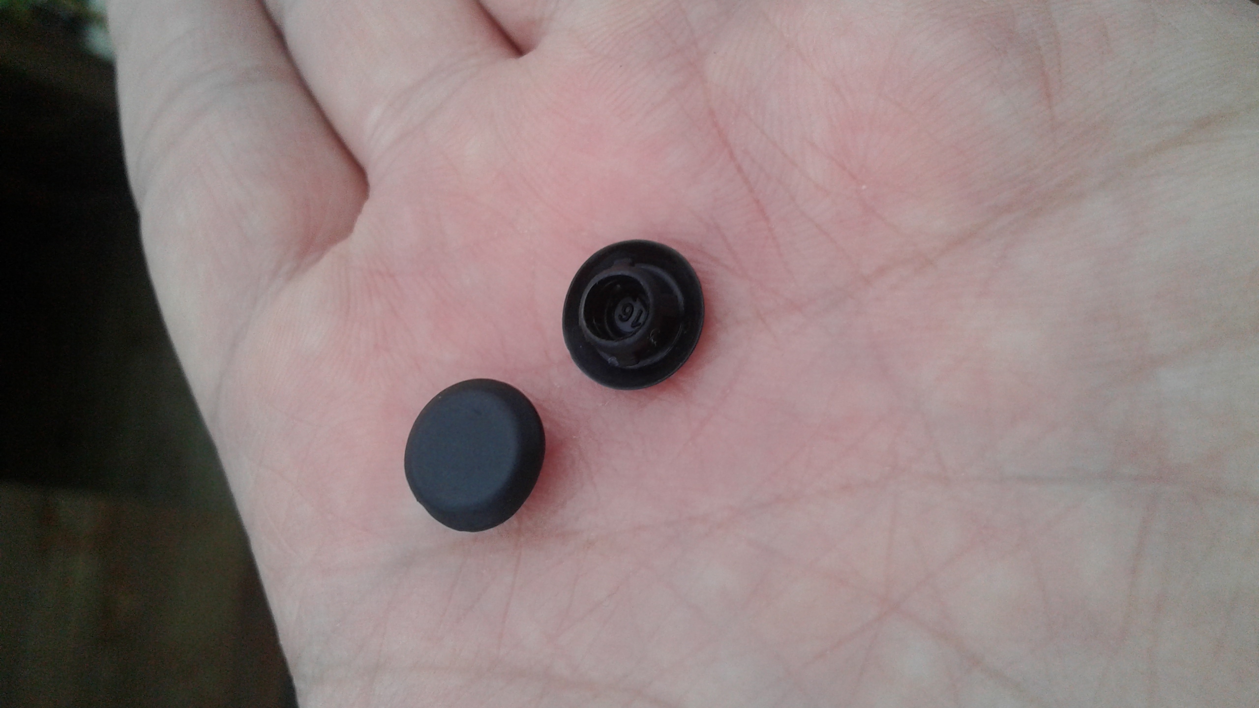

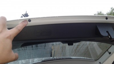

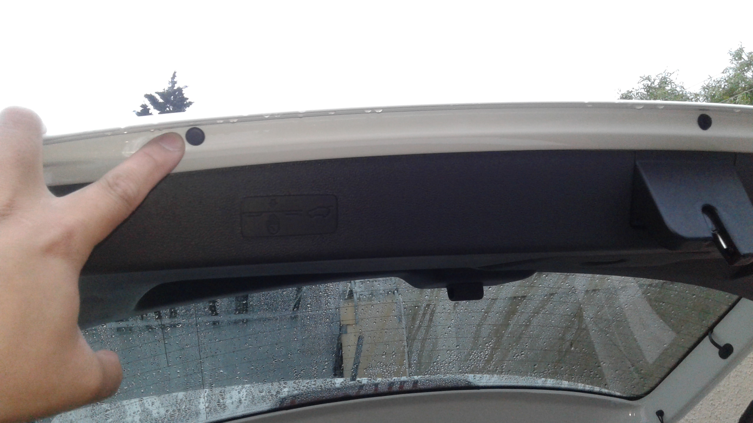

Hello all,
I found these small plastic plugs plugged into the left and right hand side holes of the tailgate.
From my understanding, those two holes are for water to leave the tailgate, and if they are blocked by a plug how would water leave the tailgate...
My question is, are those plugs suppose to be there or the production line forgot to removal them before shipping the car out?
Can you please kindly help and check if your Polo also have those plugs at the tailgate or not. :oops: Thanks.

Like yourselves, my first reaction was that these rubber or plastic grommets are covering holes that are probably water-drainage holes. But could the holes more likely be for wax-injection, performed during the final stages of the production of the vehicle? It would then make sense to thereafter block them off with grommets.
Blanking off holes in car bodywork is often done to prevent wax that has been injected into various cavities, cills, and box-sections from later running out through the holes. Such waxes normally set fairly hard but have the potential for melting, and therefore running out, in very hot weather.
I'm not saying this is the answer to your observation but am suggesting it as a possibility.

I think the centre grommet with the hole is meant to be like that, assuming this design is the same as the mk7 Golf which also has this centre grommet with a hole in it.
On the Golf, there’s a thin hollow tube inside the tailgate that’s attached to this grommet - the other end of the tube is (I think) attached to the bottom / underside of the tailgate badge/ handle inside the tailgate cavity. The tube is there to drain any water that can collect in the recess behind the badge on the tailgate handle when it rains or from washing the car - the water runs down the tube and out through the grommet.

You are correct :-) also my polo build at spain have both of gromets on sides. Guess it is normal

Got a reply from VW, they say those two holes are for liquid drainage during the Anti-Corrosion Galvanizing process in the production line.
So, in a normal day to day operation we only need the middle hole for water drainage. :?

As I said in my own response to this topic, I suspected there being a strong possibility that the holes were for wax-injection or similar, at time of production. So it seems that my hunch about that was correct. The tailgate is, I believe, fairly well protected against the weather, maybe the only likely entry of water being via the badge, so I guess that's why they leave one of the holes unbunged, just to let the water or moisture out in the event of it getting inside.
