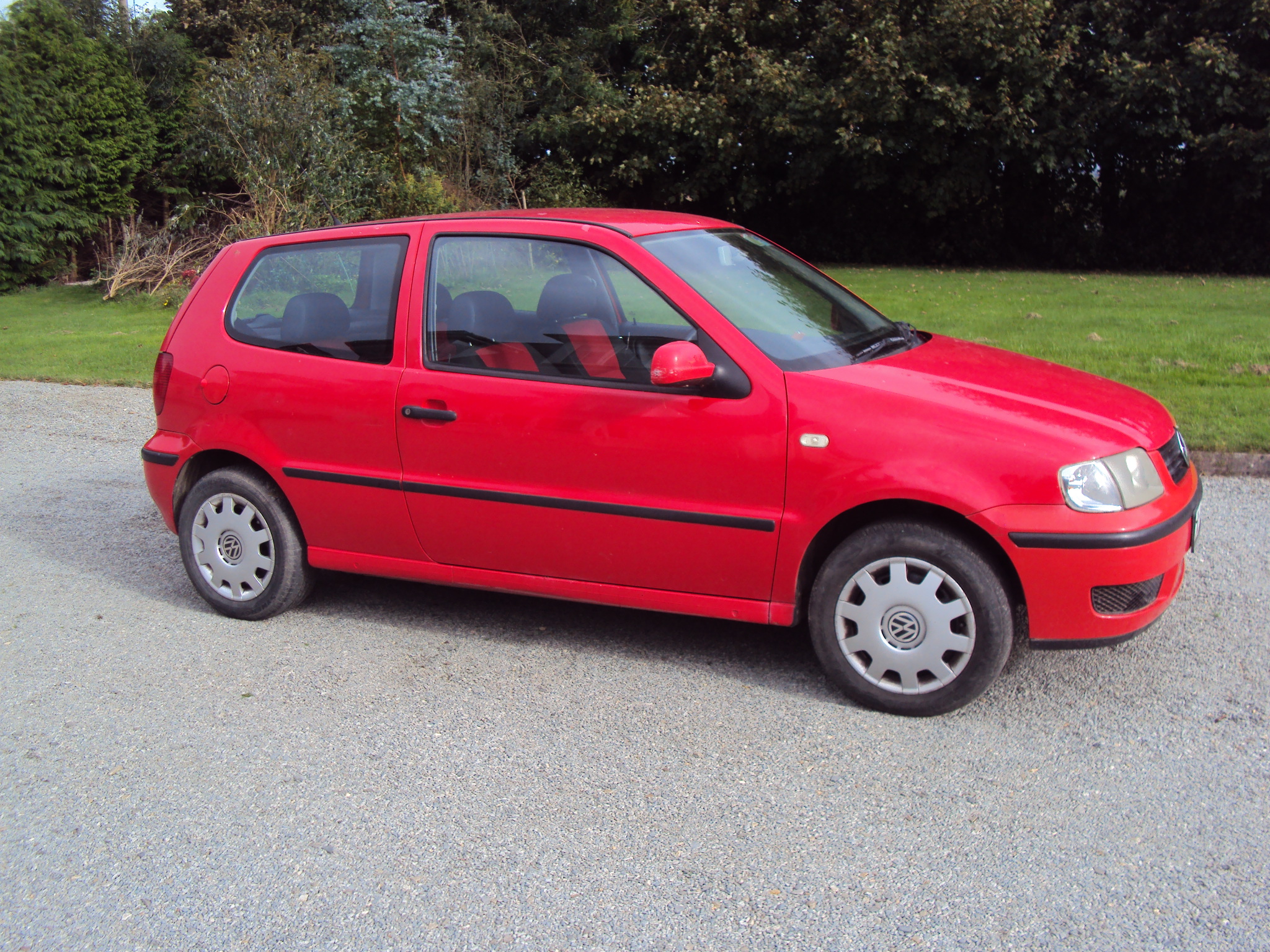

I have a 2000 1.0 3dr Polo as a spare car for the last three years, It's a fun little car and gets us to work when the BM doesn't want to.
It cost 85 Euro three years ago, which will give you an idea of the cars condition but has no body rust. Now it is getting some TLC.
The handling was poor - felt unstable over 50 MPH, It had 10 year old 60 profile tyres - worn shock absorbers and all the usual neglect.
It now has new Hankook tyres 185 55 14 - new kyb shocks all round new bushes and ball joints.
I am just setting the camber, centering the rack and then the toe, however while googling I came across some posts about the ball joints being swapped over for 14" wheels. I do not know if our polo came with 14" wheels from the factory and would like to get this correct now before I set the alignment.
So for a 1.0 petrol should the ball joints be to the rear of the wishbone for 14" wheels - current set up, or should they be swapped so they are center in the wishbone?
