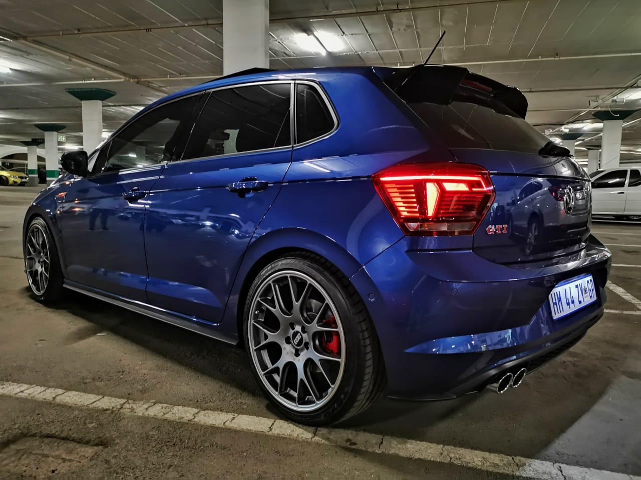

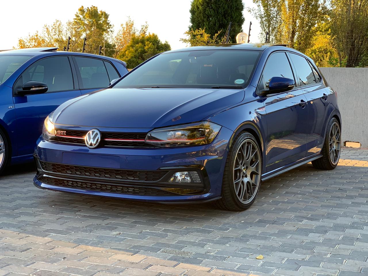

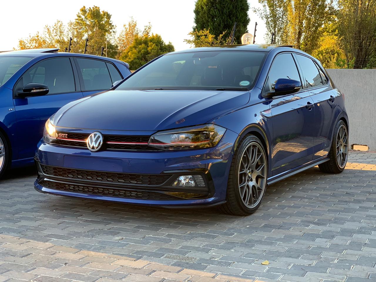

My ex BBS wheels in 18" on the new Polo GTi, fitment was a bit aggressive.IMG-20190316-WA0021.jpgIMG-20190428-WA0055.jpg
Looks very nice. I love the BBS wheels but all the ones that style i see are Golf wheels with PCD 112 rather than 100 like the polo. How did you get them to fit? I have been looking at various things like changing the hubs but would be a big job and void my warranty so would prefer a simple method of wheels with the correct PCD.
Hi. The wheels on the blue Polo are 18" 8j 5x100 et38. These wheels were from my Polo 6C GTi.
BBS make another nice 5x100 18" et36 wheel worth considering, called the SR. I have these fitted on my 6C Polo. Stunning wheel. Fitment maybe a bit aggressive.
