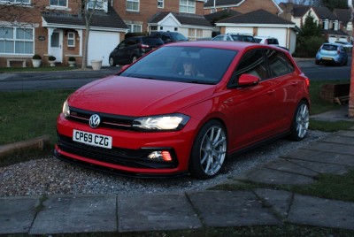

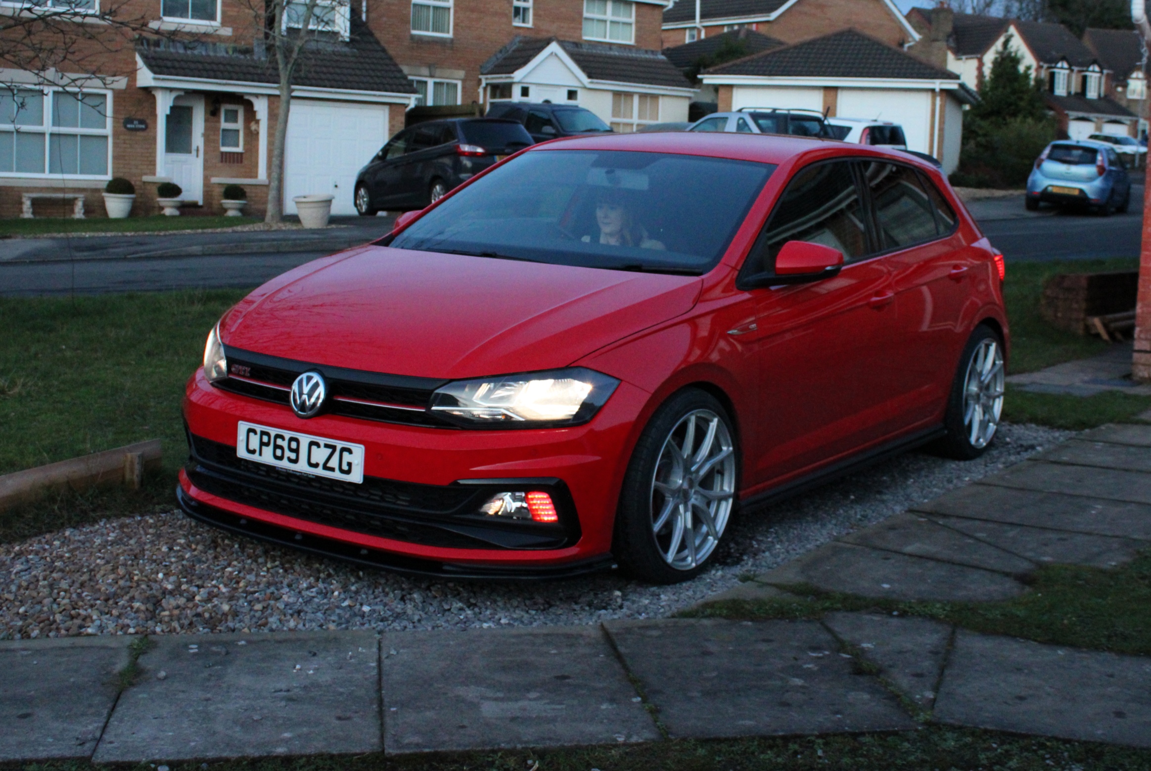

Re: Alloy wheel help
Thanks again for all your help guys, wheels are now on with no problems
That looks good RichTea
Loving the drls.
Are they a different colour LED, or have you put a colour filter on there ?
They look a lot better in person as well. I bought red tint film from ebay and cut them to shape. I also stuck two sheets on top of each other as it looked to pink with just the one
- Posts: 3534
They look good. Which wheels are they and what size and offset did you eventually go for?
As for your coloured front DRL’s; please be careful. If you’re stopped by the police, they may prosecute you as it’s illegal under the Road Vehicle Lighting Regulations 1989 to have front facing red lights, and I wouldn’t want to think a fellow forum member received a ticket / fine for changing the colour of their DRL’s to red. The Regulations actually state;
No vehicle shall be fitted with a lamp which is capable of showing a red light to the front
Whether or not fitting a red filter would be considered the same as fitting a lamp that’s capable of showing a red light is unclear, but I think there’s a fair chance that if you’re stopped and your car has front facing red lights, at the very least you’d be asked to remove the filter there and then.
