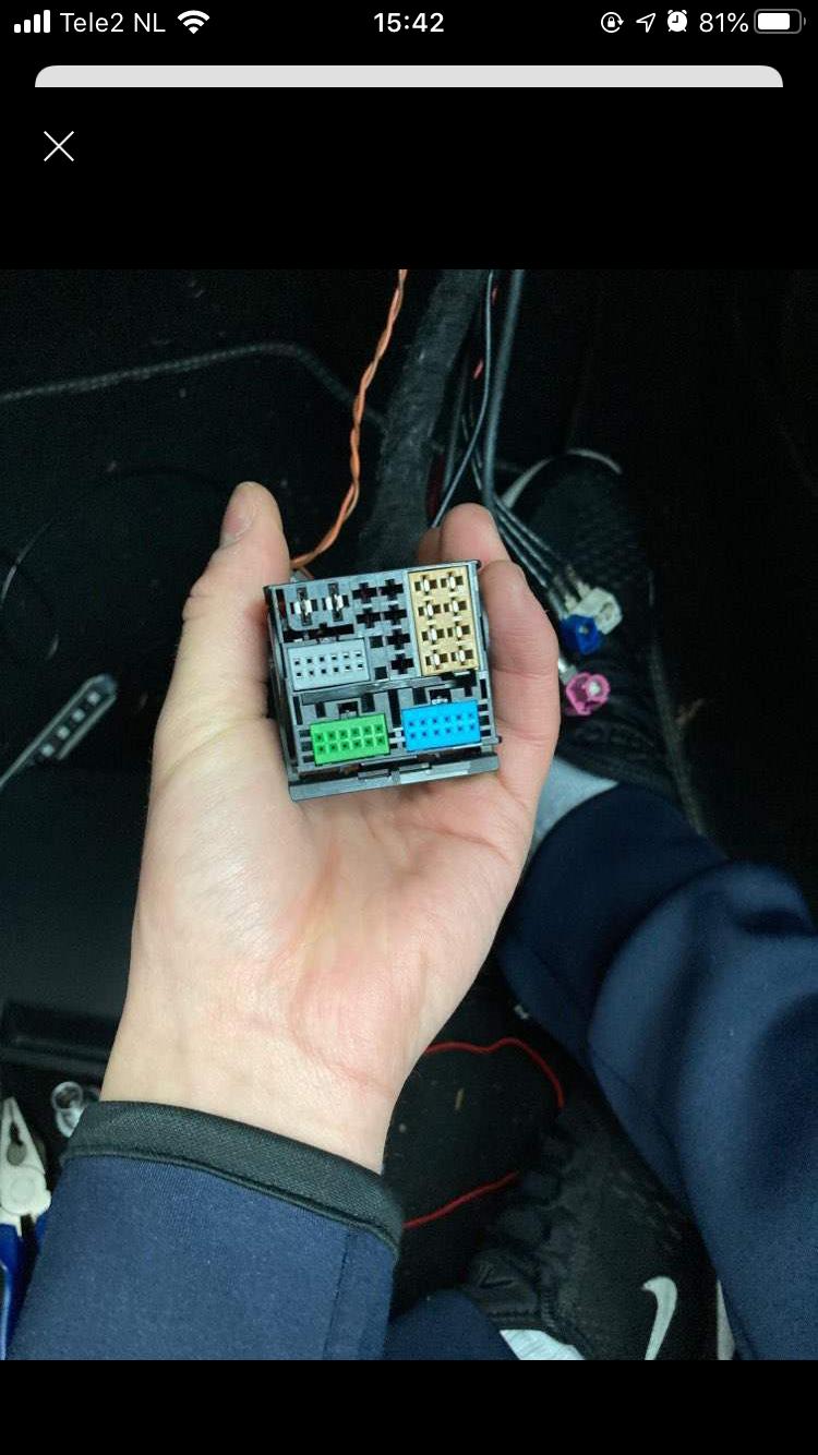

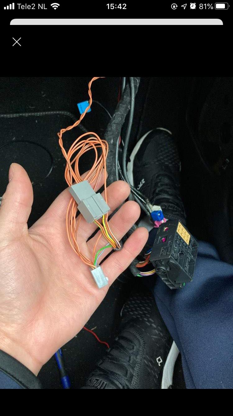

The bit im struggling on so far is the Canbus bit, where is the canbus located to connect those parts to?
Unless Im blind I cant see anything in the Quadlock to attach them too.

You'll have a orange/brown (can low) and orange/green (can high) wire in your quadlock. I think this is what you are looking for.

So
iichel wrote: Tue Jun 02, 2020 6:57 pm You'll have a orange/brown (can low) and orange/green (can high) wire in your quadlock. I think this is what you are looking for.
I’ll take it out again and try get some pictures tomorrow.
But what would I need to do remove those wires from the quad lock ?
Unsure how the two Can Low & High connectors shown in the diagram will fit into the quadlock , as there’s seemingly no space.
Unless I’m missing something obvious excuse my lack of knowledge
Re: Help fitting Reverse Camera with RCD330 - Canbus
You'll have to connect them to the existing wiring (i.e. soldering, clamps, crimping).

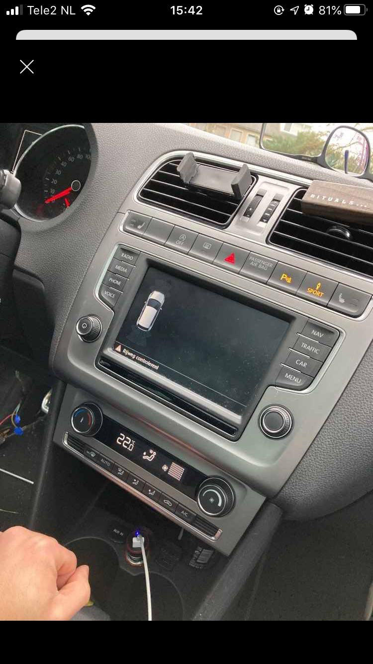

Hello,
I have a problem with this camera, first i have a standard camera without dynamic line and I want to replace it with this camera.
Everything worked included the steering lines, but after a few KM the lines was gone en now I have a black screen and the it said Parkpilot is not available.
I install it on Disvocer media mib 2
Can anybody help?
is the camera compatible with the canbus of your Polo 6C? the first post was about the Polo 6R. if you disconnect the camera, does the OPS return? can you read any error codes from your car?
Mocro
Posts: 42
Joined: Sun Apr 26, 2020 10:08 am
Drives: Polo 6C 1.4TDI 105HP
Location: Netherlands
Post by Mocro »
Yes it is compatible, because first time I install this camera it worked. After a few KM of driving the lines was gone and now i have no screen.
Read it with VCDS i have the error No Communication'
Yes, if have I disconnect the camera the OPS will shown
Perhaps you need to code the OPS module to tell it that there is a camera pesent?
