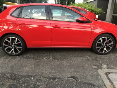

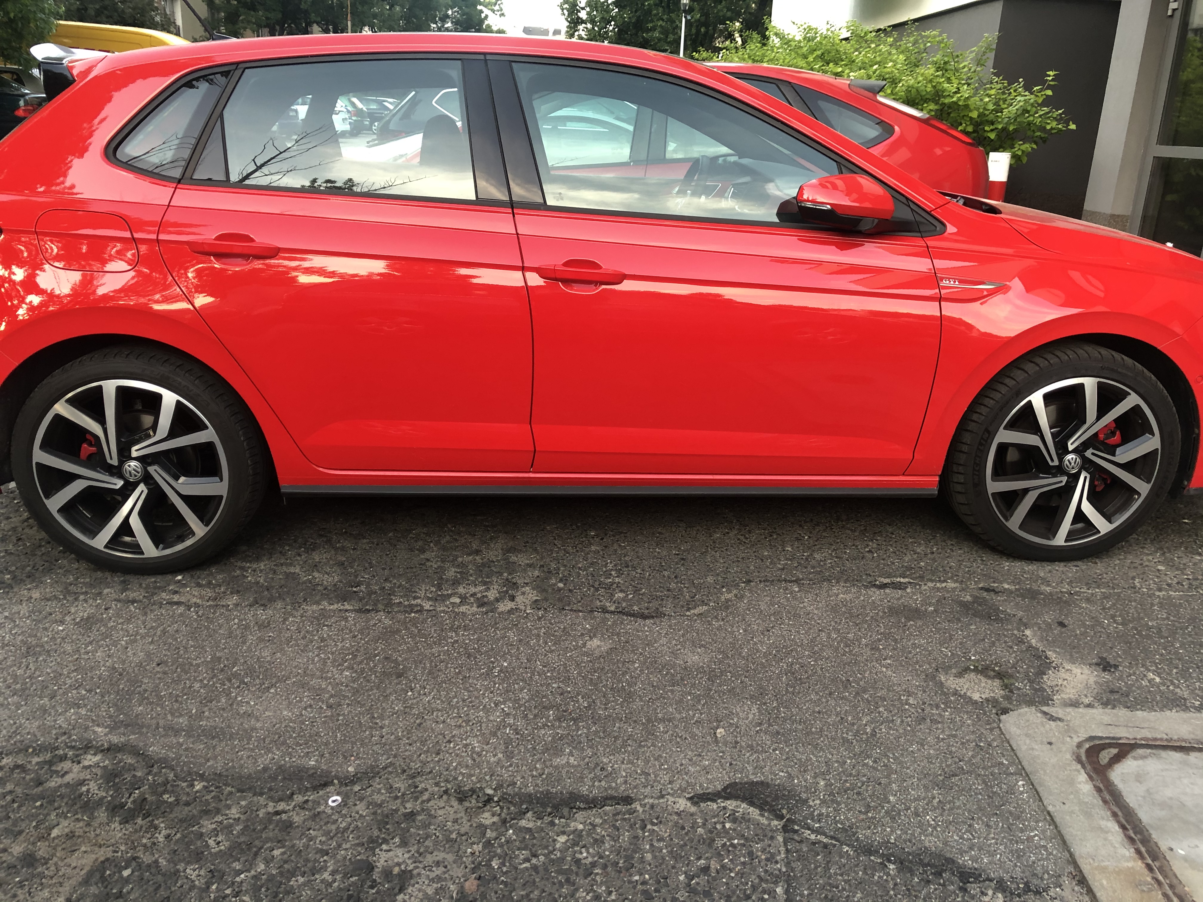

green justin wrote: Mon May 11, 2020 9:26 pm
fazzy wrote: Mon May 11, 2020 8:02 pm Just got mine.... :)
Hoping for some improvement :)
Can you post more pictures a meter away?
Missed your post earlier on...
But here it is.
An unusual picture :)
Front 225/40/18 Michelins PS4, rear 215/40/18 Bridgestone T001

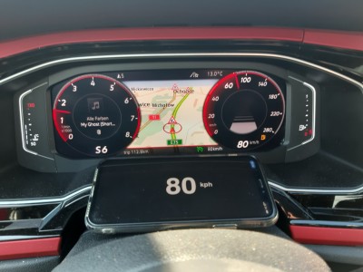

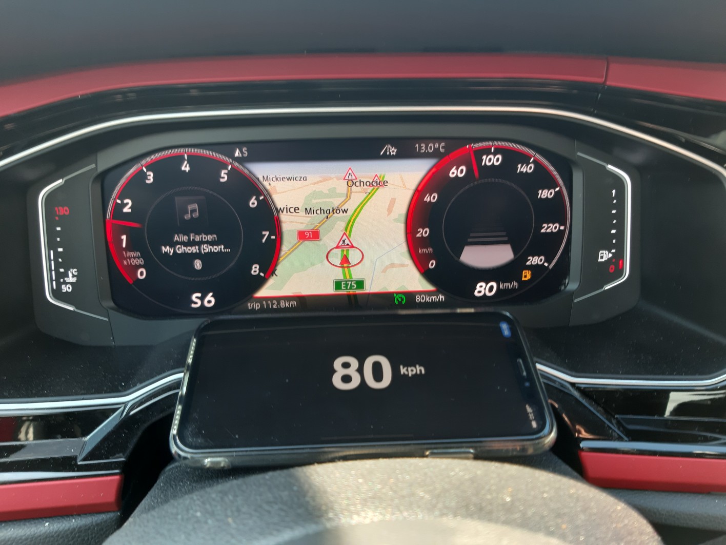

Here is also a speedometer vs gps reading on the 225/40/18 if anybody was interested... 😉

Adding width to the tyres wont change speedometer readings as you aren't increasing the circumference. If you put 225/50/18's on the front then you would affect the speedo.

stuartrendall wrote: Sat Jun 13, 2020 12:19 am Adding width to the tyres wont change speedometer readings as you aren't increasing the circumference. If you put 225/50/18's on the front then you would affect the speedo.
The 225/40s do have a bigger circumference as the height value of a tyre (40) is a % of the tyre width
40% of 225 is more than 40% of 215

PhilArnold wrote: Sat Jun 13, 2020 4:15 am
Thank you 😊 saved me a lot of writing.
The change is tiny, and of no concern. I wrote a lengthy post on this a while back (maybe in this very thread). The overall wheel circumference increases 8mm, about 1.4% if I remember rightly. The circumference of any given tyre is goinv to change by 10-13mm from new to legal minimum tread depth (1.6mm in the UK).

monkeyhanger wrote: Sat Jun 13, 2020 9:55 am
oh yeah I completely agree with you, miniscule change but was just pointing out how the tyre sizing numbers work
