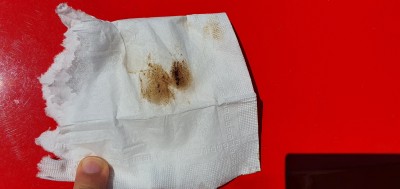

This is what it looks like on paper if i try to soak it up.

what does it smell like?

Funnily enough I had this exact thing in the back of mine. Previous owner looks to of spilt something in the back and had just been sitting there. Mine was almost like oil but harder and really hard to clean.
A detailing brush and some APC sorted mine...good as knew. Consider this if you haven’t had it since new and check your boot under the spare wheel next to the battery.

No smell, I thought it was a spill but I cleaned everything and came back, I will have a look, it seems to come from the side of the fuel tank but I will have a look again.

It really does look like there has been some sort of solvent spill at some point. I think the dark oily residue you have wiped off is because it's partially melted the black bituminous sound deadening. If you've cleaned everything down did you check to see if anything had soaked into the seat backs it may be something that just continuing to weep/drain a little??

Only the right rear seat is covered in this liquid, but I have taken the cloth out and cleaned the sponge but it looks like the leak is still there, it is really here in Portugal, any liquid would for sure dry up, and I have driven without the rear seats for a few times so plenty time to dry up, so with regards to the rear axle , I used a pressure washer and looks like it helped a little, did a wipe down but it looks like there is still some residue on it, doesn't seem to come off early, almost like when there is some oil in the engine cover and it takes a while to get it off, I don't have any tools to jack the car up, I will have to ask a local garage to have a look for me but it will be hard as they will charge and are so busy. I will see if I can get under there but I doubt it, just thought any one else had this issue, by the way if it was possibly a fuel leak how could I tell?
