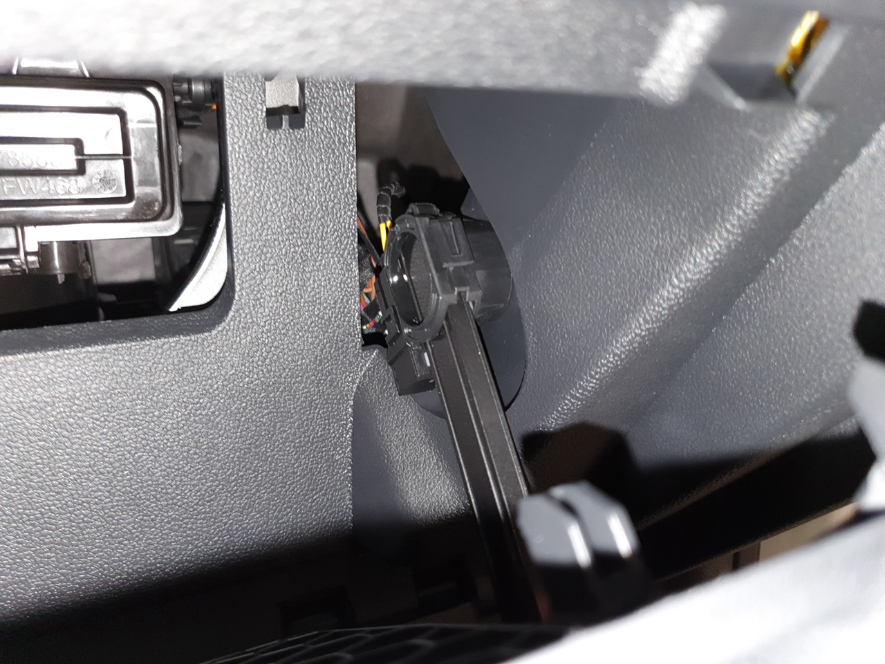

Yesterday the remaining parts finally arrived, today was the day to put them in the car.J+silva wrote: ↑Sat Jul 18, 2020 5:13 pmIf you need more information tell me.proalves wrote:Nice upgrade, i will do as you did.J+silva wrote: ↑Fri Jul 17, 2020 3:56 pm

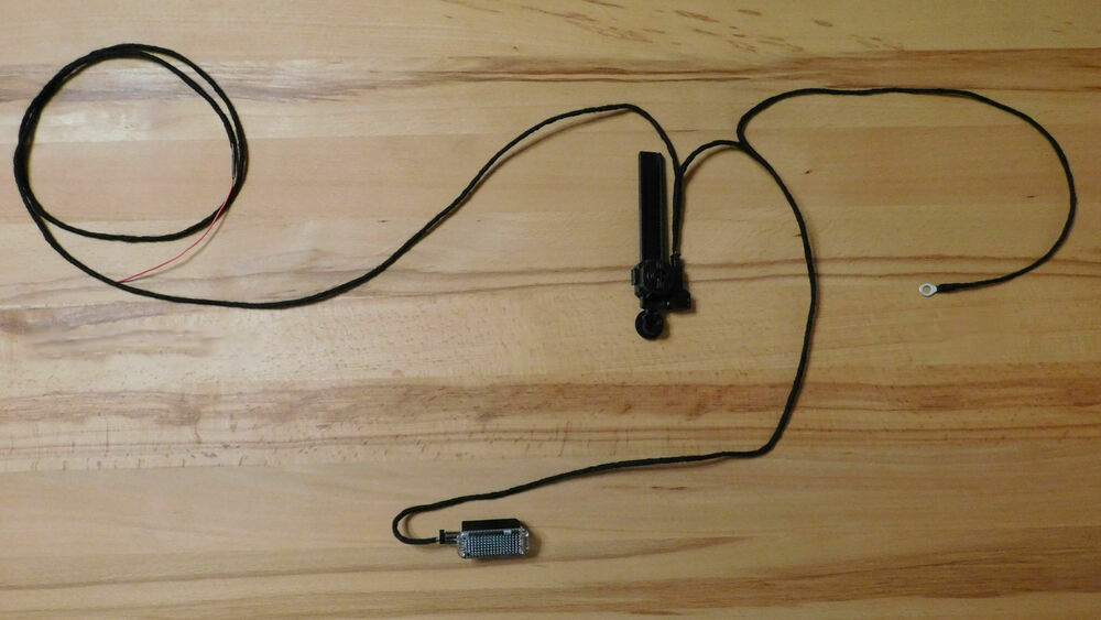

Finally the piece arrived, as it did not have the plug to connect to the led I soldered the wires to the led, to connect to the hinge it will be necessary to buy the plug, I had one that is very similar and served.
It be connected to the car or to a 9v battery, as the light turns on a few times and its a led battery lasts a long time.I connected to a battery.
Enviado do meu SM-A405FN através do Tapatalk
Small upgrade but I'm satisfied with the final result.
The idea was to create something like this... But I want to thank the user J+silva for his magnificent idea of connecting to a battery, because I didn't really feel comfortable working on the car's wiring.

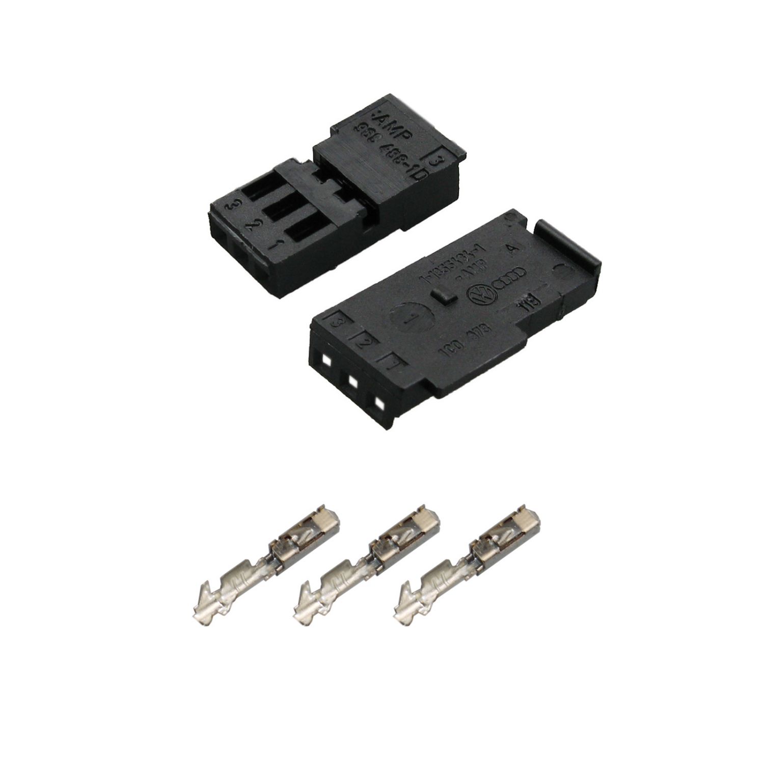

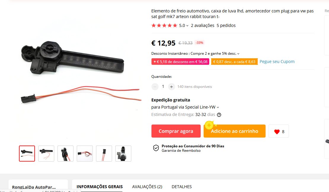

In addition to the part already mentioned 5G1858309 and a Luggage Lamp 8J0 947 409 and the wiring that I had from my previous VW Golf, I also used...
1 plug 1C0 973 119 B
2 connectors N 907 649.02
And wire to make the rest of the cabling, and lots of fabric tape.

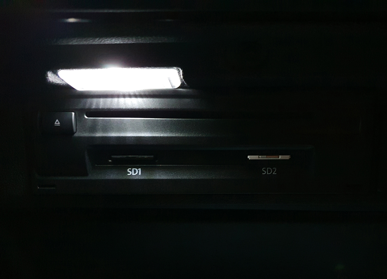

This was the result...
It wasn't difficult, I just wasted some time passing the wires because I didn’t disassemble anything.
I hope with this I can help future interested in doing this simple upgrade.
