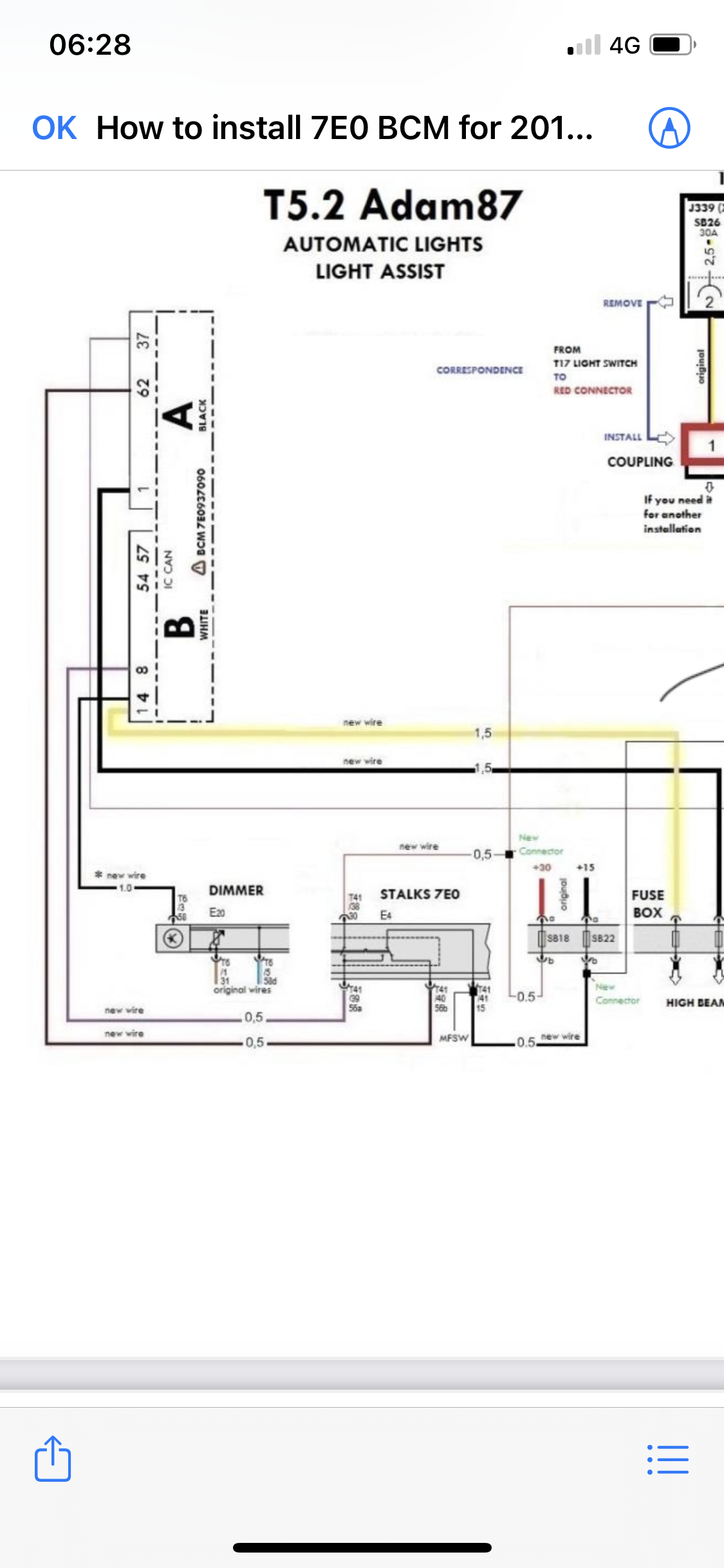

I still have a problem with return spring stalk I followed diagram you made from Adam87
High beam goes on when I push lever towards dashboard, but they stay on, only way to switch them off is either switch off ignition or switch on low beam and switch them off
I dunno what function have wire from T41/39 that goes to T73b/8, but it doesn’t do anything after 12v supplied to it
I belive high beam should flash
It seems like bad coding unless there is an error in diagram
I changed channel 54 to 1, switched off byte 23 bit 0 and switched on byte 28 bit 3
Have I missed anything?

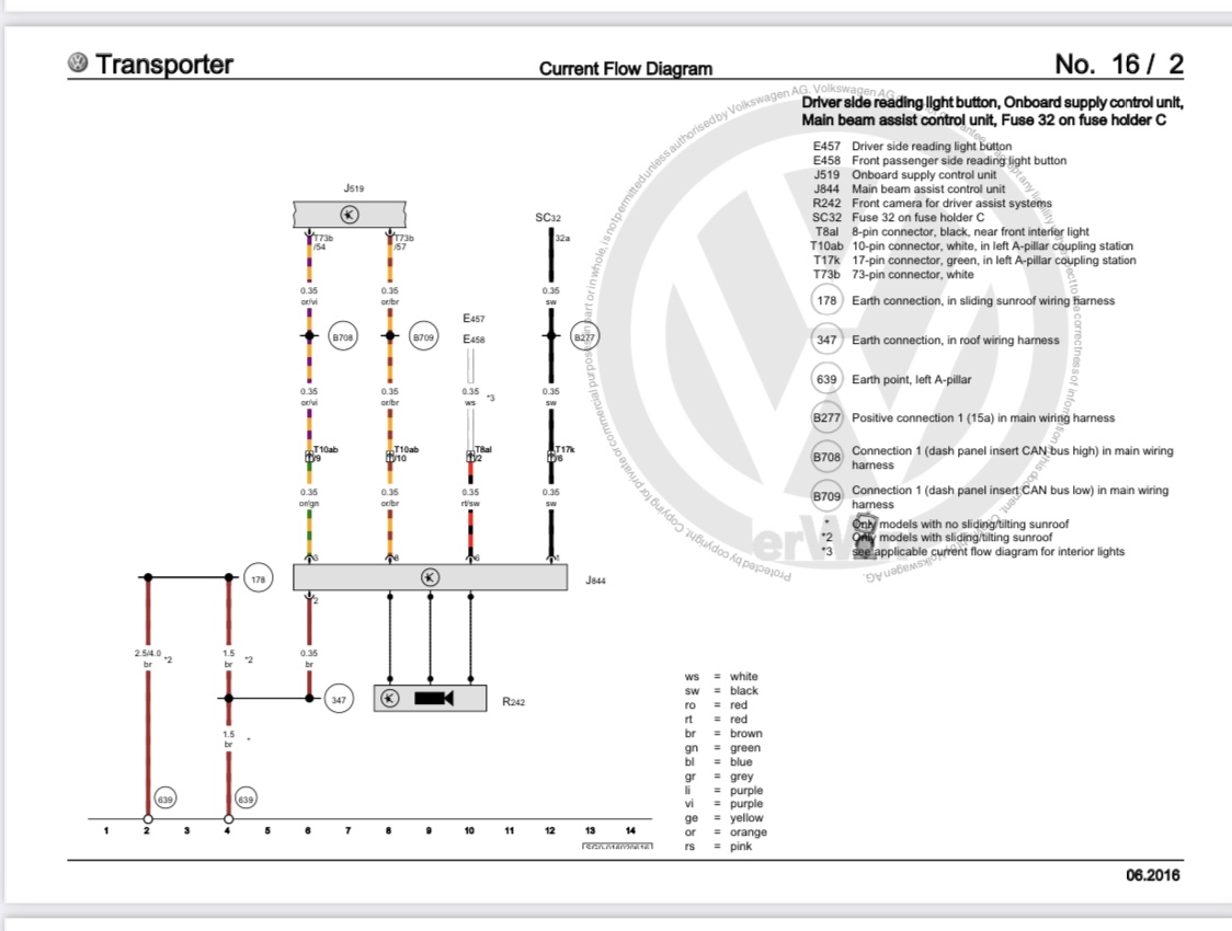

I wondering why flasher is not working, if I put 12v on T41/39 ( goes to T73b/8 ) nothing happens, from what I understand from diagram T40 and T41 are responsible for constant high beam, T38 and T39 for flasher, unless I am wrong
For HBA, if I am right
T8/1 +15
T8/2 ground
T8/3 can hi
T8/6 overhead light button ? - what value of diode 12v/amp?
T8/8 can lo
Where +30 (T3 connector) goes and high beam signal (T4 connector ) from Adam87’a diagram/instalation manual as I cant work it out, they are not on T5.1 diagram

The diagram you have posted is correct, which is exactly the same as the diagram/scheme that I have posted/made.
I haven't reviewed the installation guide for Adam for a long time, so I can't tell you anything about it ... to make Adam's wiring (in MODE very good friends) I used the connectors I had available at the time :| , ... with the sole purpose of facilitating subsequent wiring installation.

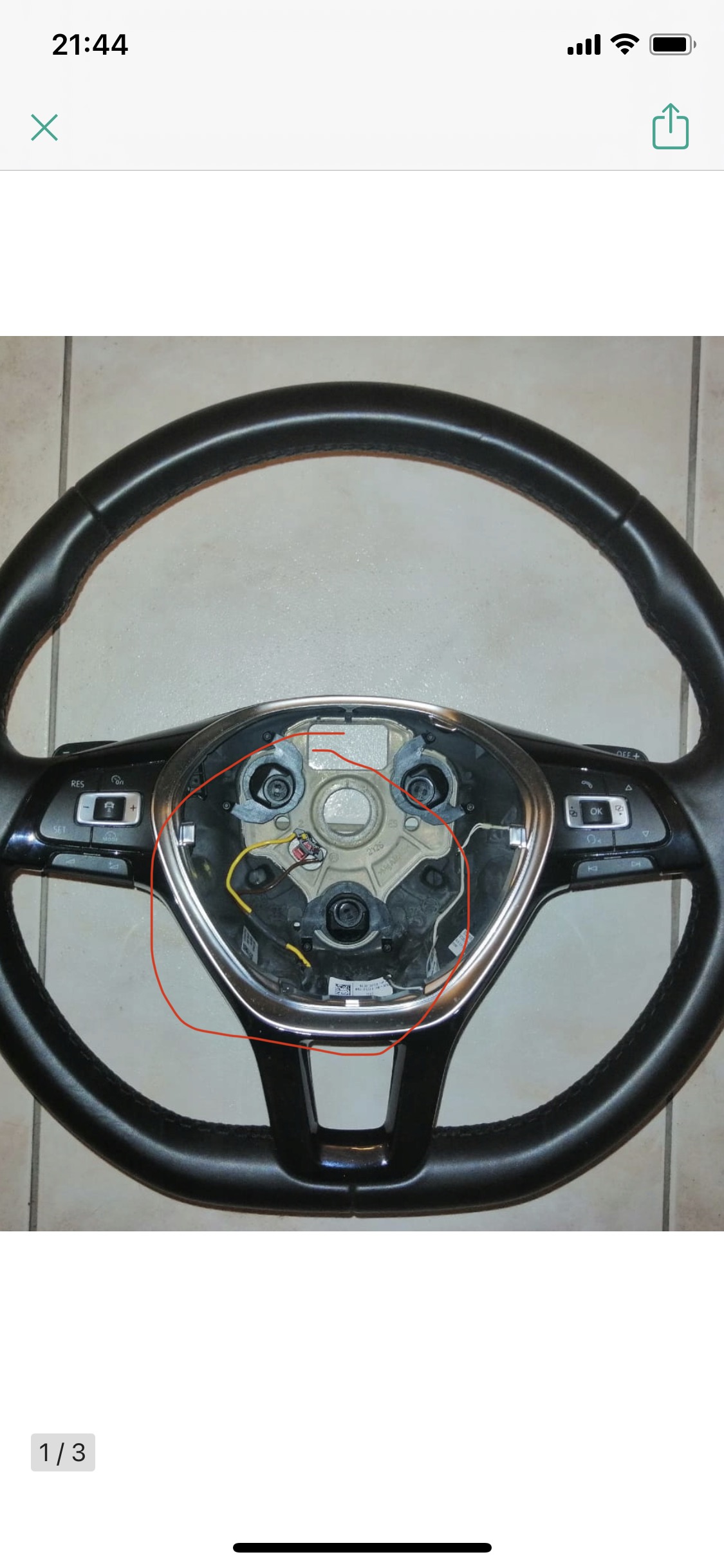

Anyone have an idea what that yellow and brown wires with 2 pin connector are for?
Posts: 6689
you appear to have a steering wheel with heating pads installed
bropasiek
Posts: 35
Joined: Tue Aug 25, 2020 4:29 am
Drives: Caravelle T5.1
Location: Leicester
Post by bropasiek »
Thanks for reply
Nothing important then, don’t have to be connected
However it can be a handy retrofit for cold days
Unfortunately there are no empty pins in a stalk tape to make it work and I don’t think there is a way to use Touareg or Golf tape to get extra 2 pins
