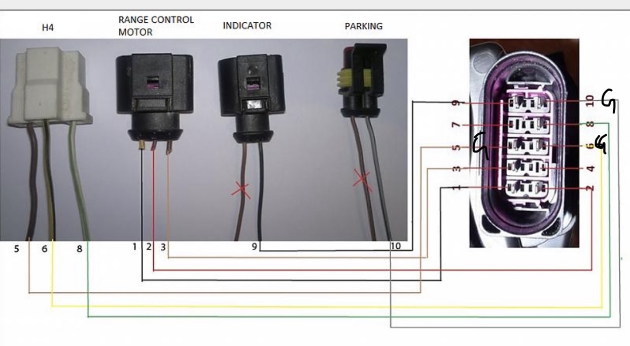

I have vento (india) 2011 with single barrel H4 three pin headlight. Recently I upgraded to dual barrel H7 two pin headlight. The connectors are totally different with both headlights. The former has three connectors( one for parking light one for signal light and one for headlamps.) while the later has 10 pin connector.

Re: Twin Headlight and Single Headlight System
Yes that's correct. You need to reconnect the wires to the new connector
