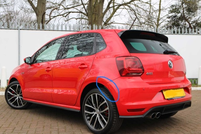

It’s also worth remembering that even if the wheel doesn’t protrude beyond the bodywork, the tyres might (will depend on the width of the tyres fitted). Even with the 6C Polo GTI and the standard 7.5J x 17” wheel and 215/40 R17 tyre set up, in the UK (not sure about other markets) VW fitted little plastic wheel arch extenders to the rear wheel arch lip to cover the exposed section of the tyre tread - you can see it if you zoom in on the picture below;

SRGTD wrote: Fri Mar 26, 2021 9:47 am It’s also worth remembering that even if the wheel doesn’t protrude beyond the bodywork, the tyres might (will depend on the width of the tyres fitted). Even with the 6C Polo GTI and the standard 7.5J x 17” wheel and 215/40 R17 tyre set up, in the UK (not sure about other markets) VW fitted little plastic wheel arch extenders to the rear wheel arch lip to cover the exposed section of the tyre tread...
Yeap, I noticed also Mazda, Audi and a lot of other cars have something like this
For Polo 6R/6C it's:
  • 6C0807837A9B9
  • 6C0807838A9B9
