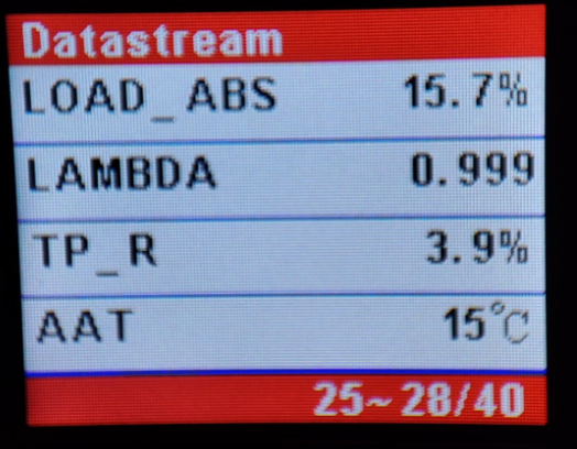

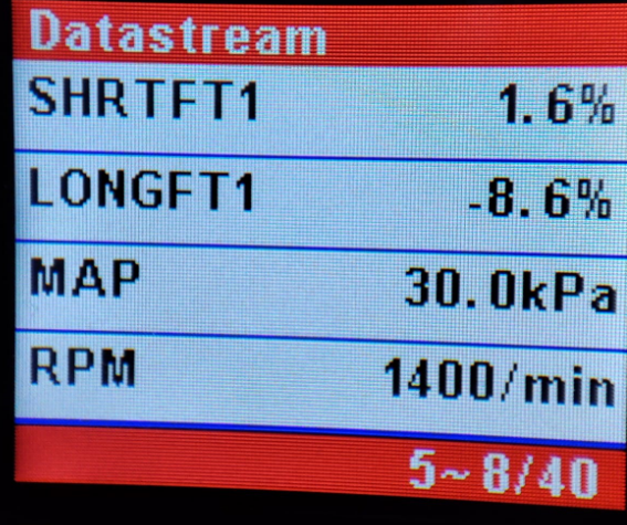

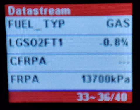

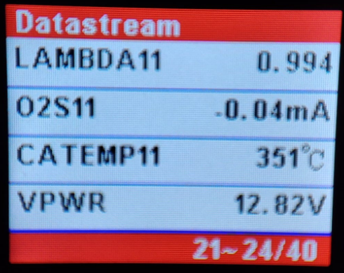

update with my basic Thinkcar 100 OBD reader datastream at idle.
there are no DTCs acknowledged on the scanner
Longterm fuel trim is negative I notice.. not enough knowledge to tell much on this.. anyone see anything significant

update just to keep a record that might help others..
The software update the VW garage did has made a driving difference.. not noticed much with the fuel consumption.. it is still averaging 53mpg with local and a few trips. I the drive or power uptake is smoother.
I checked the change with my scanner and a big difference if Fuel Trim readings.. compared with those in the posts above.
Short Term FT was 1.6%
Long Term FT was -8.6%
LTFT was a bit of a worry.
since the update, with no parts like injectors replaced; they are very near perfect
Short Term FT now 0.0%
Long Term FT now 1.2%
makes you wonder what the software update did
