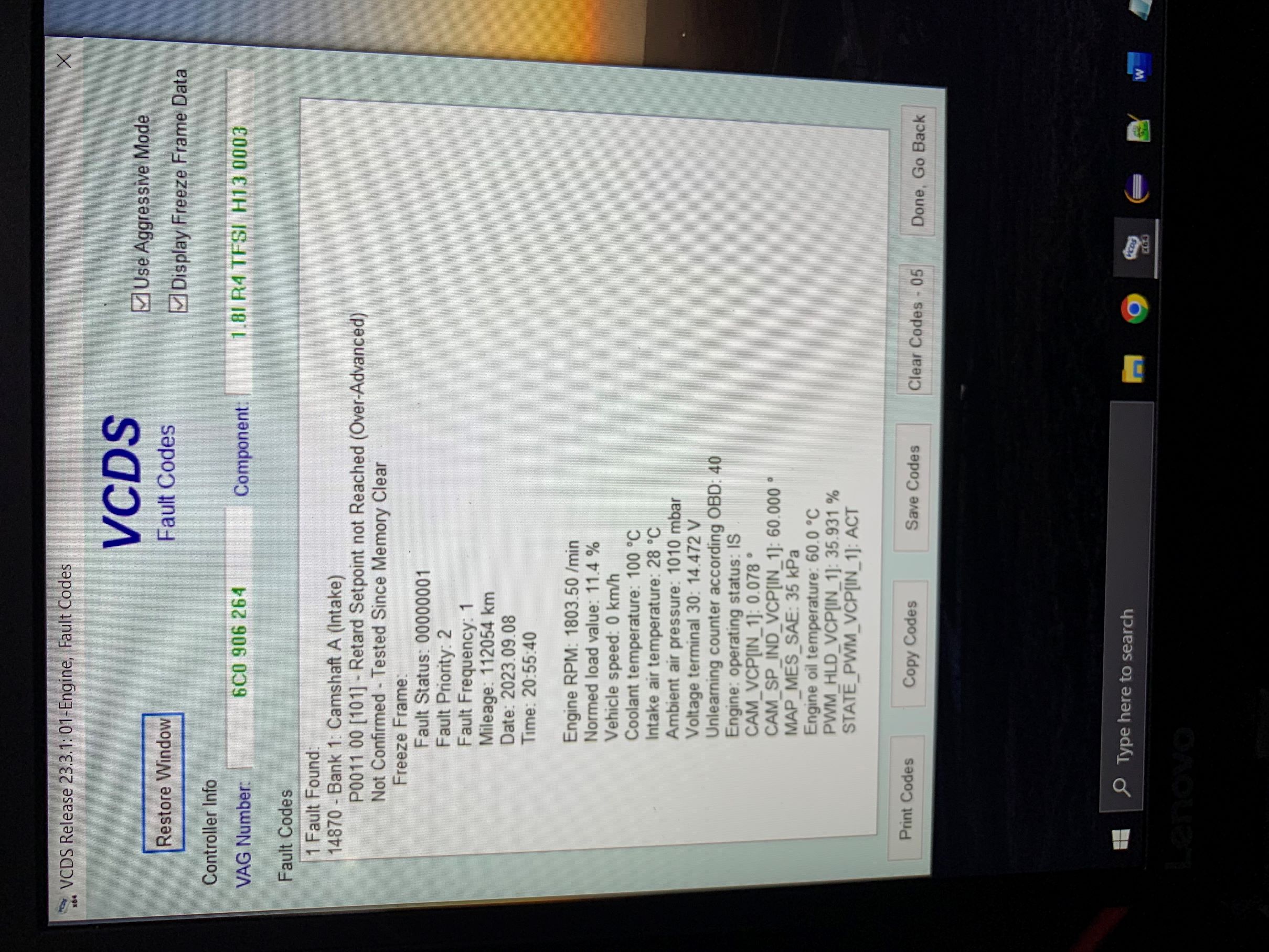

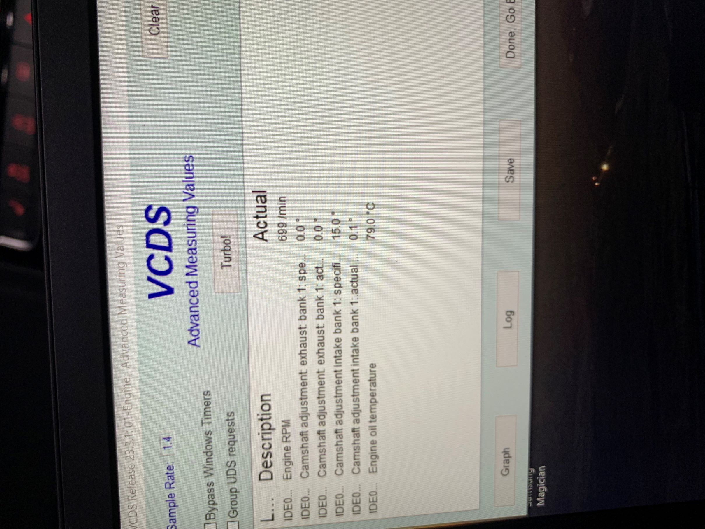

Occasionally I get a tapping noise on startup from the engine which I can only assume is the cam phasers as it’s a very light tap that eventually goes away.
However this tapping at startup is becoming more frequent and sometimes won’t go until I bring the revs up for 5-10 seconds to build some more oil pressure.
I got this noise with both 5w30 and 5w40 but it mainly happens on cold start so shouldn’t really be a factor. The noise didn’t happen for some time after performing an oil flush so I’m coming to the conclusion that the cam phasers or more specifically the cam phaser bolt/oil inlet isn’t working properly or is gummed up even with oil changes every 5K.

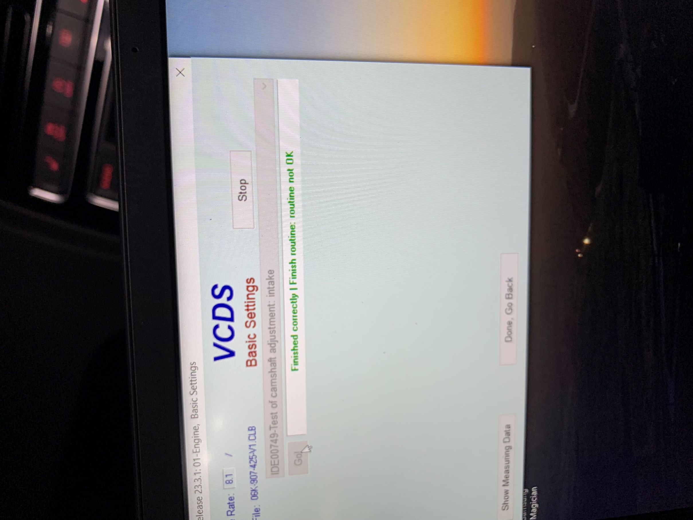

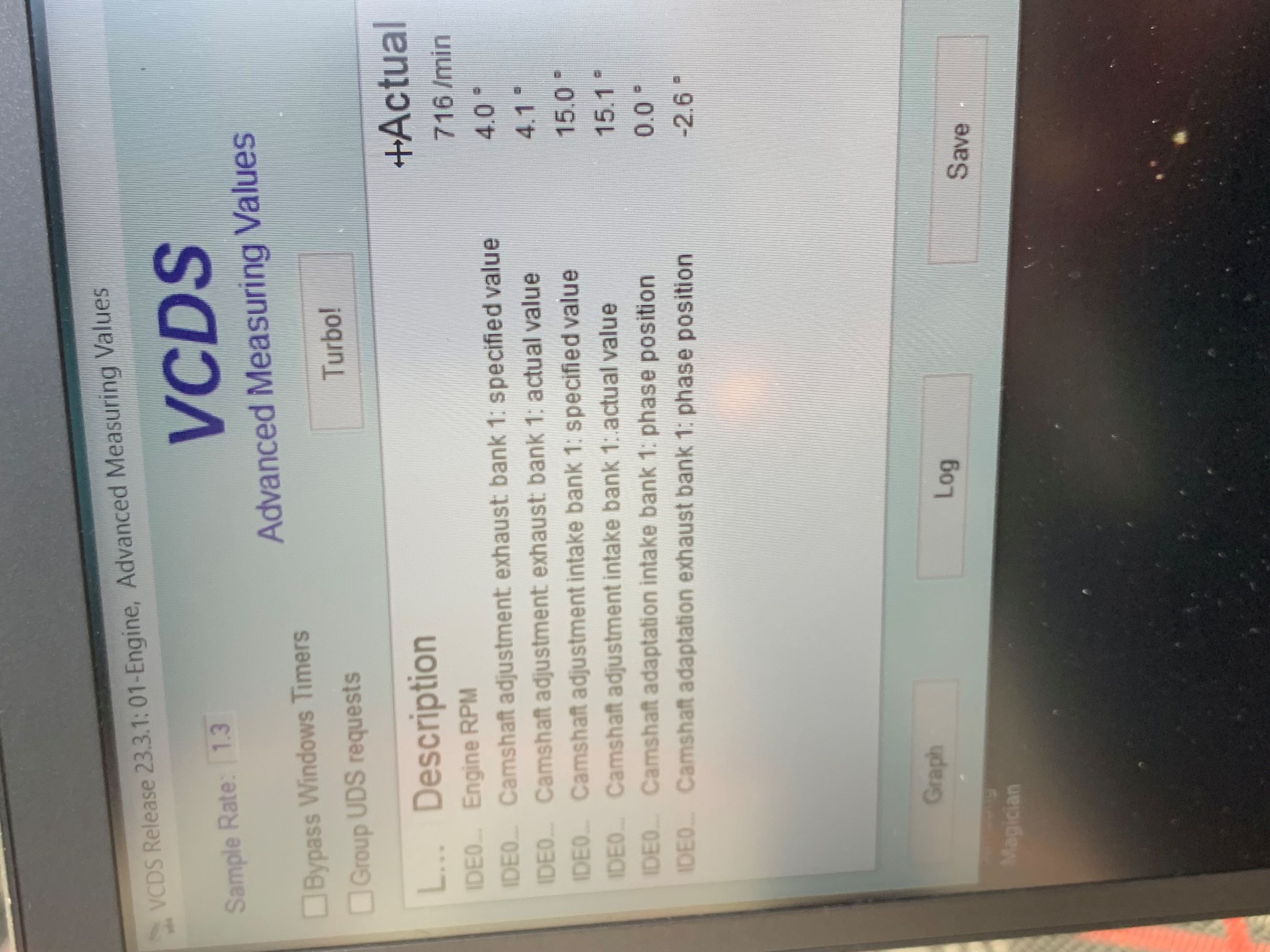

I have no drivability issues or warnings and the cam adjustment value is almost rock solid and doesn’t waver massively like those who have worn out cam phasers. But a tapping noise from an engine is always of concern.
I don’t believe it’s chain stretch but I can’t find a definite way to measure on this version of the EA888 with VVT on the intake and exhaust using VCDS.

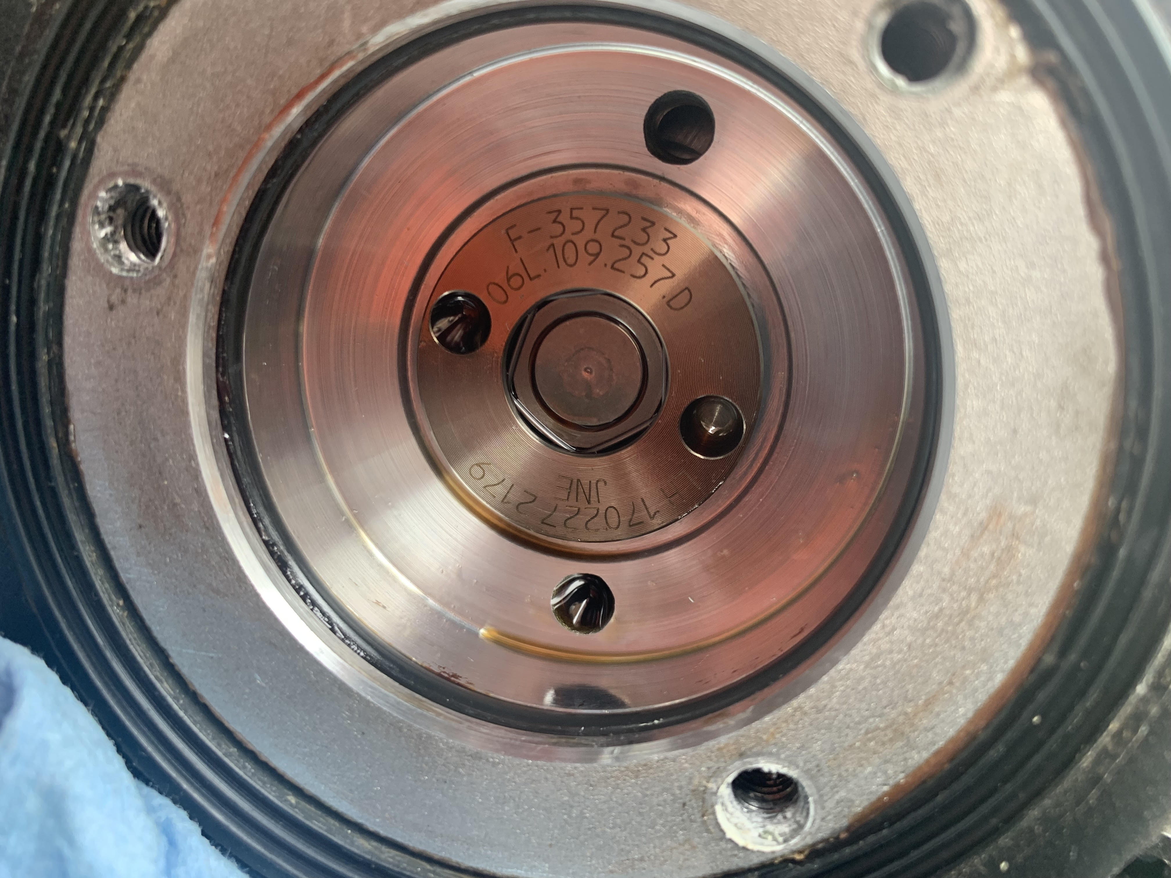

The other issue is with the phaser bolts(06L109257D). The current reversion I believe is F and I believe I have revision D fitted according to the VIN split around 2016. Looking at the two online it seems in VWs infinite wisdom they’ve changed the design of the part meaning if you needed to replace revision D you’d need to change your whole cam shaft as well as revision F isn't compatible.
After looking online it seems there are 2 oil screens in the system. One in the cam bridge itself and one in each phaser bolt.
My questions are:
How can I narrow down the source of the noise?
Is it possible to just clean the cam phaser bolts? Ultrasonic cleaner, brake cleaner, degreaser etc?
Do INA still make the revision D cam bolts as everywhere says out of stock?
Is it likely that at 66k miles the oil screen in the cam bridge has become dislodged?

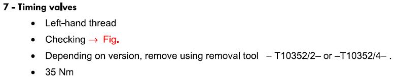

After some digging, it seems there are both revisions F and revision H available from VW. With the VIN split being in 2016 my car came with revision D which I'll need to confirm by having a look after taking a cam magnet off. Revision D was superseded by G and now H from what I can find with H being vastly different to D.
There also seems to be some difference in width 20mm vs 21mm in prior revisions to H but they seem to be determined by the holes for the socket to engage with. It seems to be centred = 20mm and offset is 21mm.
I need to look into it a bit more but will post my findings.

06L109257D has been replaced with 06L109257G - £68ish from the Dealer TPS.

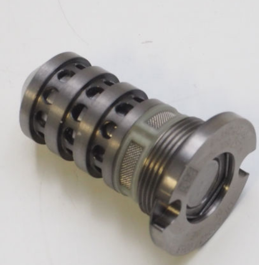

I'll ring my local dealer again at some point as they informed me they could only get 06L109257H.
I've ordered a pair of INA items (INA 427 0058 10) which I believe were the OEM at £48 each plus £8 delivery from autodoc which will be here either tomorrow or Monday.
The only concern is that they list rev D G and H as compatible part numbers. If they aren't correct I can always return them and then try and get rev G from the dealer or TPS.
For reference by others, my March 2017 built engine has rev D as per the vin split

Re: Noisy cam phasers on startup (1.8TSi 6C GTi)
H isn’t compatible. Not sure who gave you that info
I pulled this straight out the parts system and also double checked it with TPS when I was in there earlier
G is available next day

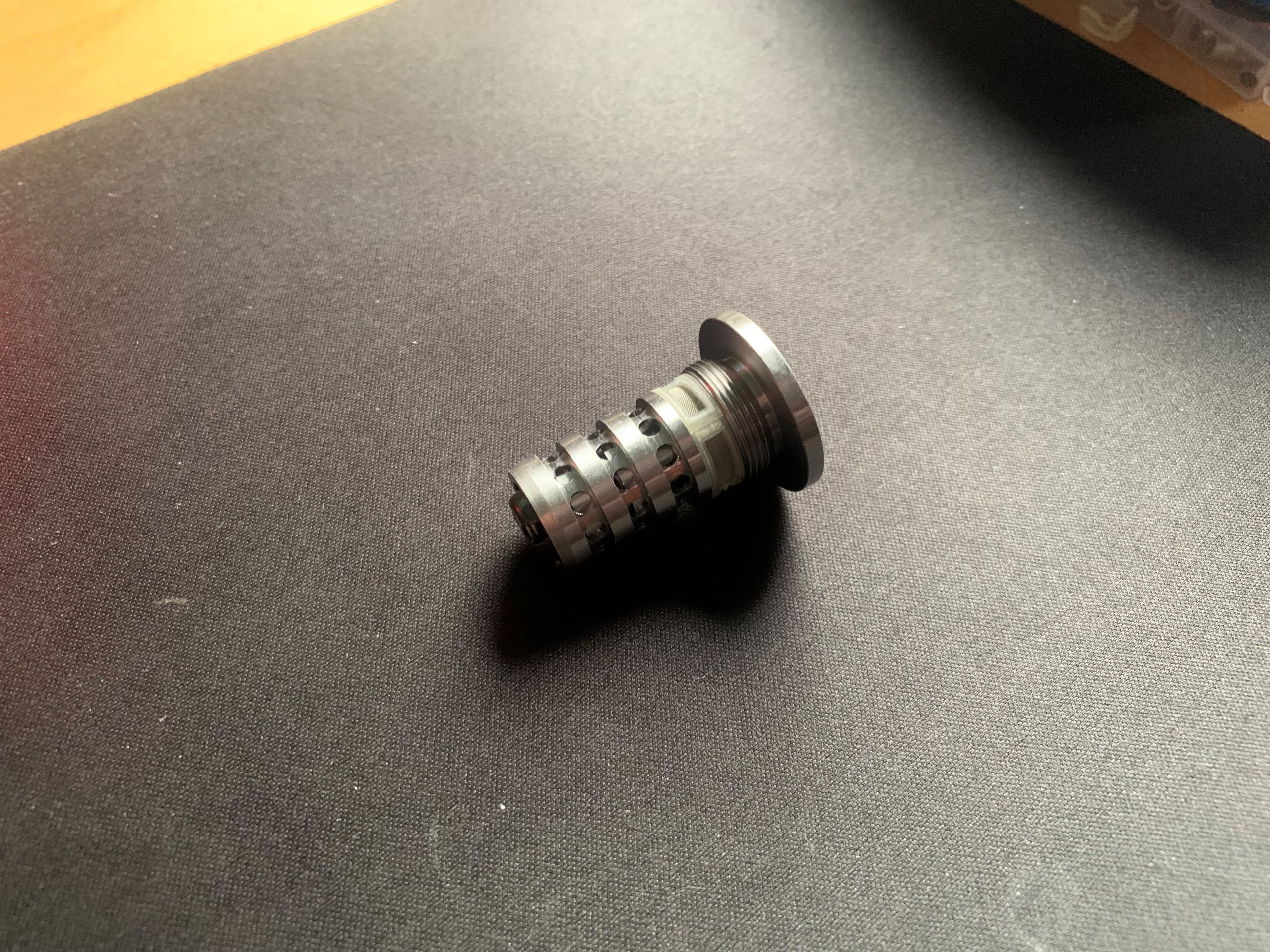

Forgot to update this topic

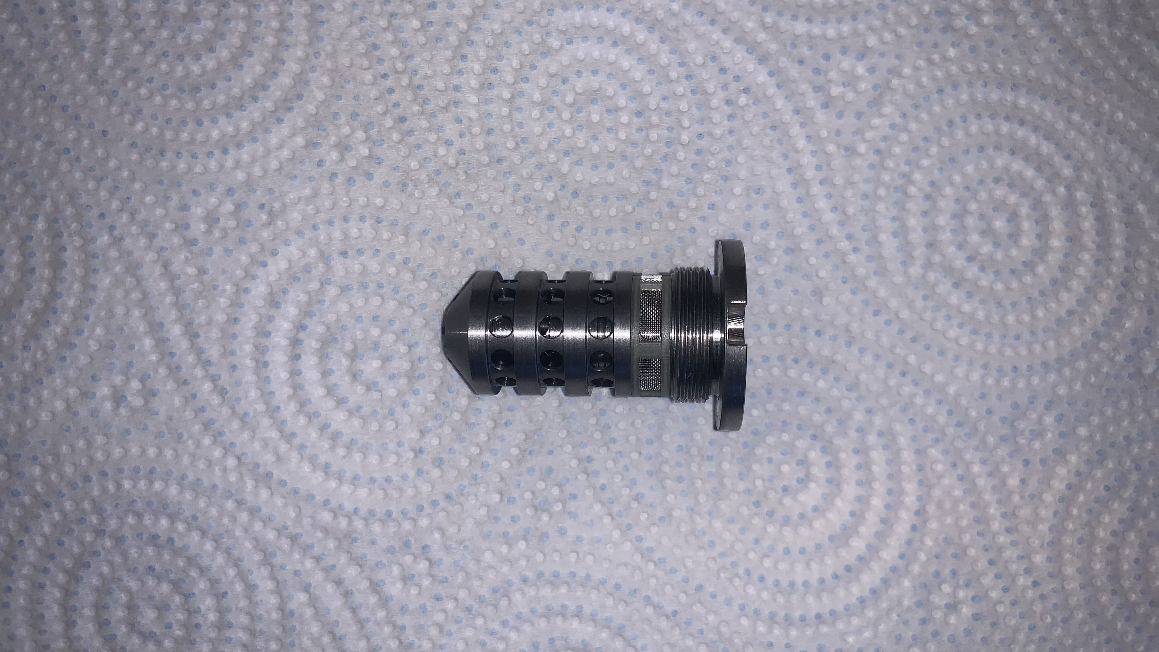

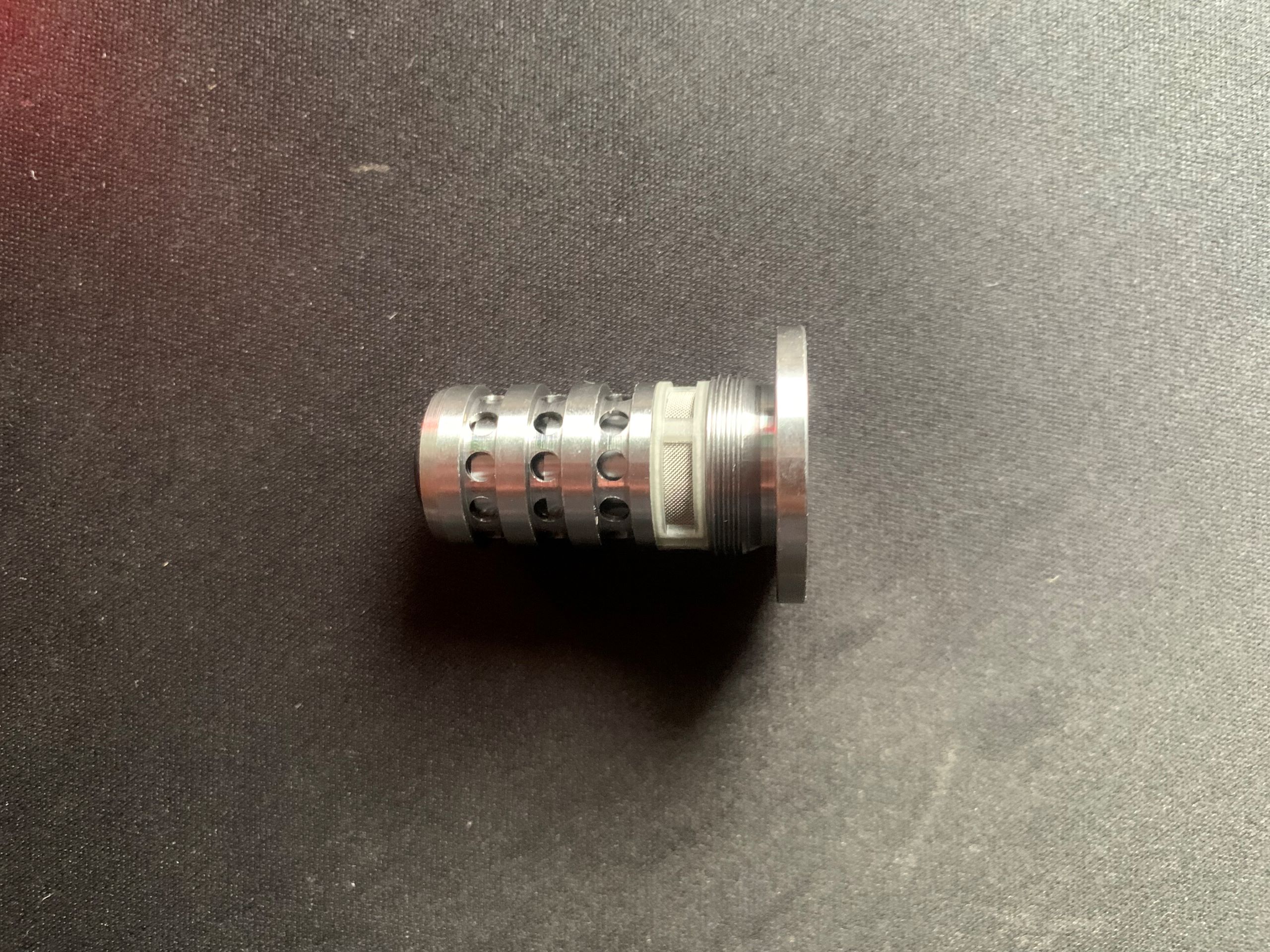

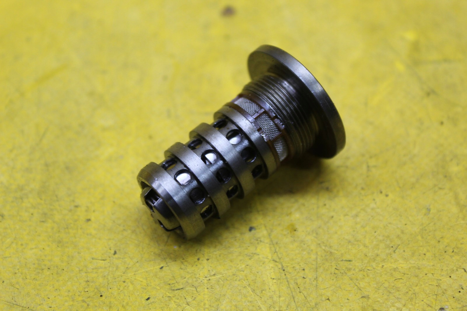

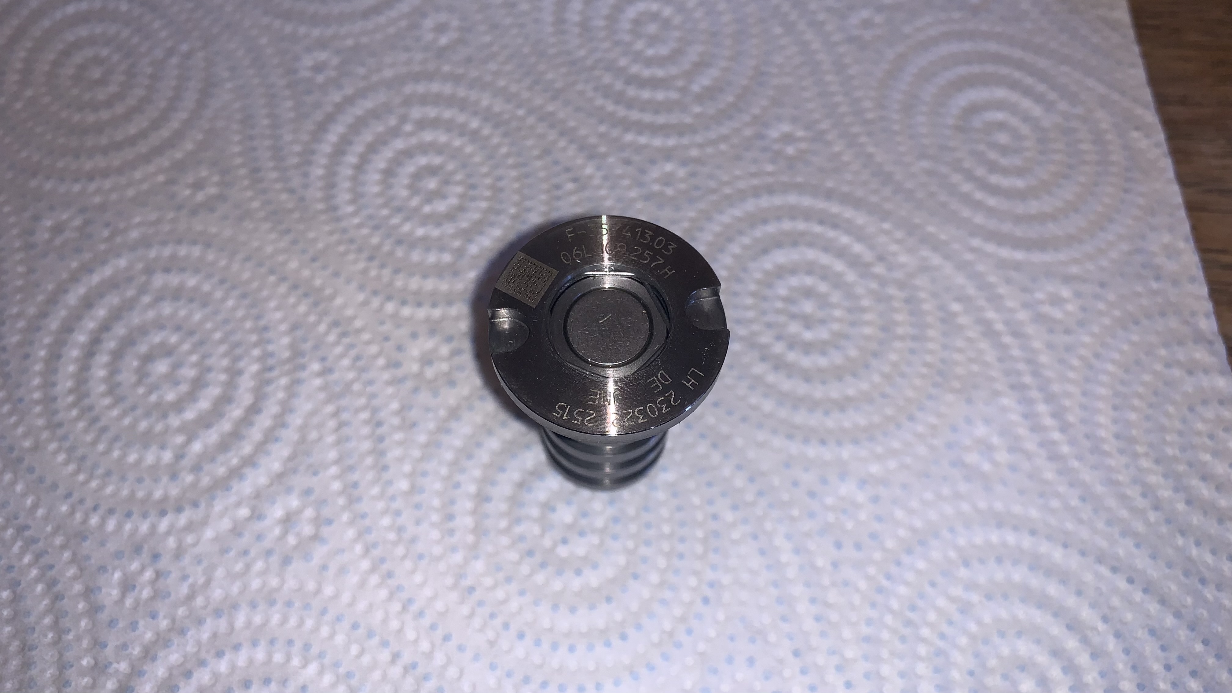

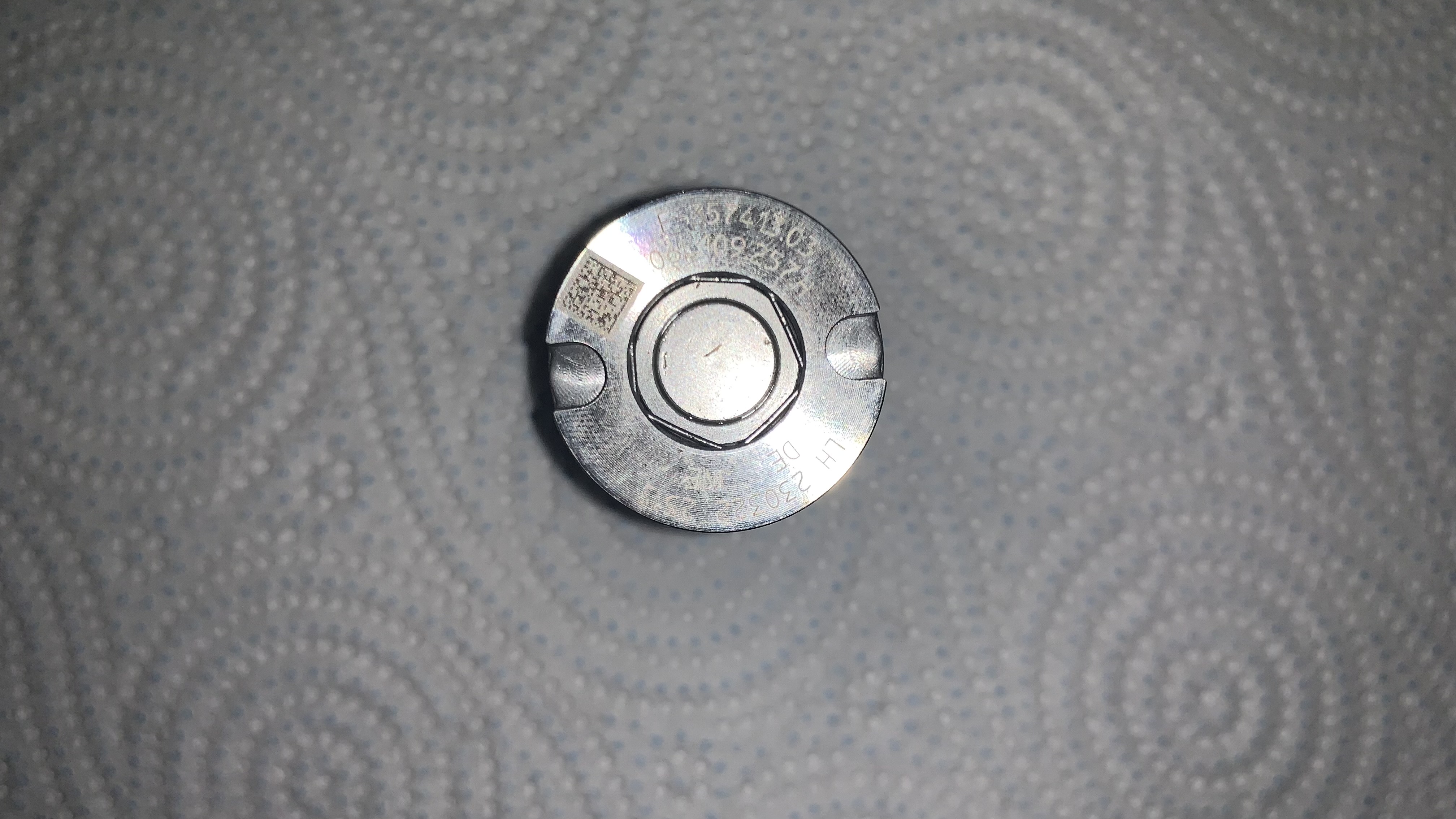

The INA part is revision H so will obviously not fit. I'll include some pictures of the INA part for reference by others.
On the other hand, after removing the magnet for the intake cam I found the pin was a little stuck but freed itself up once I gave it some encouragement and now rocking it back and forth it moves with no effort as it should. This also seems to have corresponded with the rattle after cold start not happening for some time. I'll give it a while to see if the noise returns.
I now, however, have some oil misting coming from the PCV hose and one of the "Audi Valve Lift" solenoids on the exhaust cam to sort instead
I guess there are still PCV issues even with revision BL fitted
Also, for anyone looking for some sockets for the spool valves, BGS 8565 has the two different styles, offset and centered.

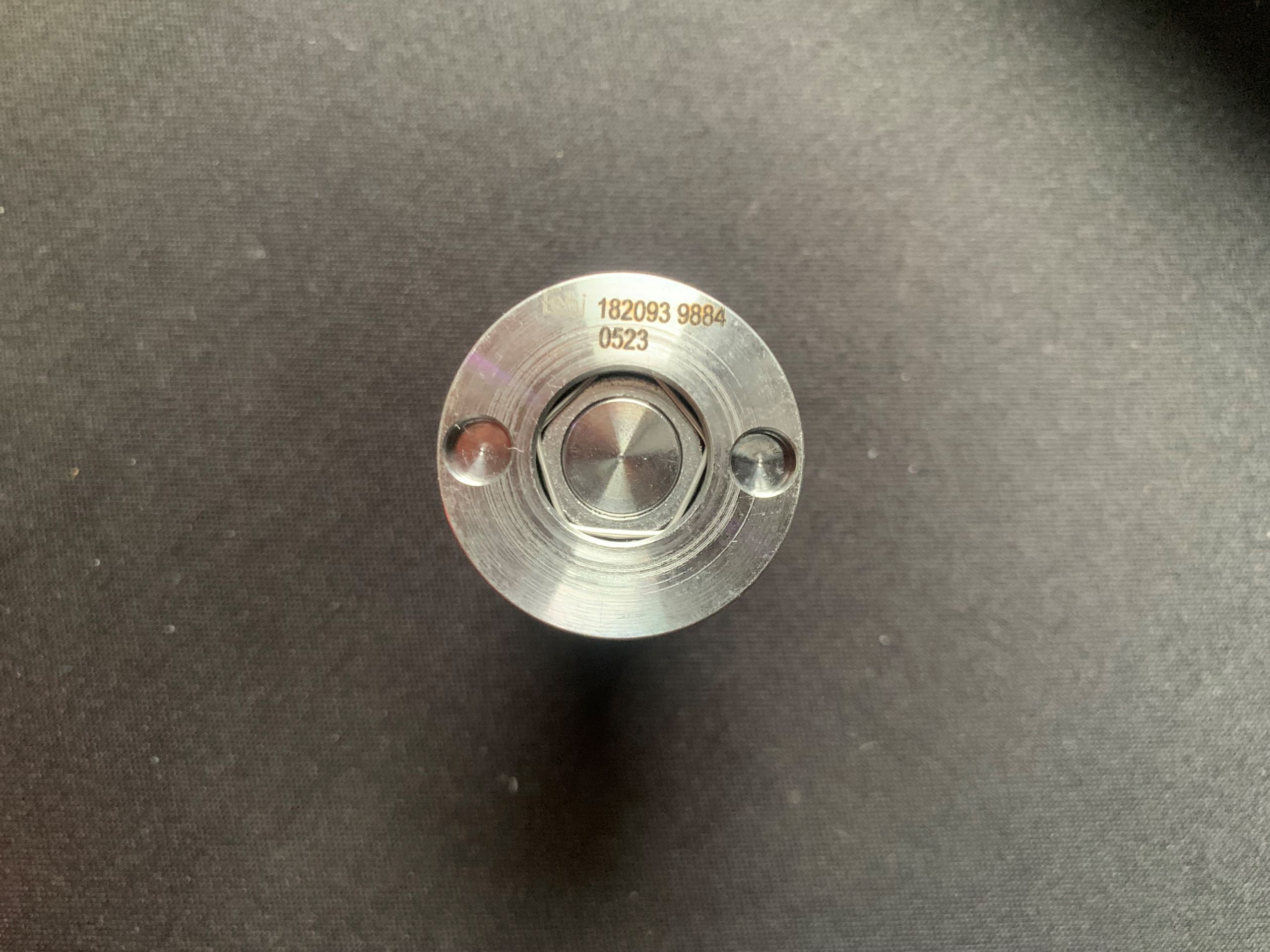

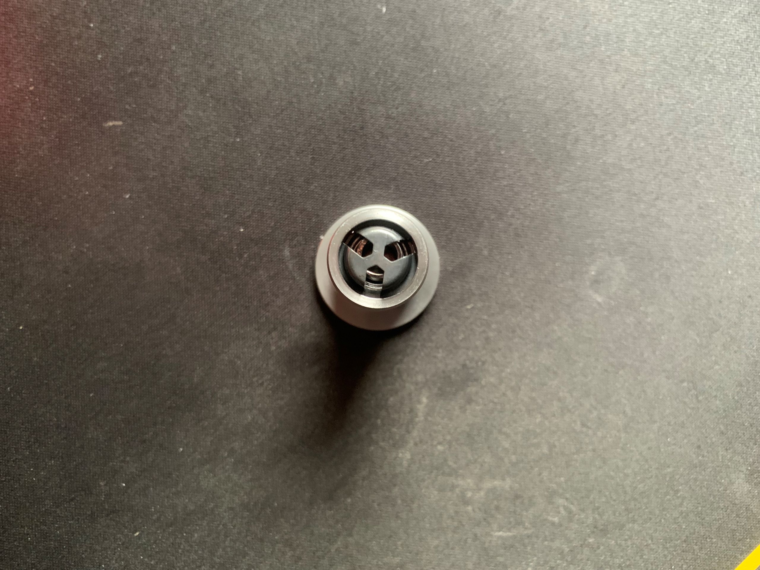

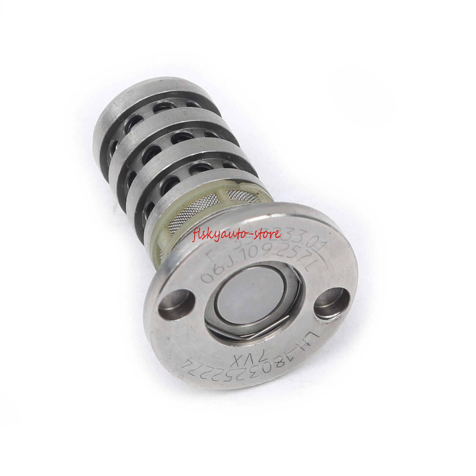

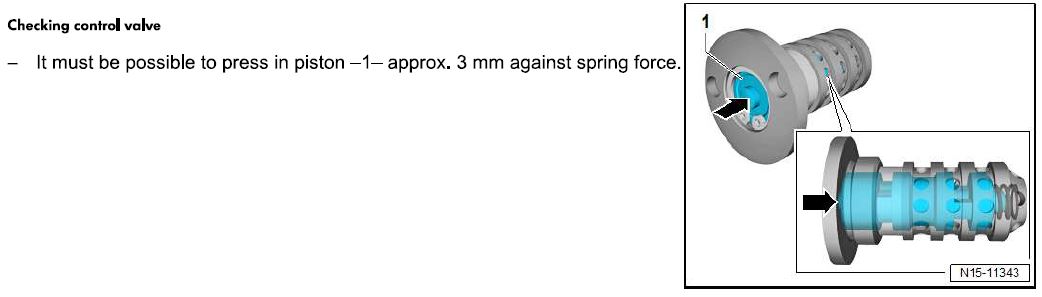

Well after a lot of back and forth with various parts counters at various dealers and TPS, I've given up trying to get an OE part. Some TPS locations still have revision G in stock but won't sell it to me, some dealers cannot get G at all, and those that can, can't do a stock transfer from TPS due to the part being superseded.

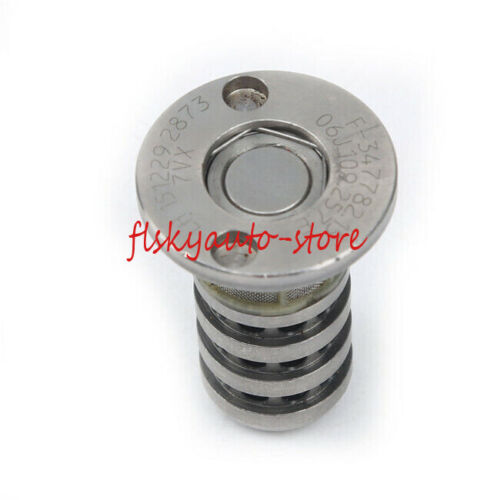

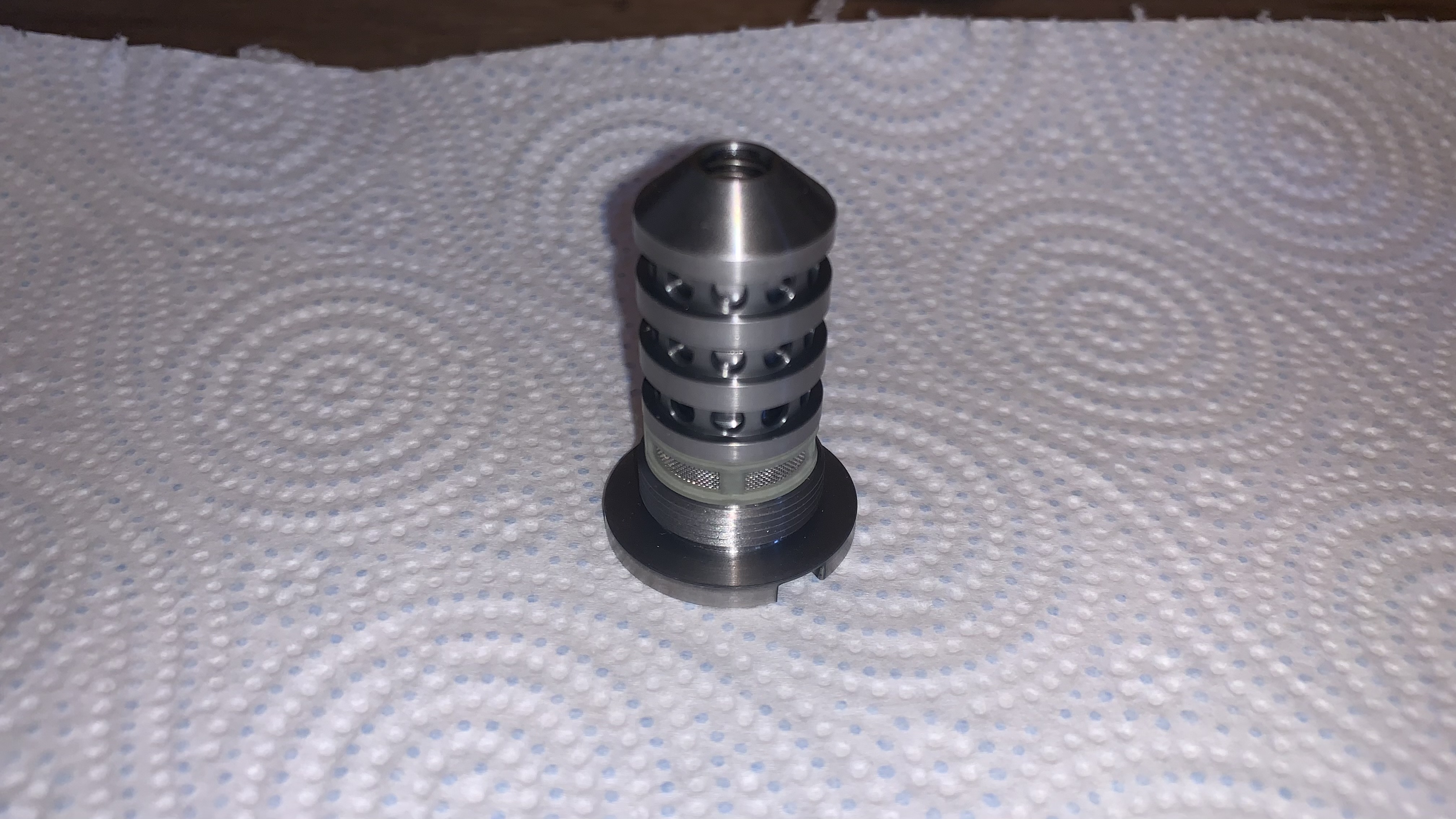

So I went back to Autodoc and got the Febi part as it was in stock now. It specifically doesn't list H under its compatible part numbers only D and G. They arrived and seem to be the correct part. The same centered holes for the T10352/4 socket and the open-end cap, unlike H. The part number is 182093 and around £40 plus delivery.
Haven't done the job just yet as I remember my solenoids were initially stuck and then weren't very free moving when I originally took them off to inspect which valve I had fitted so currently waiting on 2 INA parts from autodoc. £25 each plus delivery, £74 each from VW, and FCP Euro list INA as the OE for that part.

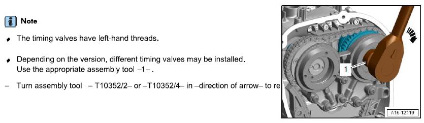

Also turns out there are 5 different sockets for these valves, The original 2 I bought the "correct one" didn't fit so just bought a set that had all 5, BGS 70112 £22~:
https://www.amazon.co.uk/dp/B0BG31FLWV? ... ct_details
T10352/4 fit the febi part, hopefully it fits what's on the car.

Yes, that was the video that tipped me off to the noise being of more concern than I originally thought.
I did the job last weekend and have been driving for a week and so far so good. I still get the rattling occasionally after cold start but not as frequently so when I eventually get the timing chains done I'll have them look to see if the screen filters in the cam phaser bridge are still there. I couldn't see any remnants down each of the cams so hopefully they're still there.
Now onto the job itself...
TLDR: Febi 182093 fits Rev D and G spool valves. Due to the lack of space in the polo engine bay, the exhaust cam is a pig to do. Test everything before you fit it, just because it's new doesn't mean it works. If the spool valve moves and returns, the screen filter within it is still intact and not gummed up and the spool valve itself is intact it probably doesn't need changing. After the job, my low-end torque is back 1800-2200 RPM is no longer dead, throttle response seems to be improved and my MPG is back

Now for the spool valve. For rev D and G it seems the correct socket is T10352/4 and I guess rev F is T10352/2. I'm not sure if it was the sockets I bought but all it wants to do is jump out of the holes on the valve. So use your left hand to apply a decent amount of force pushing the socket into the valve to keep it seated. They take some effort to break loose but once they are it's a very fine thread so can undo it by hand from that point. Once loose, they won't just fall out you'll need to get a pick or something of the sort behind the shoulder just to pull it out so you can then use your hand to get it out the rest of the way. There is more oil behind the valve so make sure the rag is still there from when you removed the solenoid.

Now for the first start, I connected up my VCDS to monitor the camshaft adjustment. All was well on cold start, exhaust specified advanced 30°exhaust actual 30° rock solid, intake specified and actual 0°. Then when cold start ended the car started shaking pretty badly. Exhaust specified and actual 4°, intake specified 15° actual 0°
I decided to try running the intake and exhaust camshaft adjustment valve basic setting. Exhaust passed, intake failed and set a P0011, Retard set point not Reached (Over Advanced). Once that code is set the ECU seems to no longer try to control the valves as both specified values went to 0°.

With the solenoids off, they were both still sticking when fully retracted but would then move with a little resistance.
Failed basic setting
Logged P0011 fault
Intake cam not adjusting Diagnosis
Luckily the fault was on the intake cam so the easiest of the two to work on.
I started with doing an output test of the solenoids as there was no movement at all so assumed the new intake solenoid to be dead. Exhaust solenoid had a rhythmic clicking, intake had nothing. To confirm it wasn't a wiring fault I plugged an old solenoid into the intake harness and let it rest on top of the engine cover and ran the test again. The old solenoid moved so not a wiring fault.
I removed the intake solenoid and confirmed it was moving, ran the output test and the new solenoid moved freely. So confused I decided just to push on the spool valve with a screwdriver and it was stuck solid. No movement whatsoever. Removed the valve and there wasn't anything obviously wrong with it but it didn't move at all. So put the old valve back in after cleaning it up a bit, confirmed it moved and returned after torquing it up so re assenmbled and tried again.
