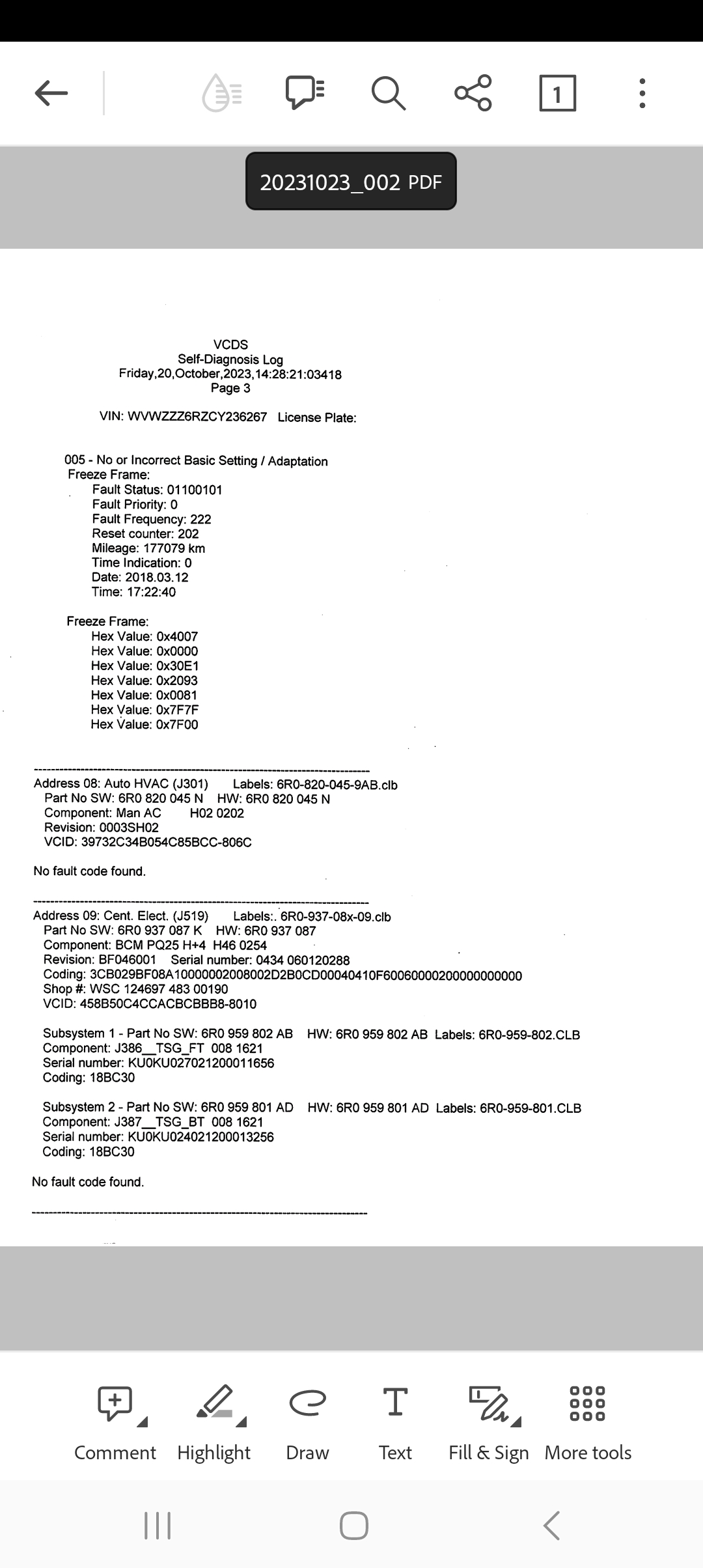

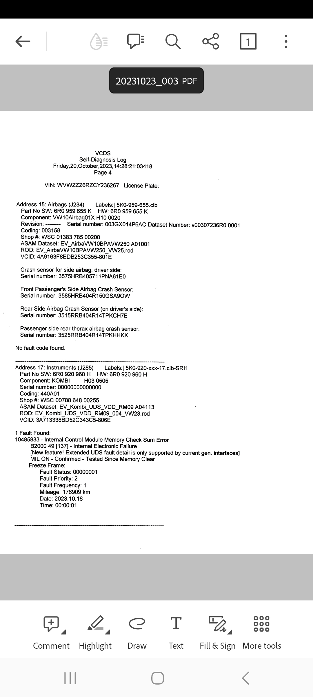

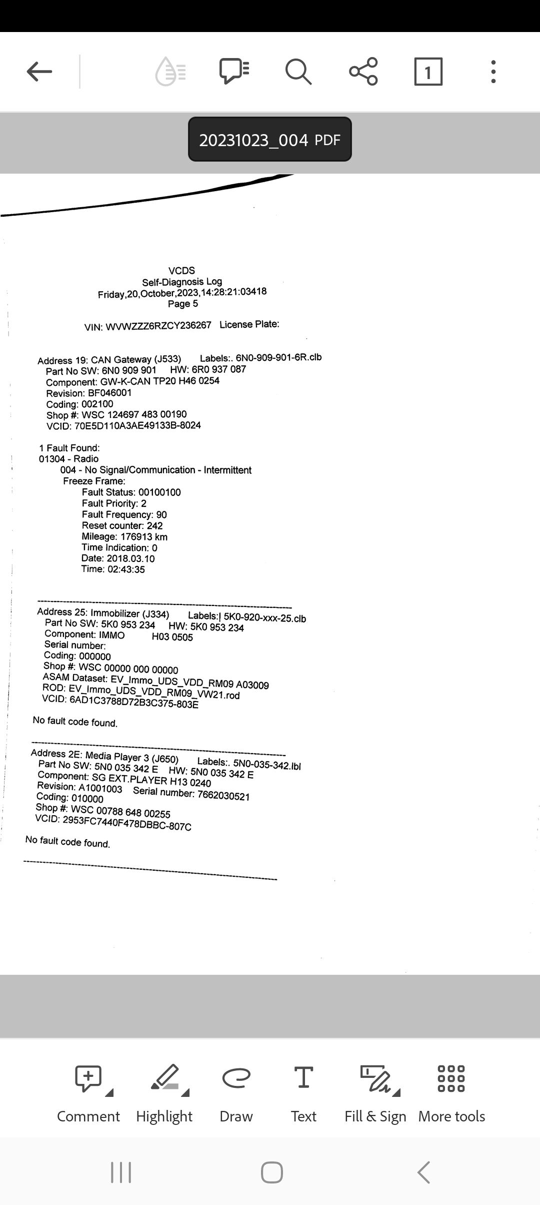

Hi
These are the vcds scans the mechanic took

Re: Polo 6R ABS CODING
I was wrong about the brake disc sizes too. They are actually 256mm at the front and a 200mm drum at the rear. So to recap it is rhd, petrol, the last 5 digits of the vin are 36267.
I really appreciate your time. Thank you
