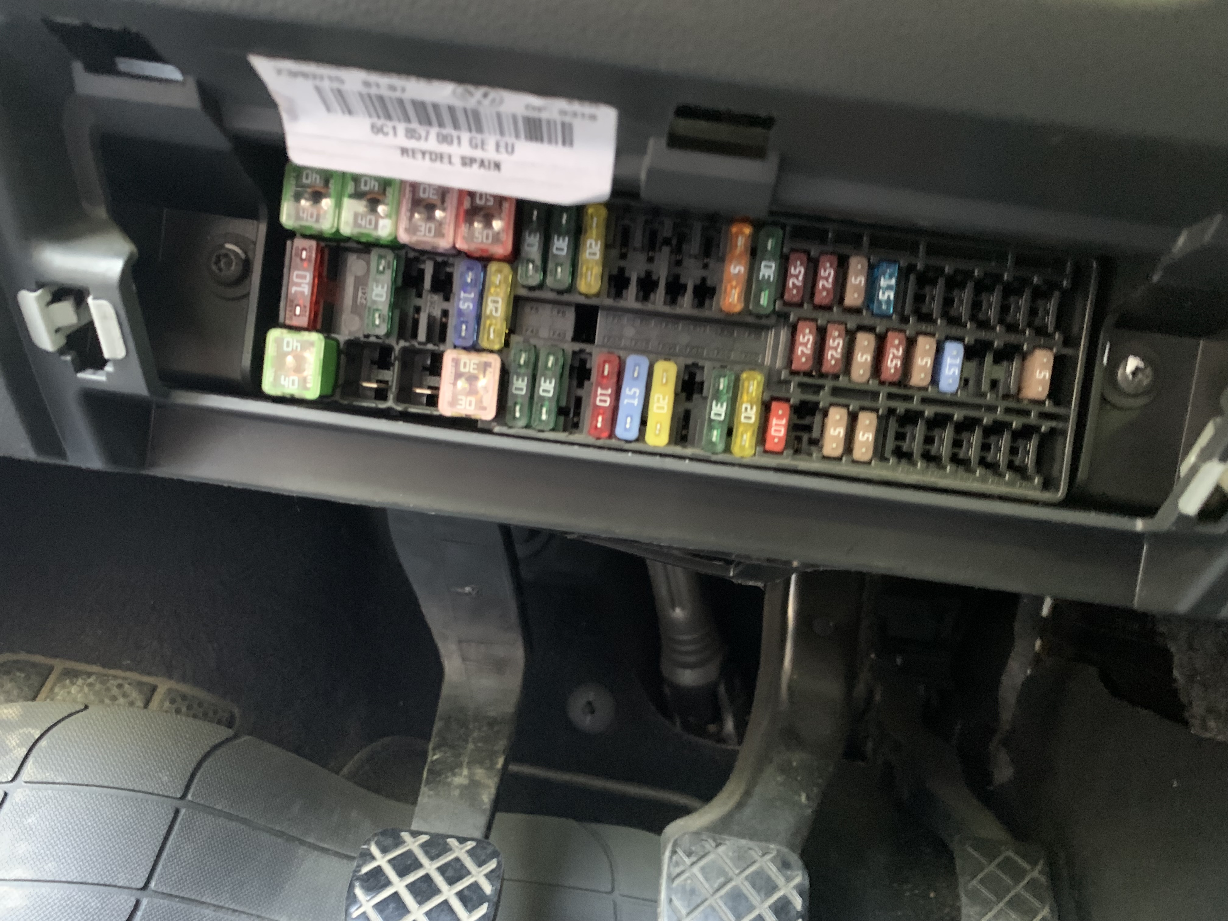

i am looking to switch the 12V (Cigarette Lighter) to always on so that i can plug in a solar panel to trickle charge the battery and i have found instructions on how to move the fuse position on some "older" fuse boxes however on my layout i cannot see such an option being available perhaps i need to switch the fuse to a different location?
Any help would be welcome to save me having to leave the bonnet (hood) open to connect directly to the battery.
Thanking you in advance
Jimmy
the model of my polo is 6c Diesel with the fuse box in the center under the steering wheel and the layout of the fusebox is as follows.
https://imgbox.com/D7JaooUT
Jimmy
- polo tdi 2015 fuse box.jpg (2.09 MiB) Viewed 39743 times
- Posts: 6695
Re: Fuse overview VW Polo 6R and 6C
Yep that's indeed true, the Polo 6C doesn't have the option to move a fuse so that the 12V socket becomes a permanent live.
You could check out the fuse diagram in the first post and see if you have any 'Terminal 30' slots free. Terminal 30 is also permanent live.
You could hook your solar panel up to that?
