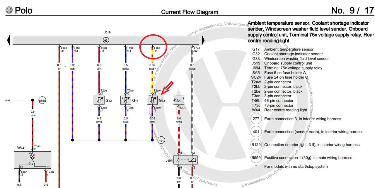

The schematic

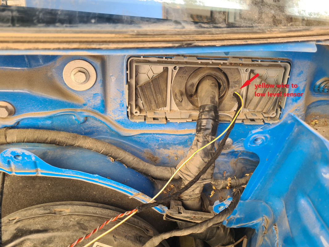

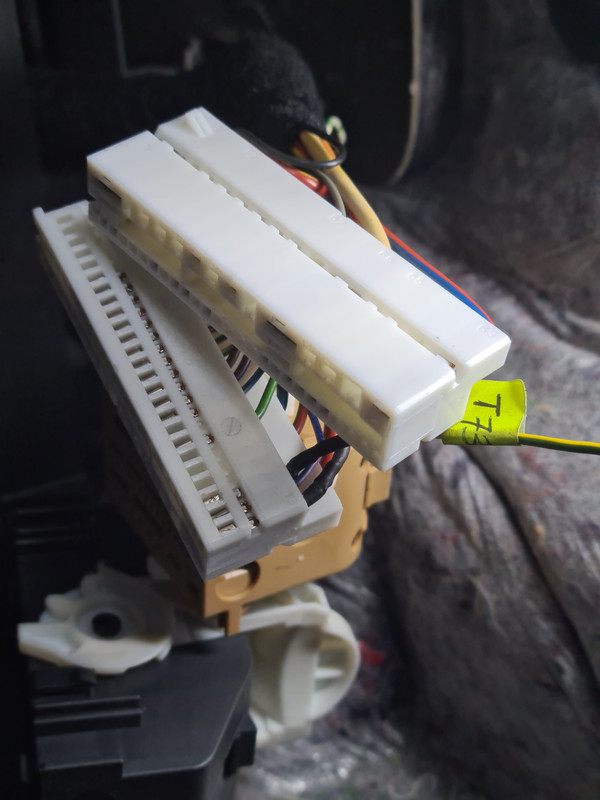

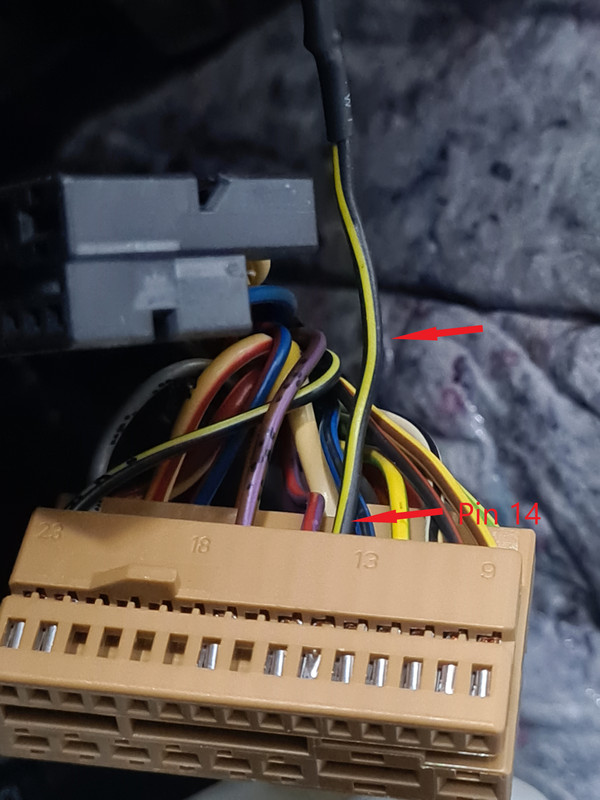

The connector:
Follow the line:

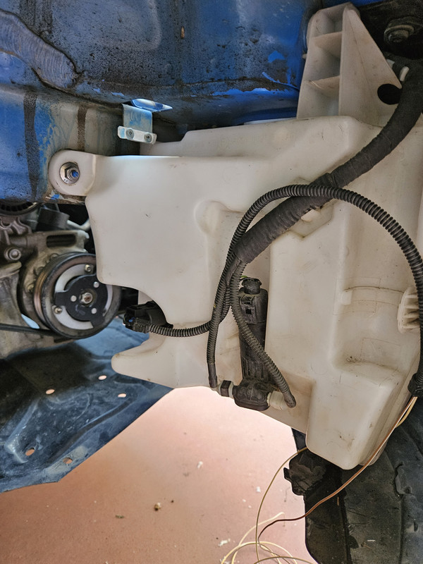

Next is the sensor installation.

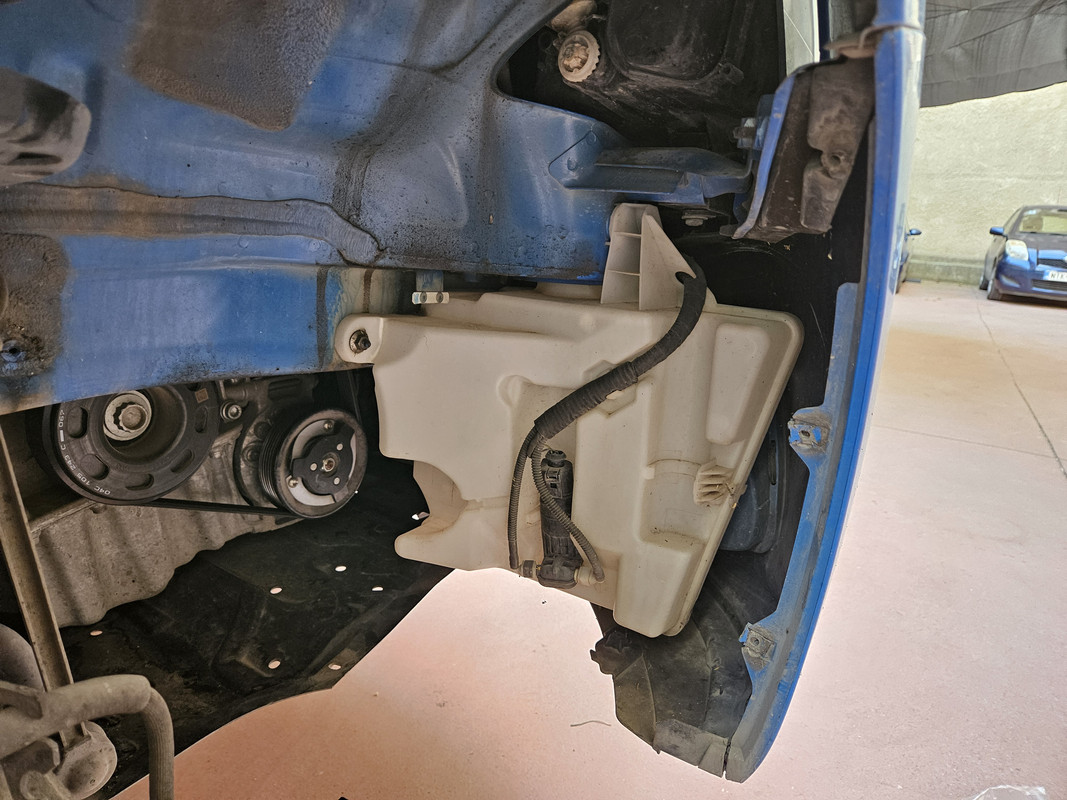

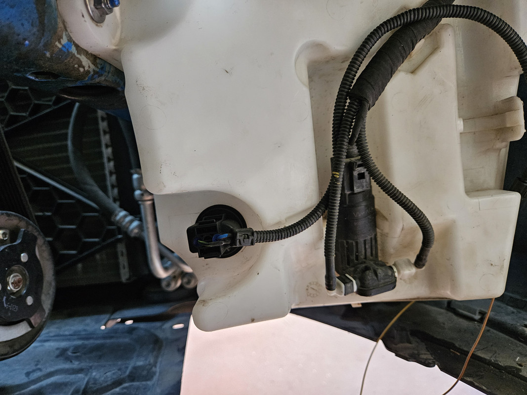

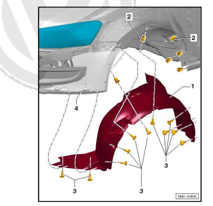

I removed the wheel housing liner (the plastic part)
Τhe water container appeared
The original position of the water sensor is to the lower left of the tank.
So I did the drilling, fixed the sensor and connected it to the wiring I had already done.
I routed the wiring and putted back in place the plastic wheel housing liner.

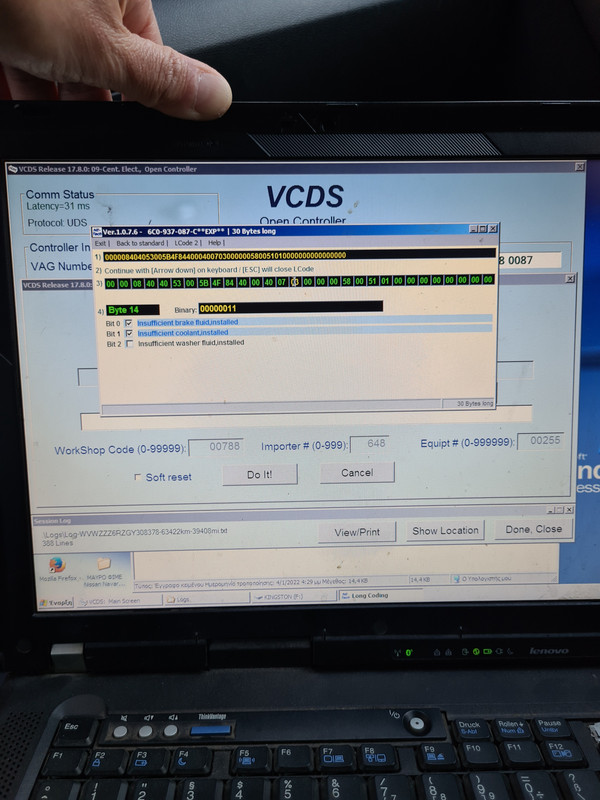

Last it was the coding, and easy one. Τhere is only one click that one has to do.
Central electronics 09
Coding, long coding
Byte 14
Bit 02, click it to set that the sensor is installed.
That's it.

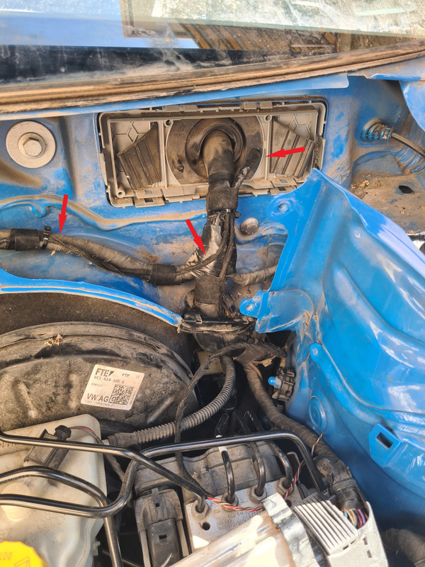

RLS "retrofit"
After about 2 years I was able to complete the installation of the light and rain sensor.

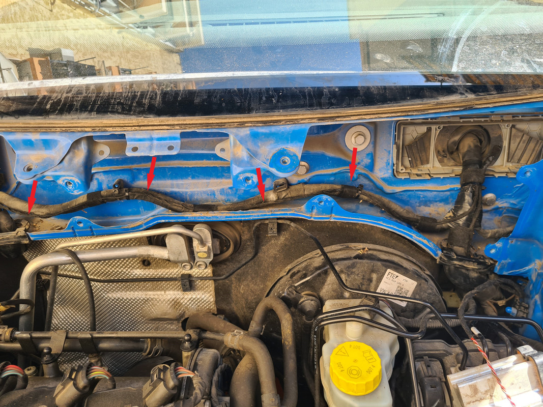

At least a year ago, I had done the wiring and installation of the wiring in the car.

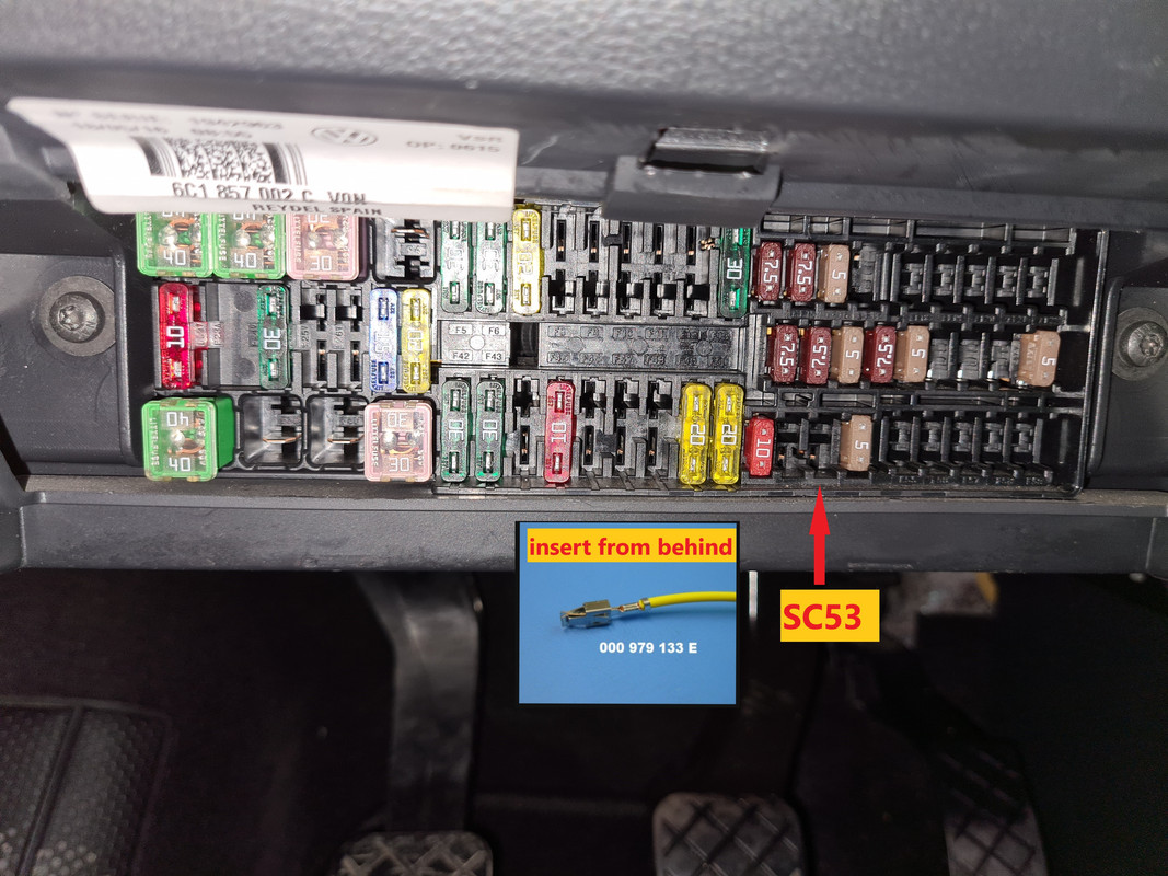

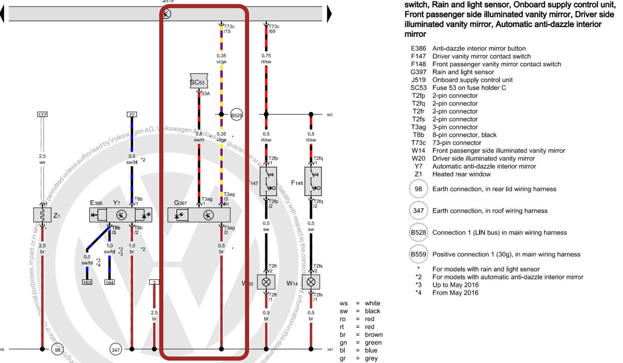

Everything was done according to the electrical diagram and from instructions I found on the internet from similar installations.
The electrical diagram.

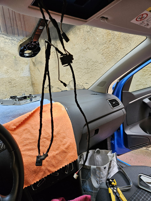

Along with wiring the sensor, I also did the wiring for the auto-dimming center mirror. And this can be seen in the same electrical diagram.
Unfortunately, I don't have any photos from the construction of the wiring, only a few from the installation of wiring.

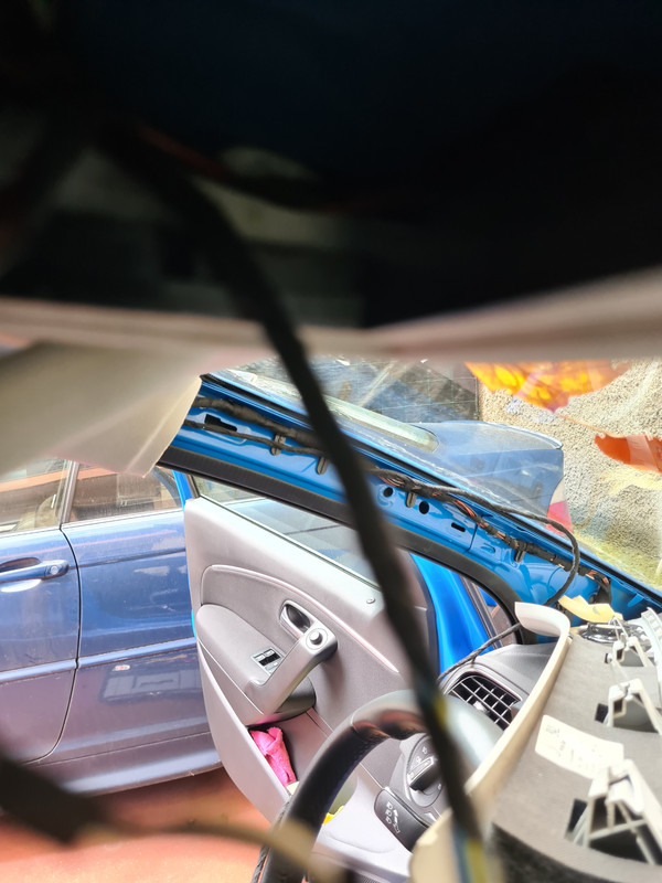

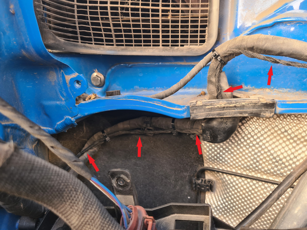

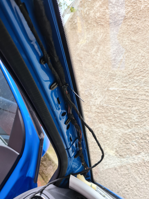

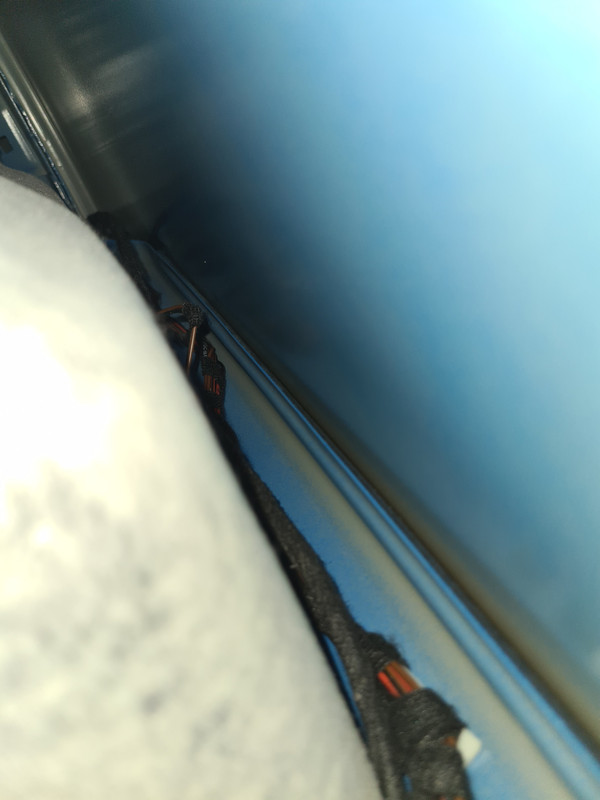

The installation included, connecting to Pin 15 of the T73c for the Lin and of course installing the SC53 fuse.

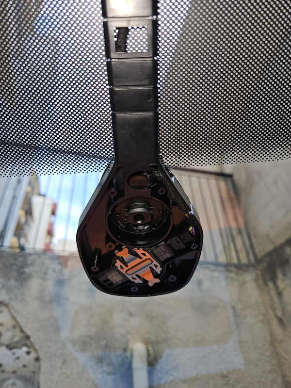

The passage of the cables was made from the left pillar (driver) to the car roof.

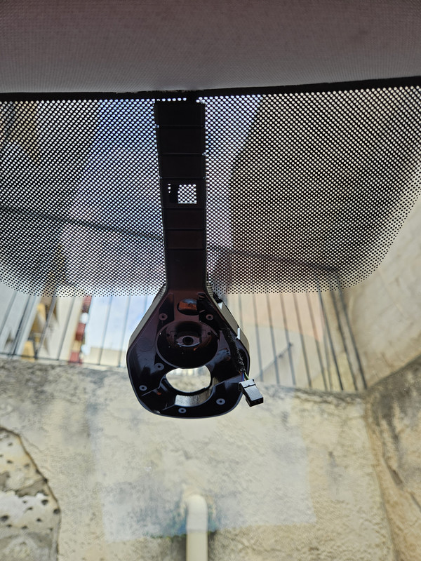

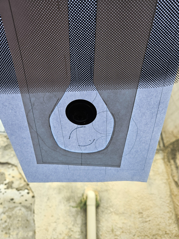

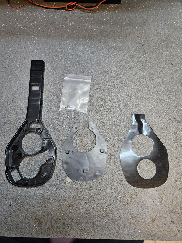

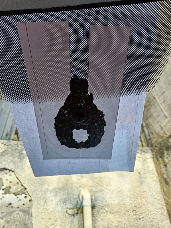

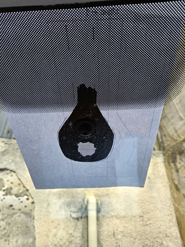

My main concern was how to fix the sensor. The most correct solution was to remove the existing simple central mirror and its base, glue a new base for the anti-glare mirror. The sensor would fit there (inside the base). I thought about it a lot, I took all the materials, (new base, mirror, primer and glue), but I never implemented it for fear of the procedure and not creating a problem with the windshield. I got instructions from the well-known Russian site.
In the end I didn't dare and looked for other solutions.

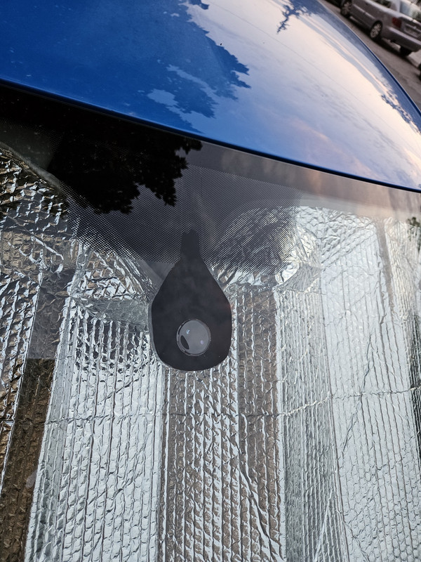

On ebay and Aliexpress I found different bases for the sensor, finally I bought this one.

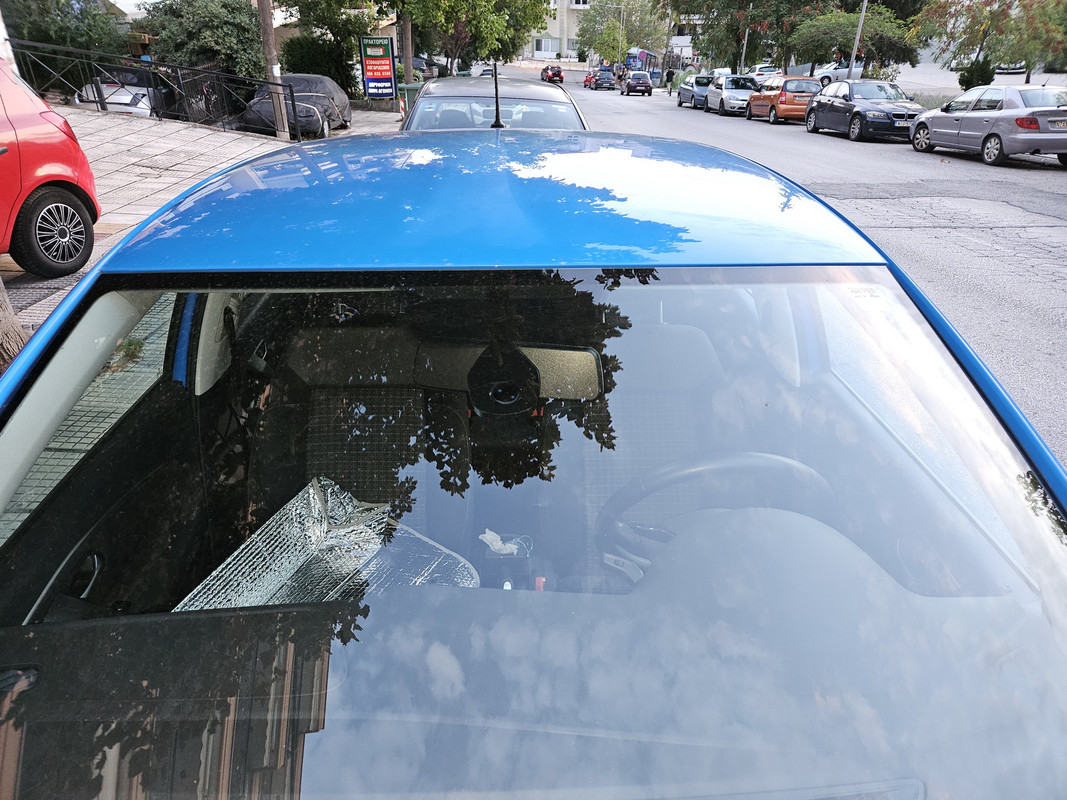

I did the tests and although it was big, it was not visible to the driver while driving, so I decided to use it and not remove the central mirror.

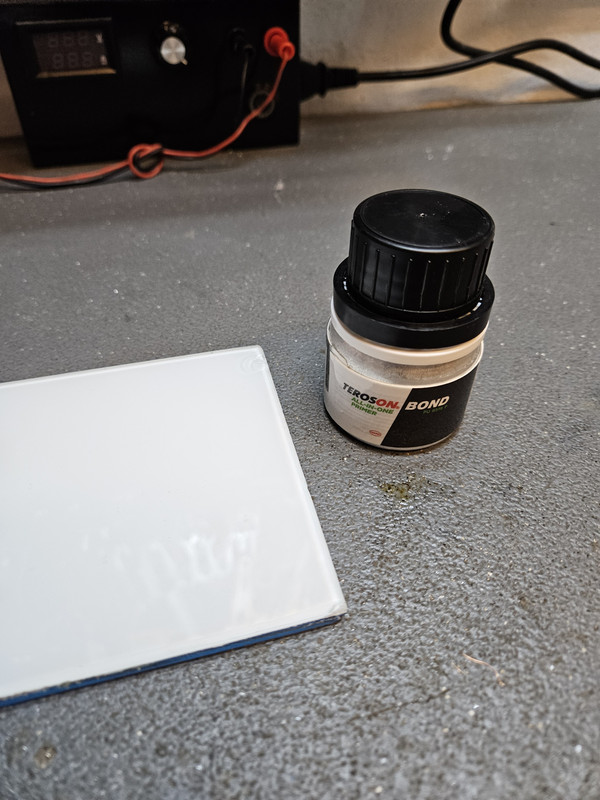

I used primer for the place that had to be glued, following Fernando's advice so that it doesn't look bad from the outside. I made a stencil and stuck it to the glass, painted with the primer and all is well.

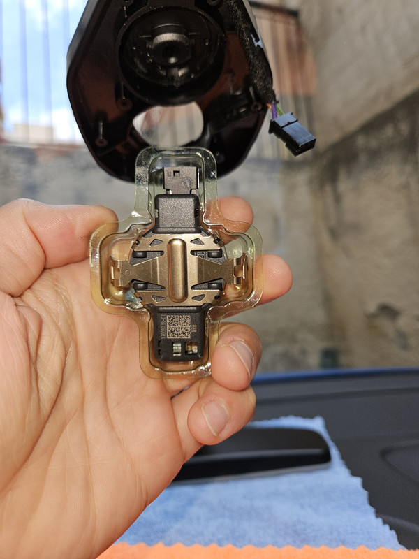

Then I glued the base and finally applied the sensor.

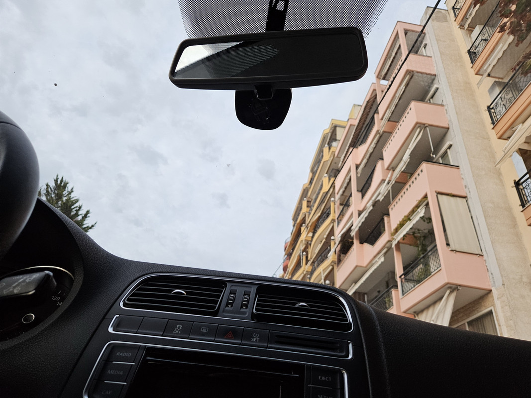

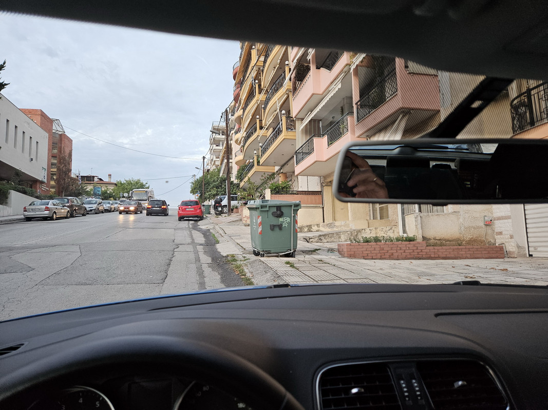

Oh, of course I also changed the rotary photo switch, with the one that also has the auto position, and this one was bought from Alixpress. The wire from position 2 to the BCM was already there, so I didn't have to do anything to it.
Then was the sensor time:
Done with the installation. After that was the setup and programming.

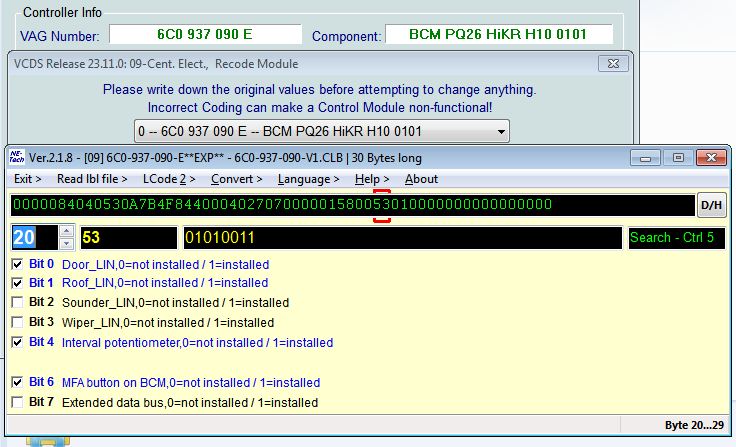

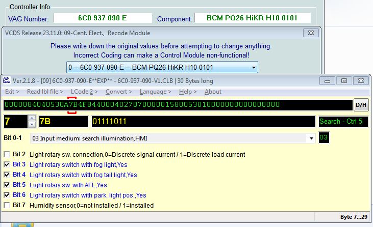

Its coding time...

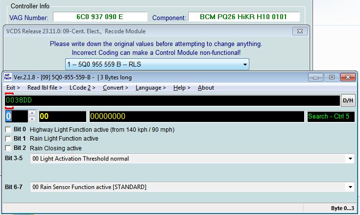

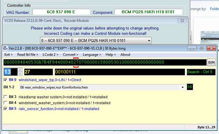

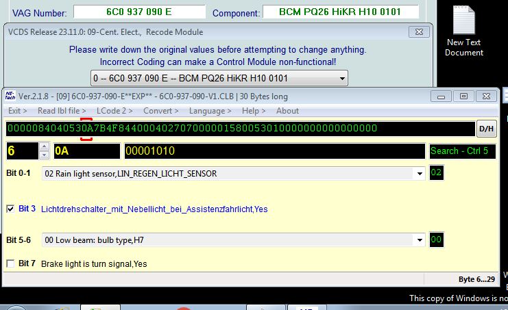

I have a VCDS cable so i follow this procedure:
BLOCK 09.
Coding, long coding. Turn on the following bits:
Byte 6, bit 1 – rain and light sensor installed on the windshield
Byte 6, bit 3 – light switch with the Auto position set to
Byte 7, bit 0 and bit 1 – the Coming/Leaving Home function is turned on
Byte 7, bit 5 – activation of the low beam control assistant
Byte 13, bit 5 — rain sensor installed
Byte 20, bit 0 — door and interior sensors connected to the LIN3 bus
Press Exit, write the coding.

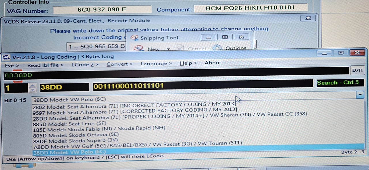

After this process, the RLS sensor appeared in the list of block 09 options. This was a good sign.
My sensor is the 5Q0 955 559B

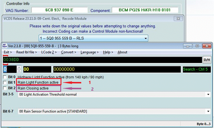

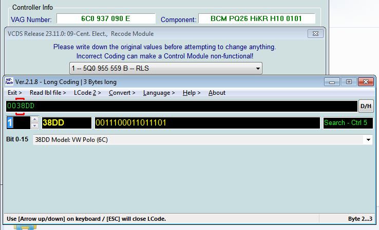

Again, coding, lond coding
Byte 0 - nothing
Byte 1 - 33DD model: VW Polo (6C)

iichel wrote: Tue Sep 03, 2024 4:24 pm i'm really curious how the mirror will look when its' finished. well done.
Some photos
This is exactly what i see when i drive the car.
From the bottom side
From the left side
From the outside of the windshield
As it seems, this position of the sensor does not disturb anything.
I am very happy with the result.
Posts: 6687
Re: Giannis20vt's Polo 6c 1.0MPI
congratulations on a good retrofit and an even better explanation. bravoooo

Thanks. I hope to help others who want to do the same without removing the mirror base (as I ended up doing).
ciclo wrote: Wed Sep 04, 2024 8:13 pm Well done. Enjoy it!
This is one of the best adaptation channels for the operation of automatic lights in countries with a Mediterranean climate:
- IDE08786-ENG115723-Assistance light functions-Assistenzfahrlicht bei Regen, active.
You will like its operation.👍
Thanks, I agree. I have already done this. Like you said, it's almost a must. And I notice that all the cars I've driven with such automatics have it.
By the way, i am curious about those bits (No1 and No2)
Any clues ?
Posts: 8868
1- Rain Light function active is the same as the adaptation channel we have talked about. In the 6R (PQ25) it is necessary to activate it in coding, in the 6C (PQ26) we see that it is activated by the channel that you already have active (like in the MQB), you do not need to activate it in coding. I have it activated in the Golf 7.5 just like you in the Adaptations and not in coding and it works perfectly.👌
2- Rain closing active, the BCM and the WRMs plus RLS (subcomponents of BCM) have to have the appropriate SW for it to work.
I made it work in the 6R but finally I have it deactivated even though the windows and mirrors close but not the central locking (fortunately).
I think there are VW models in which the central locking is also closed with this function. Now imagine that you leave the keys inside and the sprinklers in your garden make your vehicle close...🤭
For me it is not very useful, I never leave the windows open, I do not want to spend all day cleaning dust - fluff, sand, silicon crystals and other divinities - that make the perfect amalgam so that when cleaning you happily scratch those beautiful gloss black finishes.😄
...or the wonderful plastic s**t of the Instrument Panel.😁

Is it also possible to install autodimming IRVM with that custom RLS brackets you've installed?
giannis20vt
Posts: 425
Location: Greece
Post by giannis20vt »
patil wrote: Sun Sep 08, 2024 8:00 am Good job👌
the original autodimming mirror doesn't fit to this bracket. There must be another bracket for this mirror.
The only way to install the auto dimming central rearview mirror is to buy one from aliexpress or similar e-shop, based on the standard rearview mirror (not the original one).
I installed this kind of mirror to one of my previous cars and it worked fine.
