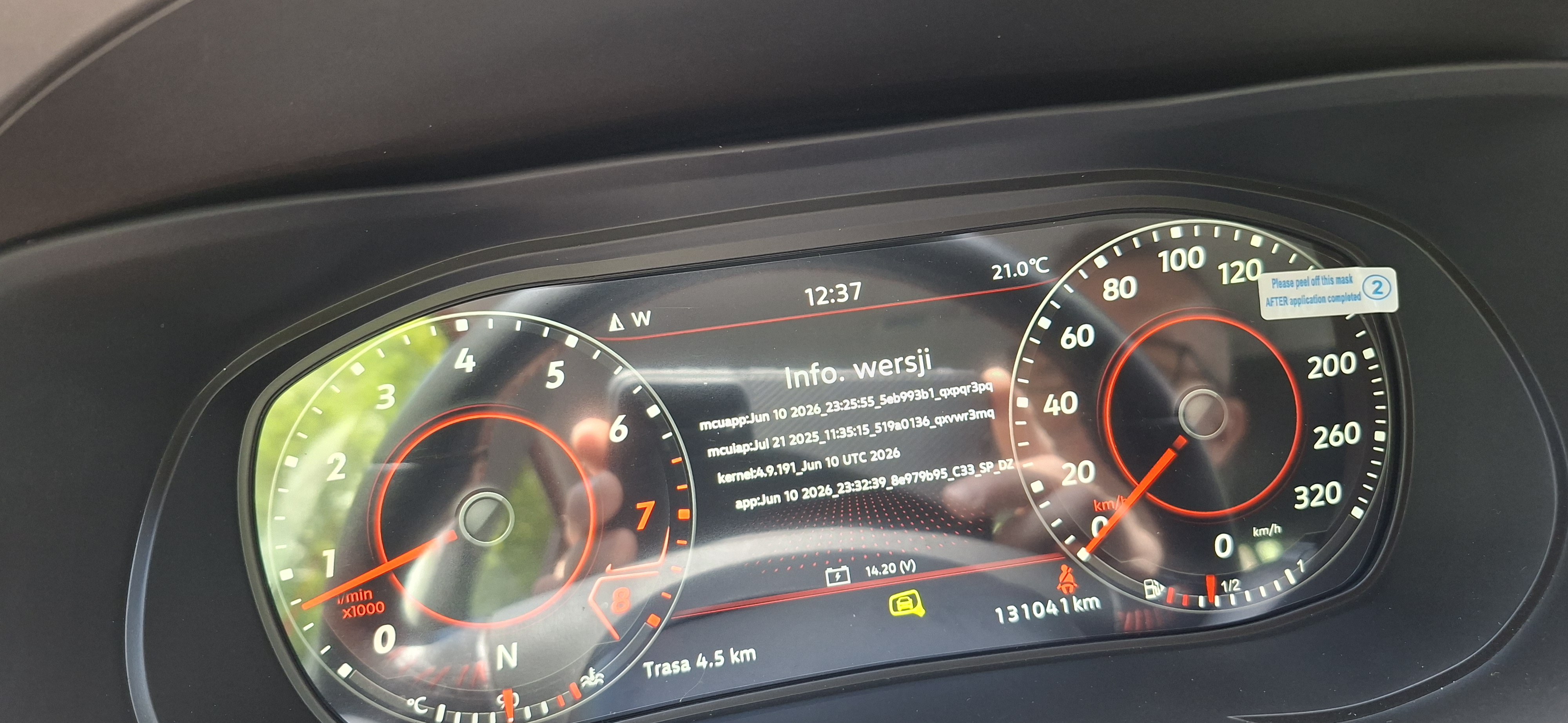

Sorry for offtopic ..I really recommend installing a digital dashboard. The effect is stunning.

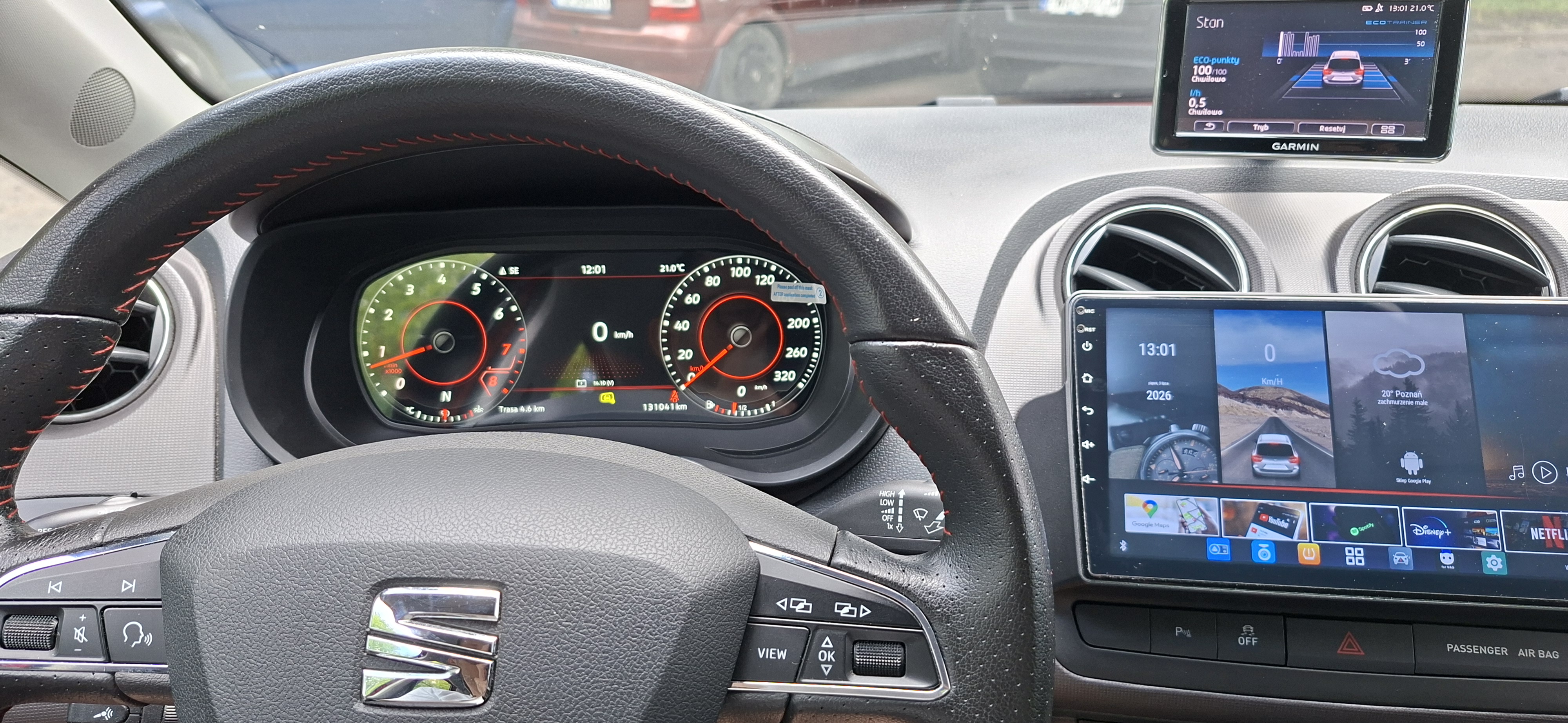

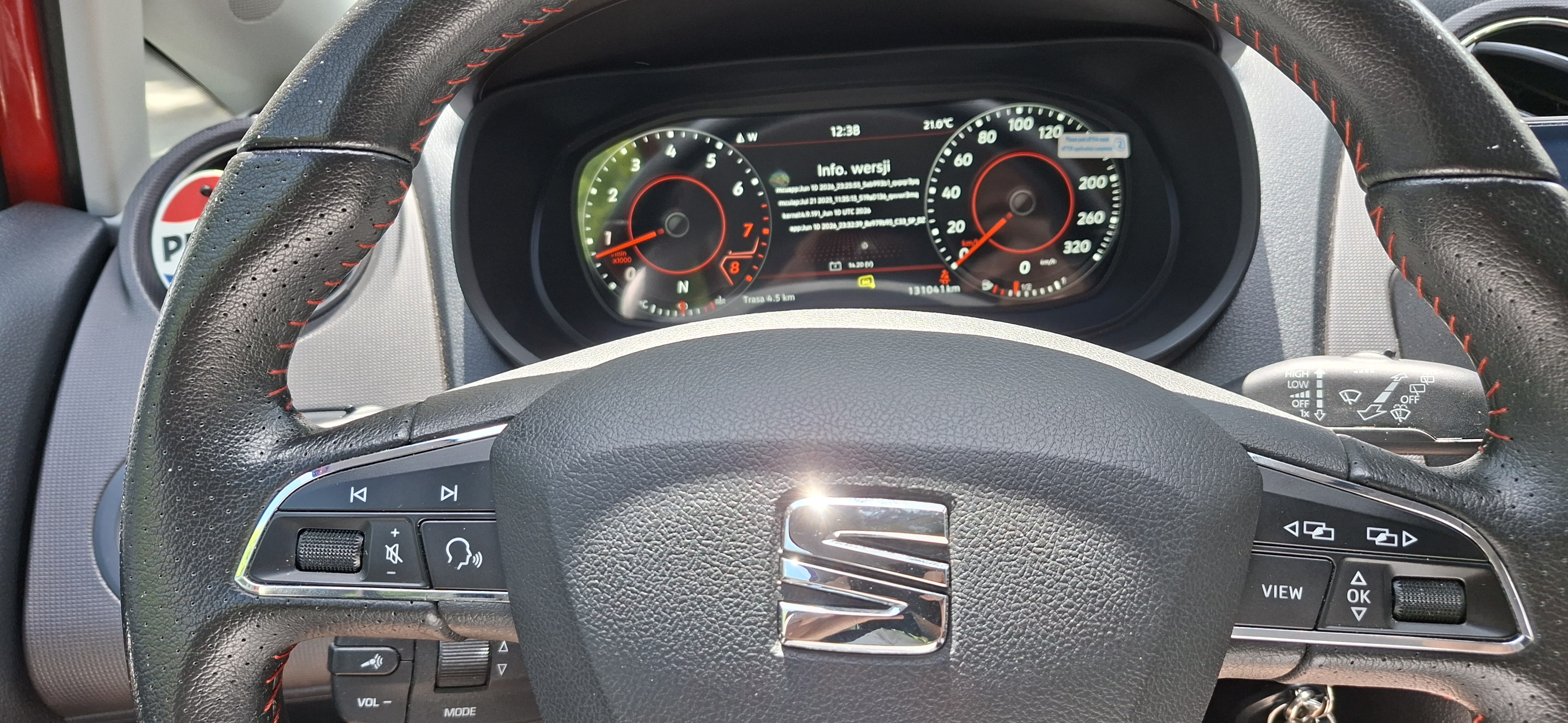

It's just a personal opinion, but I think this digital instrument cluster suits the Ibiza a bit better in terms of integration with the dashboard.

Re: POLO 6R. Digital Cockpit.😲 What do you think?
Very nice, thx for the feedback.
As alraidy said, the digital cluster looks great on the dashboard of this car but not sure on the Polo 6R/6C with a more traditional/conservative interior.

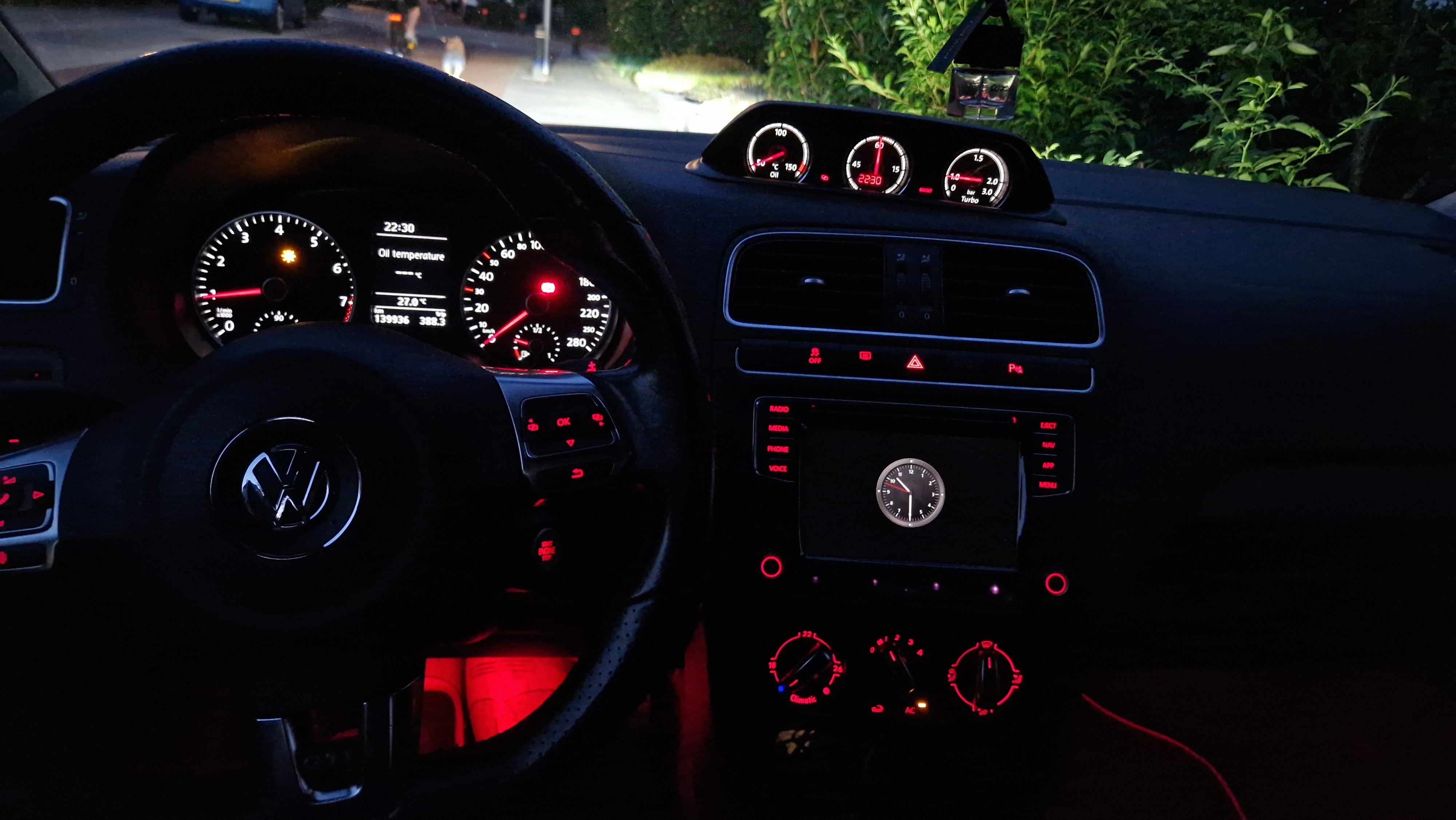

So, a little update on the AID in my Polo. It worked well for me, and I really enjoyed it. But... after my engine swap to the 2.0 TFSI EA113 (WRC Engine) my cluster went totally crazy. First with Oil Pressure messages, while the actual oil pressure was good. The OEM cluster didn't show any oil pressure warnings at all. The second thing is that from 100 km/u and above the speedometer scaling wasn't correct. It was always 5-10km/u off. And It seems it wasn't possible to adjust it. I'm not sure what caused the cluster to be so far of scaling. But it happened after my 312mm front brakes upgrade. So now I'm back to OEM cluster. I'm brainstorming to do a ColourFIS upgrade like a lot of people do in the MK4 Golf's.
