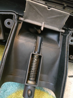

Decided to refit the warm air flap after tidying the shed and finding it. Unfortunately it disintegrated in my hands. Is it possible to get the parts (the flap, actuator rod, etc. individually)?

I managed to get hold of a used airbox off a 2005> model year Polo. The diverter was intact so I compared the two airboxes to find any differences. The later model has different ducting inside and is missing one breather union. Also, the screw-on casing for the diverter and the filter differs so I could not interchange those parts. I cannibalised the donor airbox and removed the diverter assembly (canister, rod, spring, and flap).
Before refitting I tested the canisters and found the old one is not moving at all. It looks like whatever was in it escaped as the pin easily fell out. The new canister's pin seemed to be protruding more and while it would extend (close the flap) it would not fully retract to allow more hot air for cold starting. Making the most of it I fitted the donor parts as shown below.
I'm guessing that there are quite a few older VAG vehicles driving around without the diverter working properly. The cost of a new airbox assembly is prohibitive. I wonder if it might be possible to obtain a suitable replacement canister separately.
Will monitor engine performance, hot starting problem, and fuel consumption to see if this half-way fix has made any difference.

Just a quick update on the outcome since fitting a working flap valve. Basically, the hot starting problem seems to have cleared. Strictly speaking I'm not sure the flap valve is working across 100% of the range of operation, but it's certainly diverting much less warm air to the intake when the engine is hot. Although we are in a cooler season the hot starting symptoms were present year round. So far so good. I cannot determine any effects on mpg at present due to the front o/s brakes binding slightly.
As for the pinking problem, this also seems to have all but cleared. Again we are in a cooler season but pinking was present year round depending on conditions (obviously much more pronounced in the warmer season). I had been using Tesco Momentum to improve the drive and this considerably reduced pinking. The last several tankfuls were plain supermarket fuel and since I've replaced the flap valve have not noticed any pinking. The real test will be in the warmer season.
For those with pinking problems, whilst a faulty oil separator could introduce problems with the mixture if you've not found any problems in that area it might be worth checking out operation of the engine cover flap valve.
