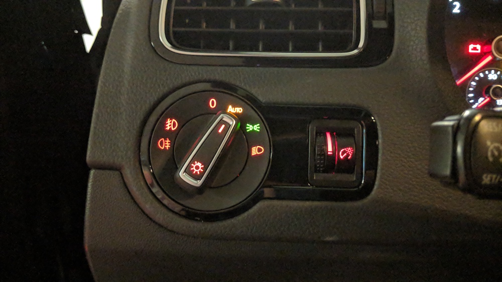

After fitting the Polo 6C dash, I've also completed the rest of the mod.
Dimmer 1C0 (3C0 wasn't working well enough)
Light switch modified. I took a 5G0 light switch and took out the PCB. I replaced the PCB with one from a Golf 6 and now all is well.
- Posts: 8912
Re: iichels Polo 6R 1.2TDI Rosa Line Bluemotion
Looks like good.
With 5G0 you can use the fog lights in Auto position, is it also possible with your modified light switch?
Have you installed a new engine? ...
Why is the key not found?
- Posts: 6689
good one, didn't try that before. no the fog lights will not work in the auto position. that's a bummer.
what do you mean with different engine?
the key is the kessy key not in range of the antenna.
I checked the lights before, it was probably complaining because i left the car with the keys in my pocket.
The car usually starts complaining when you're already back in the car...
