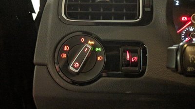

After fitting the Polo 6C dash, I've also completed the rest of the mod.
Dimmer 1C0 (3C0 wasn't working well enough)
Light switch modified. I took a 5G0 light switch and took out the PCB. I replaced the PCB with one from a Golf 6 and now all is well.

Looks like good.
With 5G0 you can use the fog lights in Auto position, is it also possible with your modified light switch?

by iichel
good one, didn't try that before. no the fog lights will not work in the auto position. that's a bummer.
