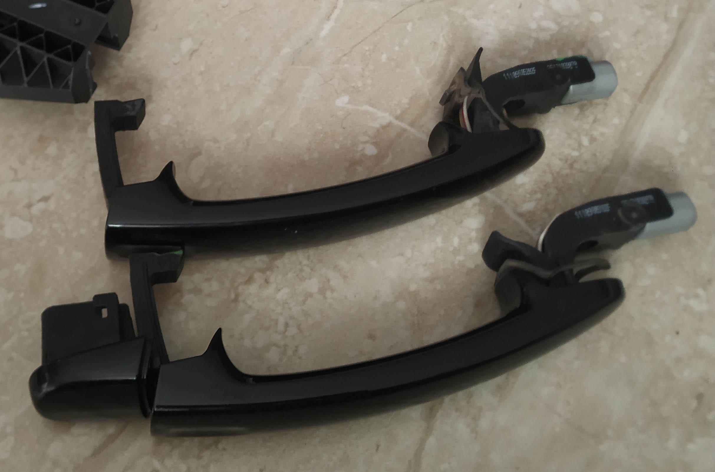

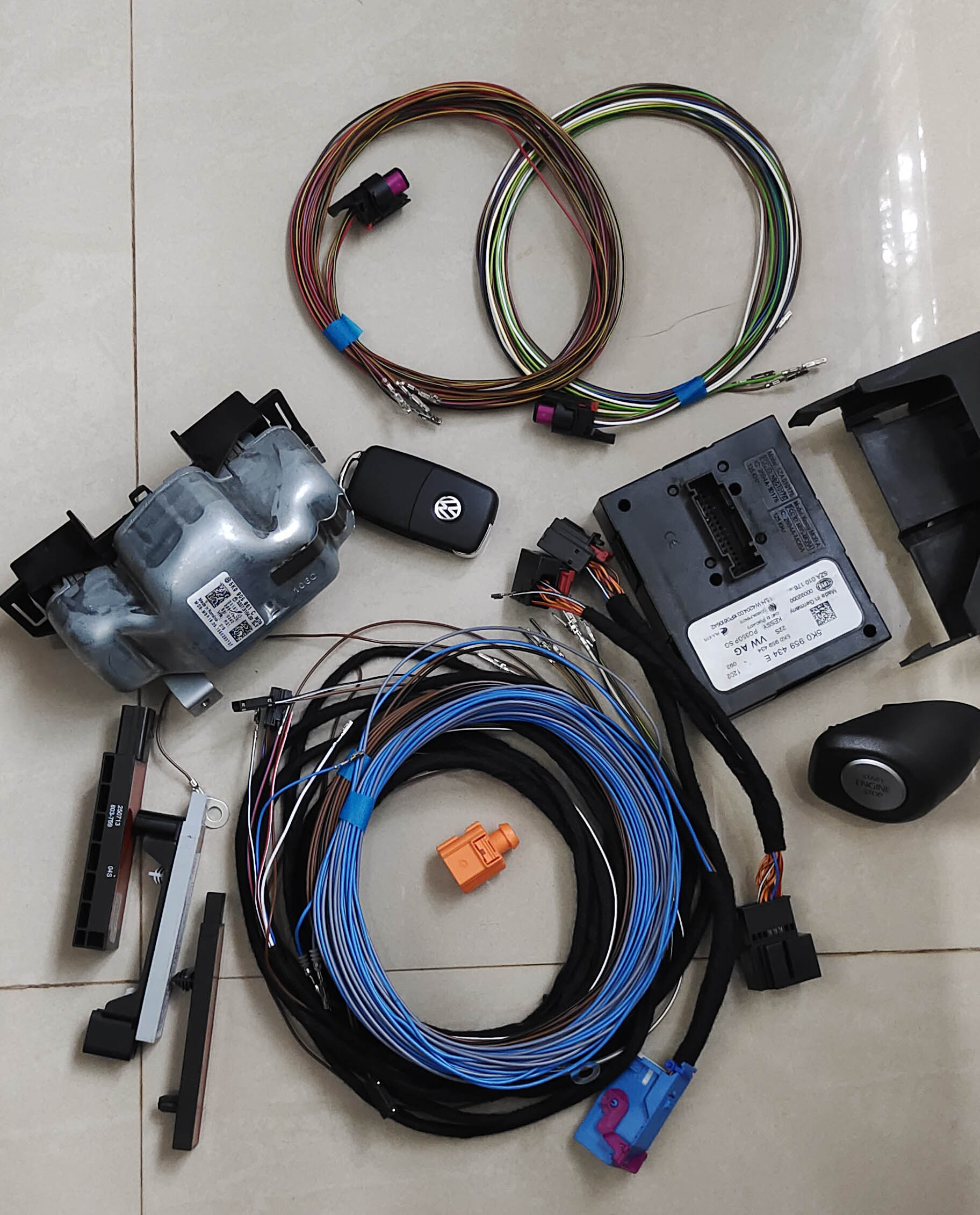

KESSY retrofit on 6R Vento
- IMG_20210130_094202.jpg (158.27 KiB) Viewed 9343 times
- KESSY KIT, door handle given for paint
- IMG_20210611_170643.jpg (388.4 KiB) Viewed 9343 times

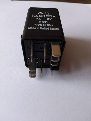

Is this the relay?iichel wrote: Fri Jun 11, 2021 3:08 pm Yes, it is needed to convert some of the input and output logic. Without converter box, it won't work. I tried![]()
- download.jpg (3.4 KiB) Viewed 9340 times
- D_NQ_NP_693498-MLM40764858012_022020-O.jpg (33.26 KiB) Viewed 9340 times
