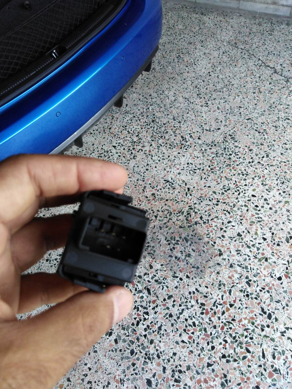

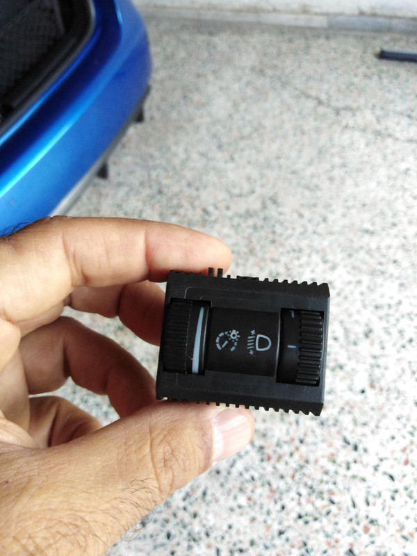

This dimmer was a gift from an O2 pq 35 who install autolights and oem xenons BUT I have this above
do you recognise it ?it is from polo 6r red lightning
can we do something with it?

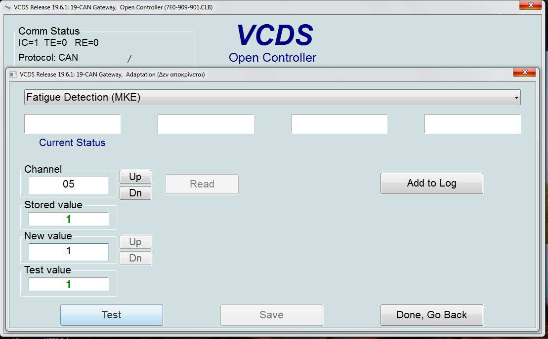

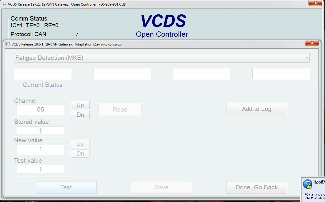

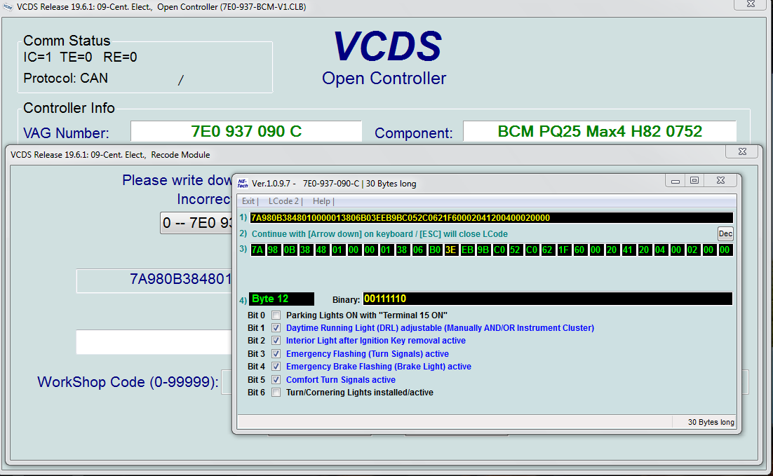

ADL? CORNER LIGHT ACTIVATION? MKE ?
Post by VASILEIOS1972 »
Good morning Fernando and have a good month!
I search enough to find that Fabia mk2 RS do not ever produced with oem xenon .
So I have some questions about the images above
1) ADL, what is new now in my headlights?
2)Corner light activation , my car has in the place of fog lights led daylights .
Is this the problem that I do not have corner light function or need to check the bytes above?
3)MKE activation . I do not have assistant menu in mfd of my instrument cluster .
When i went in adaptation menu and doing test , the procedure do not begin .
See the screenshots above
from a previous thread i saw a skoda cluster none RS model with this function working
aadriver picture
viewtopic.php?f=56&t=58703&start=4710#p557797
if it something with the sw of the cluster the local dealer could not help because the car is not produced any more .
Can any body help me find this file , because i have vcp to upload this upgraded sw.
Best regards
V

VASILEIOS1972 wrote: Sat Aug 31, 2019 10:31 am do you recognise it ?it is from polo 6r red lightning
1st.
Does 6R Dimmer fit correctly in your SK fabia?
2nd.
Have you checked that the 6R headlights range regulator works correctly for your current headlights?

ciclo wrote: Sun Sep 01, 2019 9:04 am
1st.
2nd.
answers
1) yes 6r dimmer fit correct in dash oem hole
2) I do not know because Fabia has T8 plug (8 pin) and Polo T6 plug (5-6 pin)
Posts: 8865
Re: ADL? CORNER LIGHT ACTIVATION? MKE ?
VASILEIOS1972 wrote: Sun Sep 01, 2019 8:31 am Good morning Fernando and have a good month!
aadriver picture
Best regards
V
1
Automatic lights, which is different from the CH/LH functions.
You can leave the light switch on AUTO forever until you need to activate the rear fog.
The lights will turn on automatically just when they are needed
2
Your Fabia does not have cornering lights, you need to install the headlights with the cornering function and the module that manages them. (check the Elsawin, ETKA).
3
As I told you by pm, you need to update your IC software for the MKE to work.
DO NOT touch anything on the GW adaptation channels.
I will ask for the IC SW that aadriver has installed in his Fabia. (I think I remember that he is also a user of this forum) memberlist.php?mode=viewprofile&u=26584

VASILEIOS1972 wrote: Sun Sep 01, 2019 9:10 am
T6 connector
JPT https://www.a4-freunde.com/attachment.p ... 1416146148
https://www.a4-freunde.com/showwiki.php ... uebersicht
Posts: 8865
Re: Auto lights retrofit
For your Dimmer tests.
From T8 to T6
T8/1 to T6/4 ... +15
T8/2 to T6/2 ... G
T8/3,4,7 to T6/1 ... ground
T8/5 blue/black wire to T6/5 ... 58d OUT
T8/6 black wire to T6/3 ... 58 IN
T8/8 ... isolate

ciclo wrote: Sun Sep 01, 2019 12:25 pm For your Dimmer tests.
From T8 to T6
T8/2 to T6/2 ... G
T8/8 ... isolate
Keep in mind that everything you do is under your responsibility.
The tests can be done with wires with crocodile clips to return to the original state if you can't get the 6R Dimmer to work.
BCM coding needed.
Hello Fernando , you are the expert, so it is fair for me and for you to prepare a wiring from T8 to T6 connector and fuse box , to make the tests plus new bcm coding.
For all those my friend, name the price to continue the project to end with complete success .
Best regards
Vasilis

It is possible but:
- You have to wait until the last week of September for me to manufacture this adapter wiring for your TESTS (or fully functional if the tests are successful).
- Unfortunately, an original female connector is not manufactured for your current male T8 dimmer connector (ETKA), so we will use a T10 male and female connectors. It involves transferring the wires from the current male T8 dimmer connector to the new male T10 connector (with the same correspondence in the slots to transfer the wires from T8 -> T10). After transfering the wires, the new adapter wiring (T10 <-> T6) will be Plug & Play to do the TESTS.
- The original connectors are not cheap, so I estimate that the final cost with shipping (€ 10) will be between 30 and 40 euros.
I will send you 4 or 5 MQS terminals for you to crimp 2 of them in the blue/black and black wires with the ENGINEER crimper.
Do you agree with the above?
