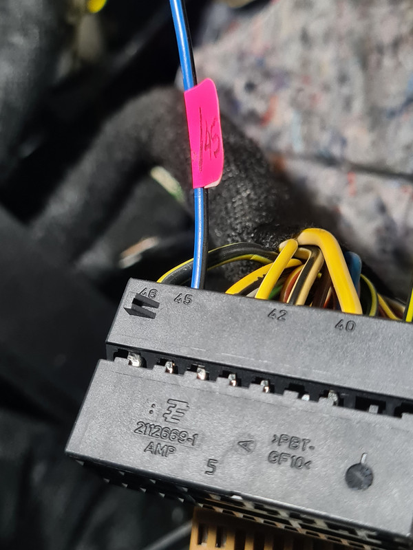

Footwell lights + ambient lights simultaneously
I had a thought. When i finish the footwell installation to my Golf [link here viewtopic.php?t=78237] i started thinking. I wanted to do the same think to my Polo
if there was a corresponding pin on the Polo BCM I could program it properly. I started searching and came across this topic. https://wirer.sk/led_nohy/
This quy have done the same think. As a matter of act, his car had the same BCM with mine.
T46b/45 is the possible Pin for positive.
At the adaptation channel this pin represented by : Leuchte10SHUTTER LRB45
It is for the XENON lights, i don't have such lights, so this is an opportunity.
I have already installed footwell lights. I have connected them to the ceiling light.
Lets get started
The right Pin for the T46b/45 position, is : 000 979 150 E
Negative to Ground.
I've come this far, programming and testing remains.

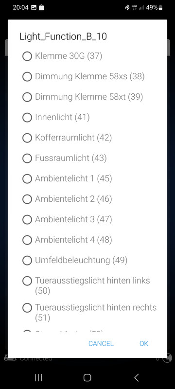

I wonder if there is a way to adjust the brightness through the infotainment screen (with a virtual slide bar as is done in the case of the Golf)
I have a screenshot from OBDeleven, there are some alternative choices for the lightning.
Any thoughts ?
Any thoughts ?

I did some tests
Fussraumlicht (in English foot room light).
Works like the Innenlicht (the lights shine when one door opens)
Ambientelicht 1
Ambientelicht 2
Nothing works. I even tried to coding the module
Module 09 – Central Electronics
Coding 07 – Long Coding Calculator
Byte 17 – Bit 0 Ambient lighting (from 0 to 1)
No result.
This guy https://www.drive2.ru/l/479323024231760456 wrote that it worked when he coded like this:
I don't know. I keep looking.

ENG124867-ENG115110-Leuchte6ABL LB44-Type_Of_Load_6 Xenon Abblendlicht
Should i change the "Type_Of_Load_6" from XENON Abblendlicht to "allgemeine LED" ? [lasttyp]
And the Dimming_AB_6 from 100 to 127 ?
Has this adaptation more brightness from the original one ?
- Posts: 6689
Re: Giannis20vt's Polo 6c 1.0MPI
yes, exactly as you describe, that's fine. sometimes it takes some experimenting to see what type of load you exactly need. but looks OK to me.
setting dimming to 127 can prevent flickering of your LED lights.

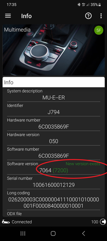

The infotainment system has been changed
From the 6C0035888B (composition touch)
To the 6C0035869F (composition color)
Of course with the help of the Online GECO connection.
Same "type" of hardware (one unit), all other alternatives require 2 units, one in the glove box and one in the center console.
Small differences, the most visible is the color screen for the Composition Color.
And the autoscan.
I kept the same coding. No errors, after some adaptations.
From ODBeleven
It says there is a new software. Any suggestions about that ? Where can I find the software update?
From ODBeleven
