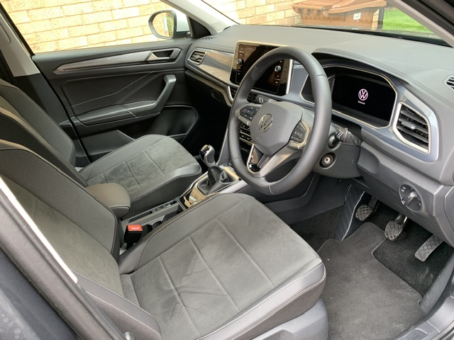

I had a 1.0 litre 6 speed manual T-Roc Style as a courtesy car. I quite liked it; the higher up driving position was quite nice and the alcantara seats were more comfy than the seats in my GTI+. The big downside for me was the lacklustre performance from a 1.0 litre engine (I think it was the 110ps version) in quite a heavy car. It was also not much better than my GTI+ on fuel economy either; that’s the penalty of a small engine having to work hard in a larger, heavier car than my Polo GTI+. It would have been nice if I’d had a T-Roc R for the day, although that would be wishful thinking!
Here’s the T-Roc;

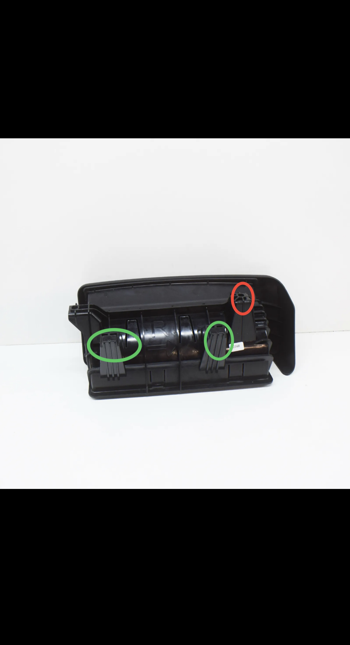

Teee wrote: Thu Feb 11, 2021 5:05 pm Today I installed a under seat storage box it’s originally from a Audi a1 or seat Arona & possibly other cars. after a bit of digging around I came to realise the metal structures/skeleton under the seats on these cars are the same but the foam cushions are different. The box is Probably not as big as I’d like but it’s better then nothing. Overall I’m happy to have extra storage to keep things out of site.
Hi Tee,
Just read this. What model of Polo do you have?
Interested to see if this will fit my GTI AW pre facelift.
Was it an easy fit?
Images below are from car wows review of the seat arona.
Part numbers:
Storage box : 81A8826024PK
Speed nut : N90088003 (x2 pcs)
Oval Hexagon Socket Head Bolt : N90737101 (x2 pcs)
I have spare nuts(8) and bolts(8) as it worked out cheaper to buy as a pack of 10 so if anyone is interested in doing this retrofit pm me I’ll send them out for free as I have no use for them. (Uk only)

I have a polo gti + 2019 & fitting was pretty straightforward only part that was a bit fiddly was one of the bolts isn’t easy to access, I’ve circled it in red in the picture below. The area circled in green just hook on underneath the seat. Hope this is some help all the best.
