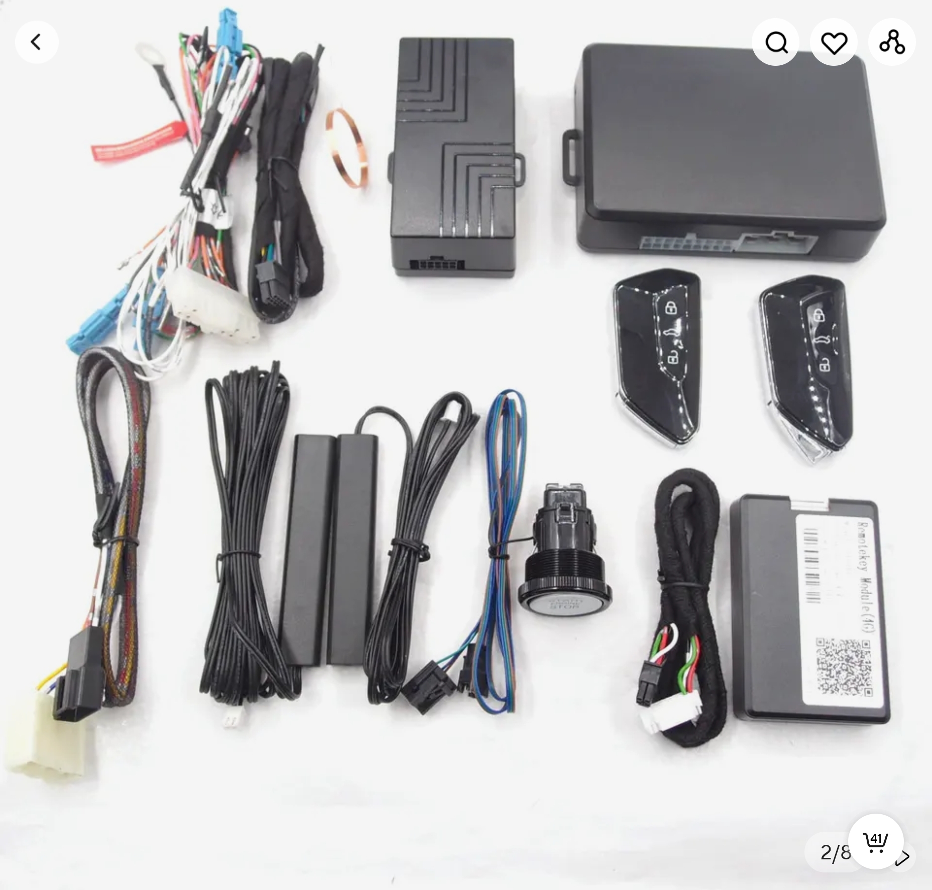

Hi guys I was looking around to retrofit push start system and i found 1 kit on aliexpress. Just wanted to know should i give it a shot? Has anyone done this before? The seller says i need to just solder me old remote key to his module and connect loc/unlock wire and brake line connector to make it work. A little skeptical about it. I have polo 2021 Gt tsi 6r.
Thanks in advance
Thanks in advance
