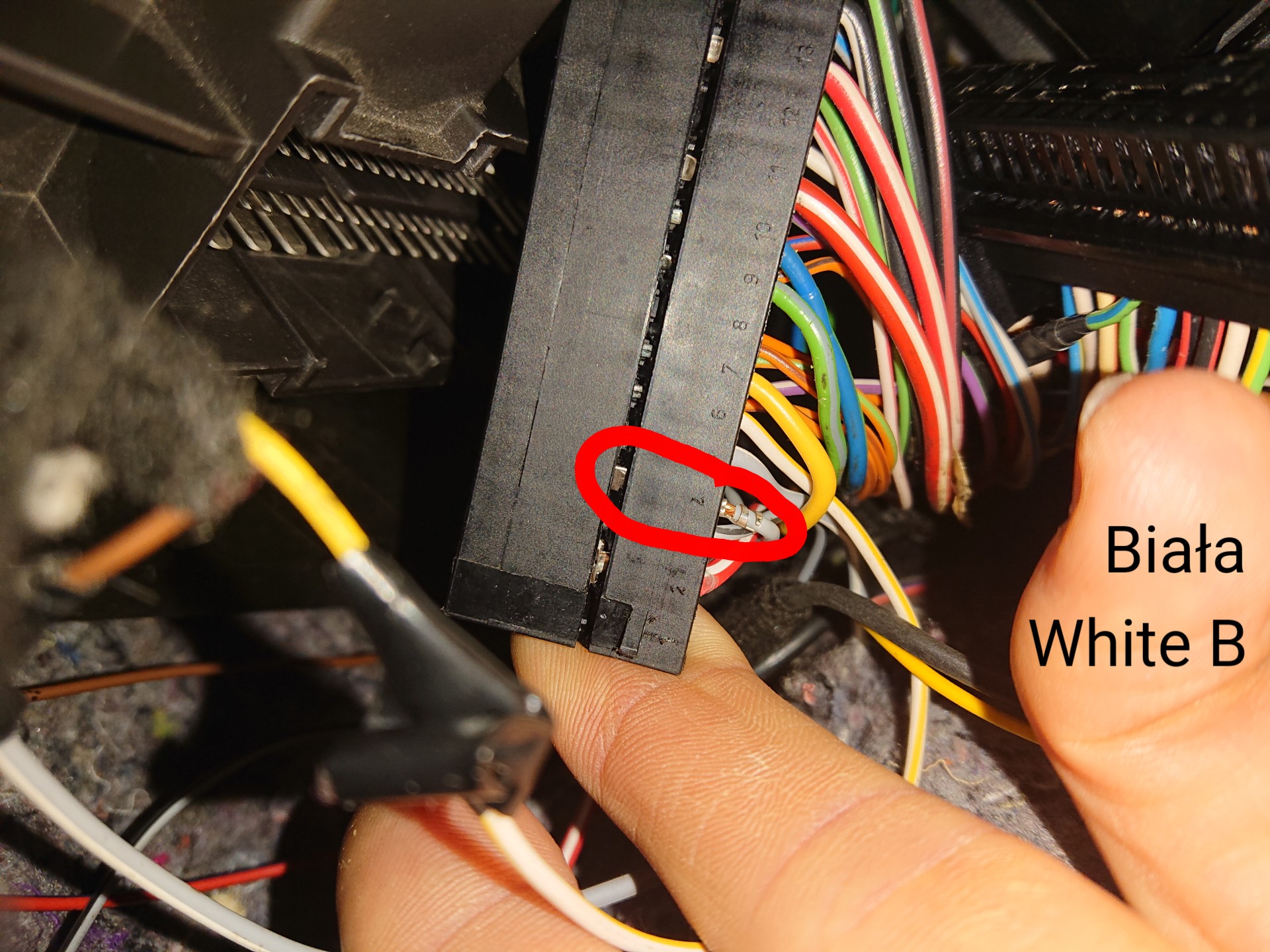

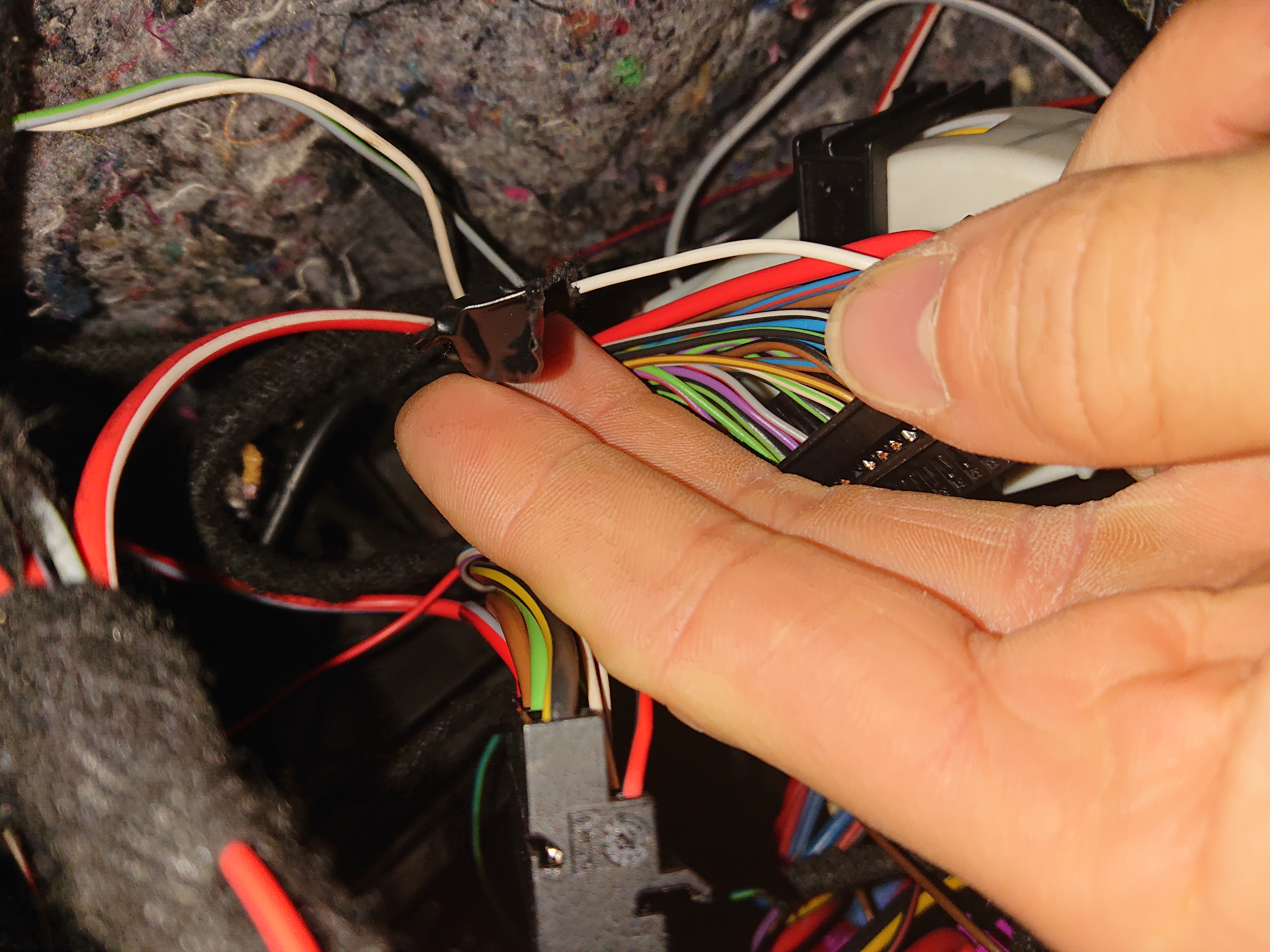

- I have the impression that the cable is not properly, If it is a cable from interior lighting, it should not be in pin1?

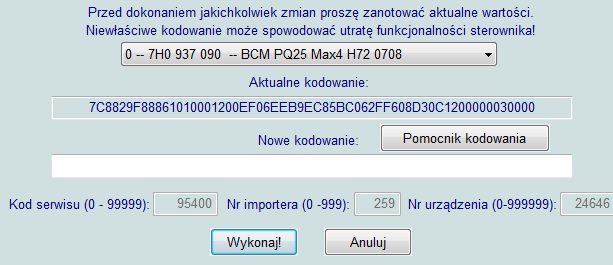

- New Coding
- New Coding.jpg (54.79 KiB) Viewed 5386 times
- Posts: 8989
It does not mean that, now we are trying to find out if there is a problem in the electrical installation.
Let me check it out, I'll post a new BCM coding soon/tomorrow for another test.
Thank you very much for the video, very good idea!!
For me it is better that you post the BCM coding as text and not as an image, it makes my job easier. Thanks.

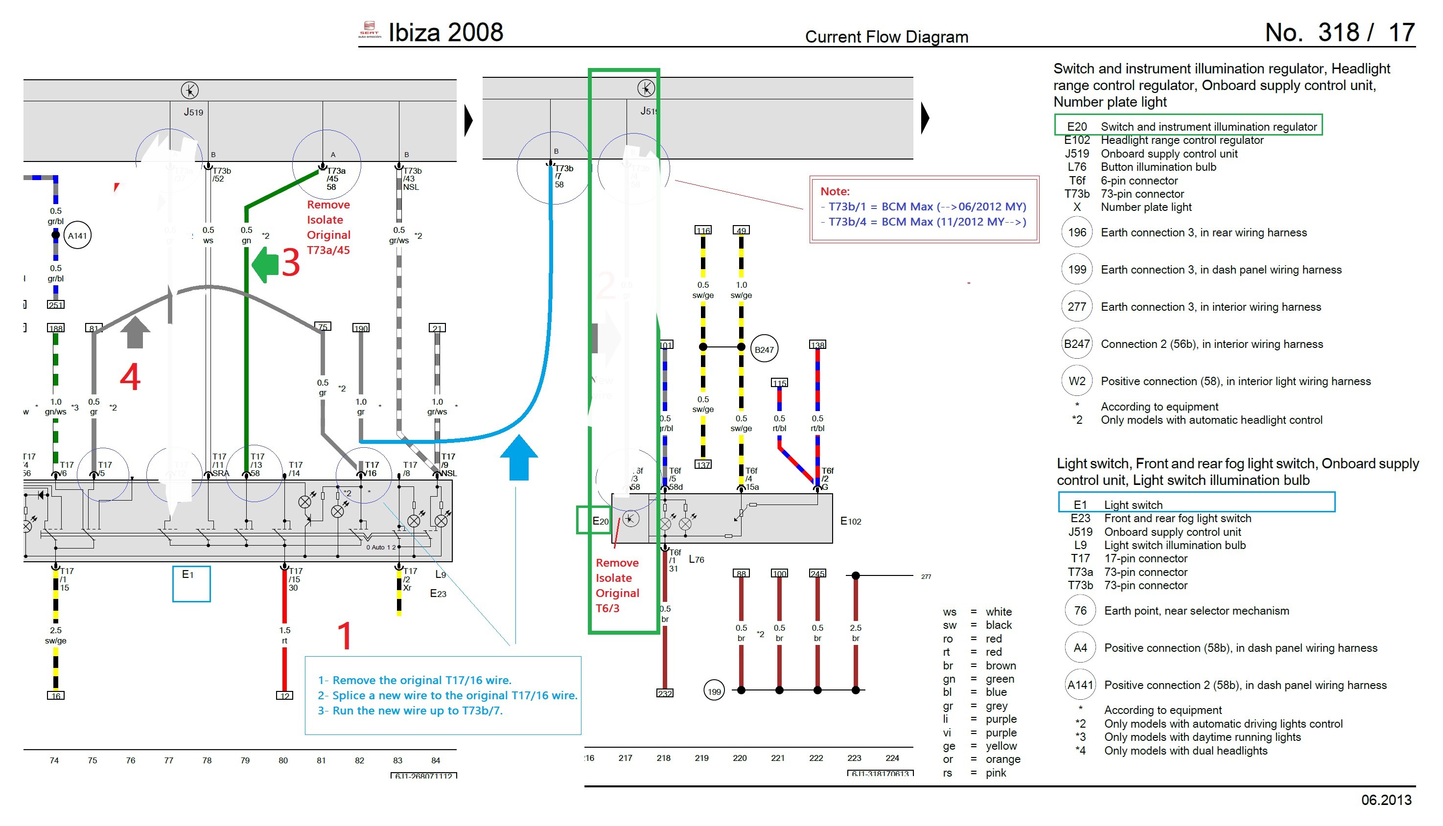

- Posts: 8989
Well, the final conclusion is that your electrical installation is not correct at some point, either original wires were used when it was advised to use "new wires" and isolate the original ones, or the wires are interconnected (drl with parking/side lights wires) due to some trick done in the past.
You must use a multimeter to make sure that the wires are not connected to each other (drl with parking).
When you are absolutely sure that the installation of the wires for the parking lights is as in the following diagrams (1 or 2), contact me again.
1
Note: front and rear share the same wire.
2
These diagrams are a repetition of what has already been indicated for this installation, perhaps it is easier to understand this way.
All possible BCM codings will only work correctly if the electrical installation is correct.
3 DRL
You should also check the new installation of the 5 new wires in the area of the light switch - bcm.
It must be as indicated, it's very important.
viewtopic.php?p=585264#p585264
While you make sure of all this, use this BCM coding:
7C8829F88861010001200EF06EEB9EC85FC067FF608D30C1200000030000
It is the one that most closely approximates an original and legal condition.

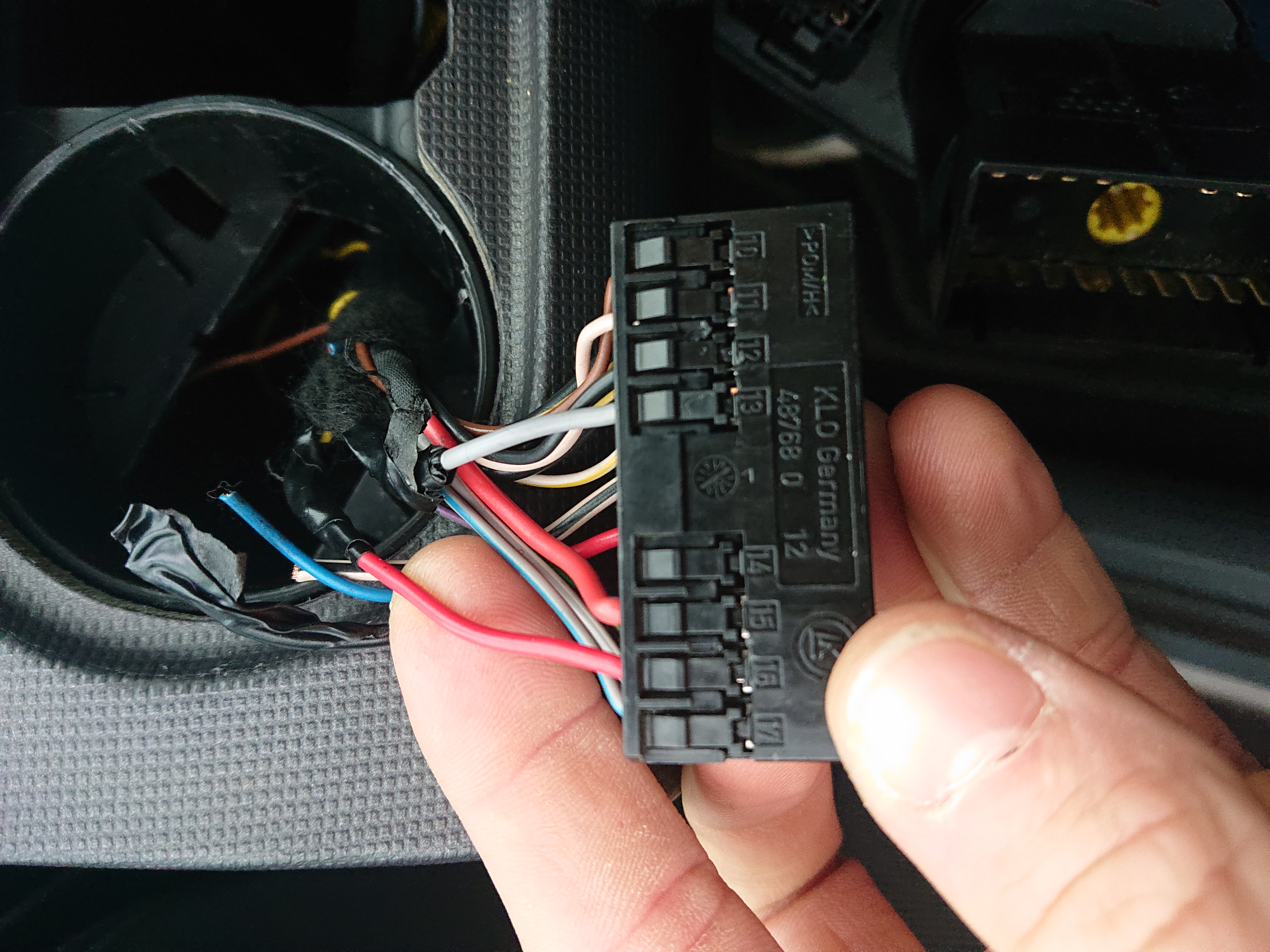

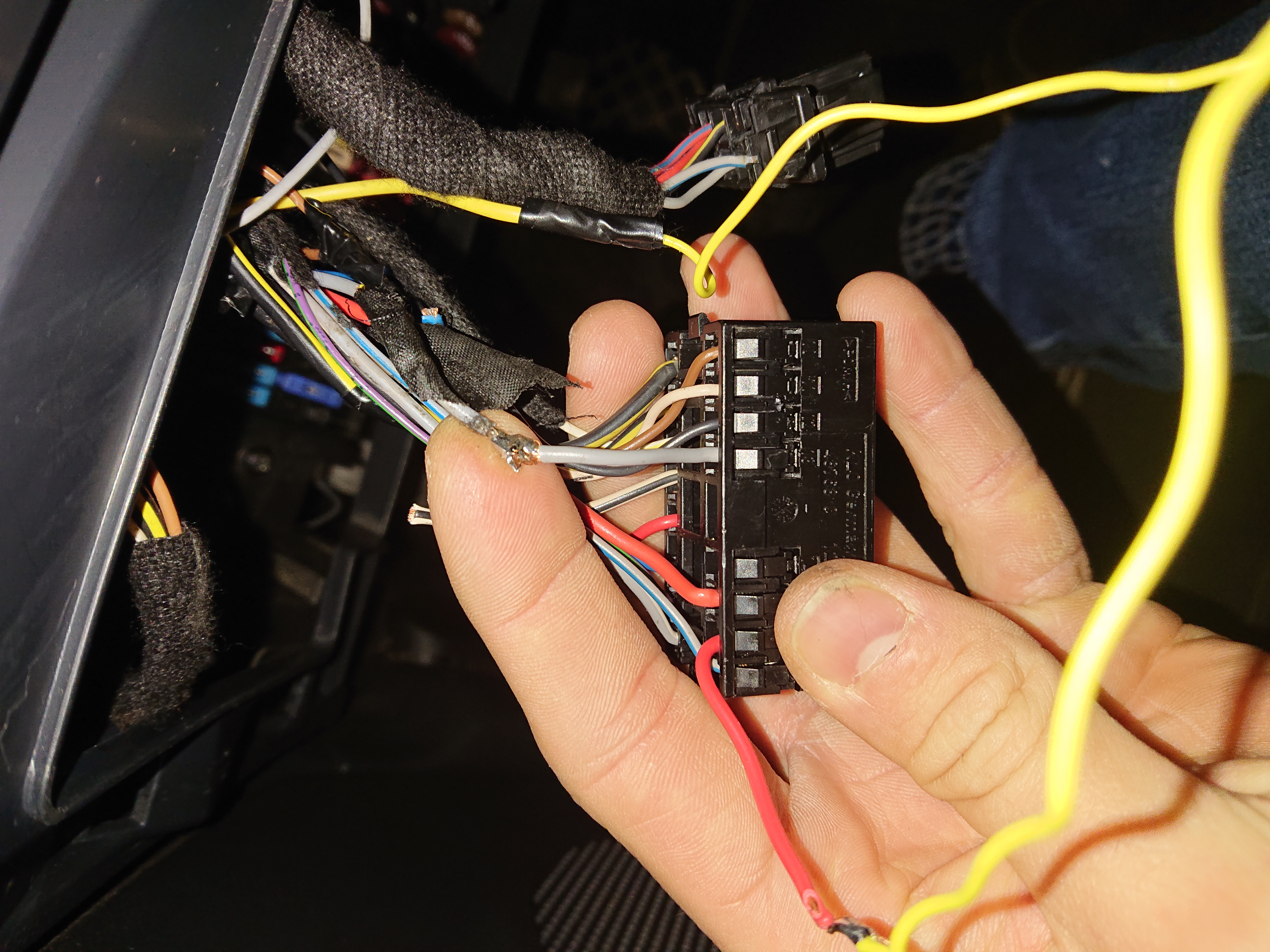

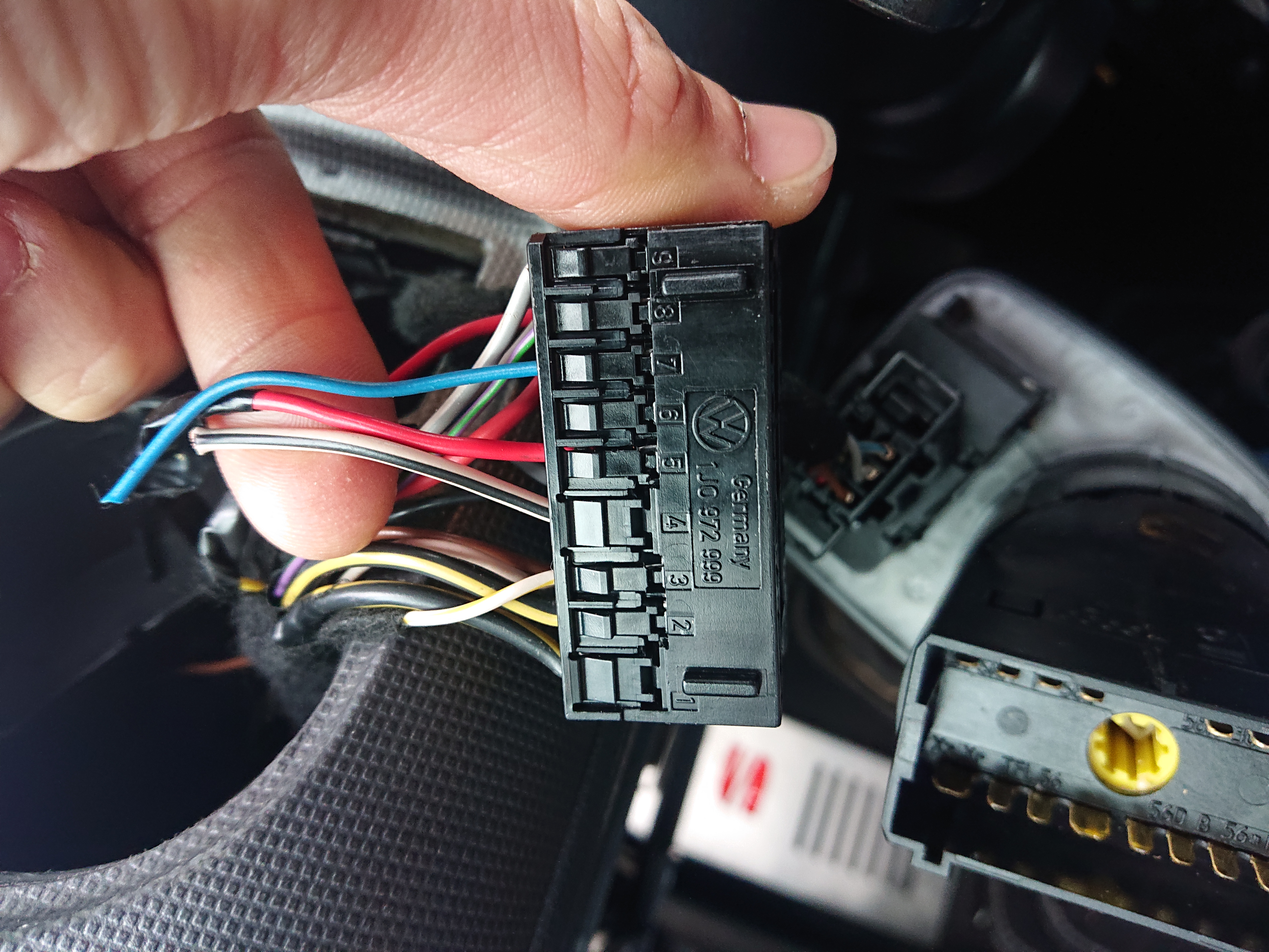

2.5 are ok, 3 should be taken from bcm and insulated? I will finish the work, I will visit the company service and check the correctness of the wiring from the above diagram. Throw advice on how to drag the cables from the cabin to the lamps, I will break the wiring and add 2x2 cables to the front lampsciclo wrote: Wed Nov 17, 2021 3:45 am Well, the final conclusion is that your electrical installation is not correct at some point, either original wires were used when it was advised to use "new wires" and isolate the original ones, or the wires are interconnected (drl with parking/side lights wires) due to some trick done in the past.

- Posts: 8989
Everything will work perfectly as indicated in the diagram I made for you (and everyone).
You make me understand that English is difficult for you because everything is perfectly explained in the diagram. I think that is the problem of everything that is happening.
I am going to explain it to you so that you can use the translator in case it is necessary.
Wires.
1- Remove original T17/16 wire , once remove it, splice a new wire to this removed wire, and connect this new wire to T73b/7. (the T17/16 slot is now empty)
This action will make your license plate lights work properly.
3- In the BCM black connector you have to remove the original T73a/45 wire and isolate it. Now install a new wire from T17/13 to T73a/45.
4- Install a new wire from T17/5 to T17/16.
Easy and simple.
I don't know how the people who retrofit the Ibiza 6J run the wires from the cabin to the engine compartment.
Do some research on it, surely you will find in a retrofit (CCS for example) how they run the wire that goes to the ECU.
The correct thing is that you find the place where the original harnesses run. Look from the engine compartment towards the cabin.
Example for the 6R: viewtopic.php?f=56&t=69648&p=520795#p519846, more images
https://www.uk-polos.net/viewtopic.php?p=540413#p540413

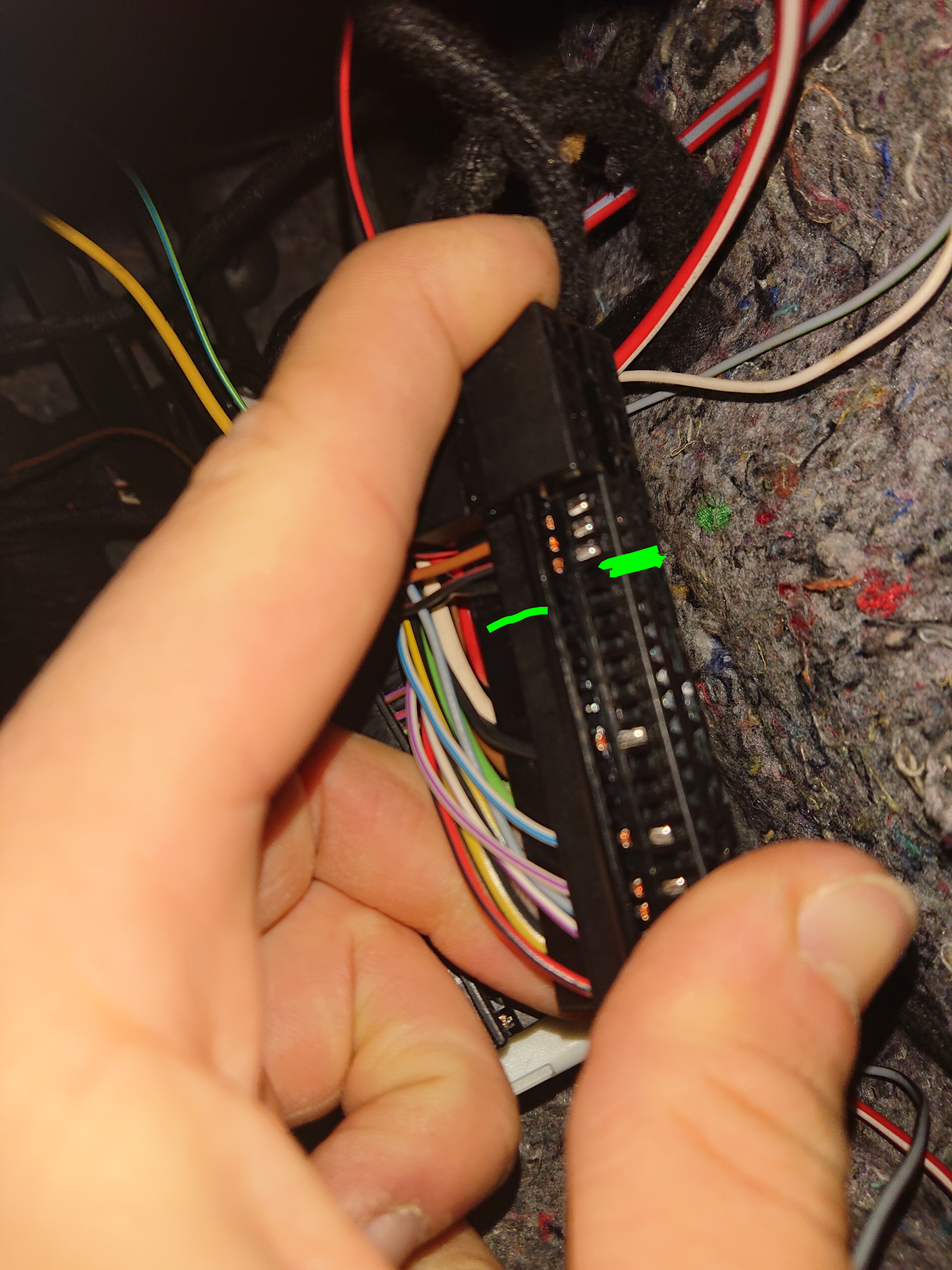

What the f**k is done here .... Cable 4,5,7 cut, bridge t17 / 5 -> t17 / 16 cut, t17 / 16 bridged to T73B / 7. cyclo tell me what the T17 / 7 cable is responsible for, how important it is, I will connect it back (currently cut and insulated),
I do not see the original T17 / 16 cable in the original bundle, because there was a t17 / 5 bridge -> t17 / 16, so what cable should I connect to the t73b / 7?
a f*****g idiot not an electrician
Edit: t17 / 4 (j828 relay) ok
- DSC_0906.JPG (6.85 MiB) Viewed 5302 times
- DSC_0907.JPG (6.96 MiB) Viewed 5302 times

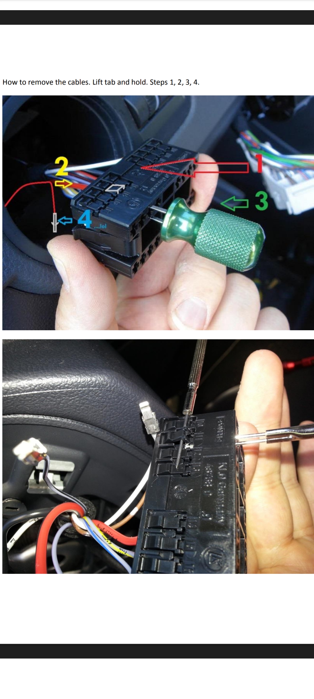

I have a big problem, I can't pull the cable out of the T17 ankle, do you have a patent for it?
arduos2
- Posts: 1
- Joined: Sat Aug 10, 2019 1:55 pm
- Drives: Seat Ibiza ST 2014 1.4 MPI
- Location: Polskai
Foto by guru "Ciclo"
- Screenshot_20211117-205835_Drive.jpg (892.46 KiB) Viewed 5334 times
