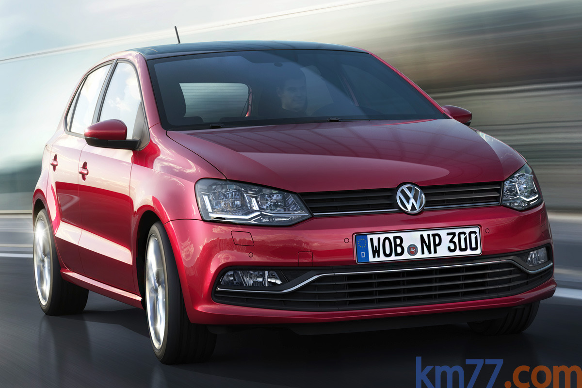

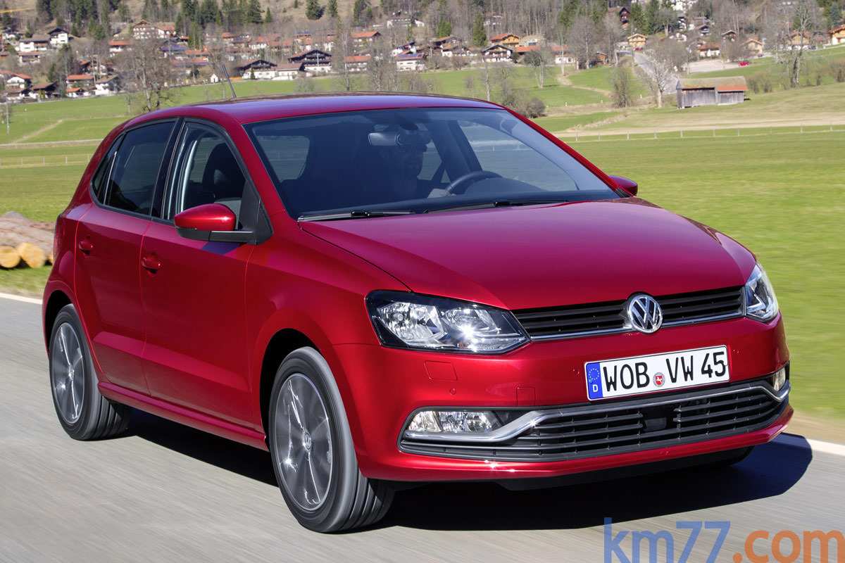

It is a straight swap.
But what I mean is that these halogen headlights:
Not are the same as these LEDs: (which will not be a straight swap)

6C halogen headlights (first image above message) is straight swap for all who have 6R halogen headlights, whether H4 or H7. Manual range adjusment lights.
Speculation:
6C LED headlights (second image above message) will not be possible because the daytime running lights and corner lights will be controlled by the BCM. In addition, will probably have a control module similar to 6R xenon headlights. Automatic range adjustment lights.
