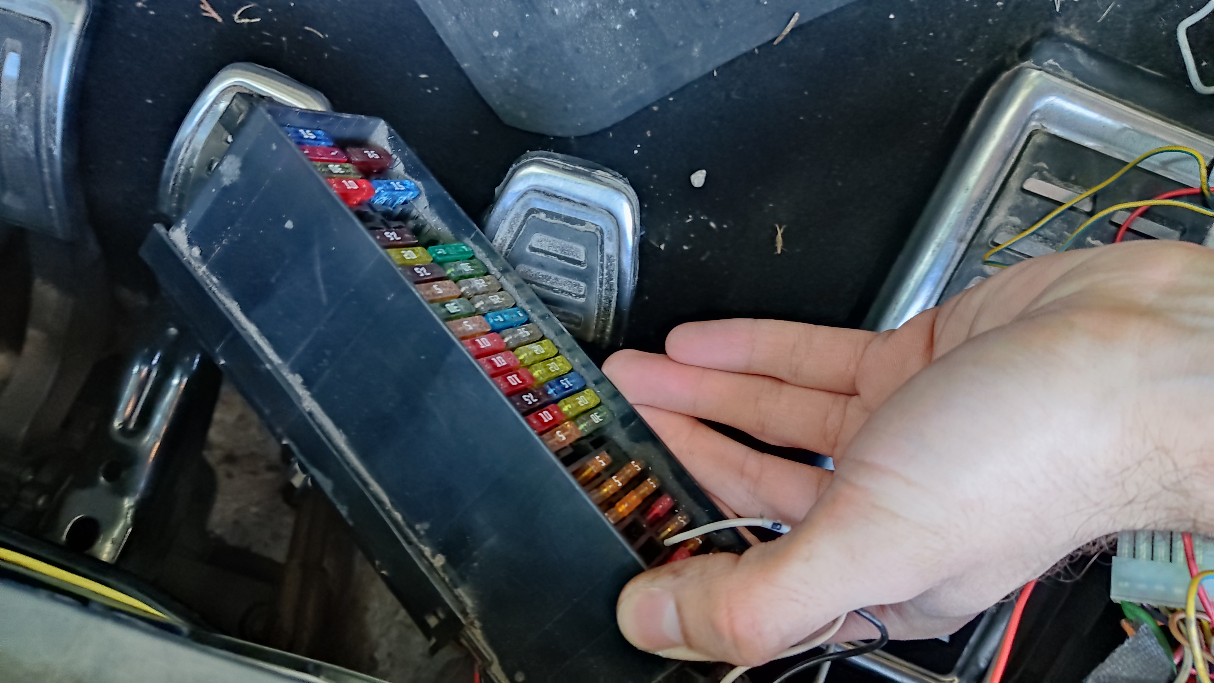

Re: Fuse overview VW Polo 6R and 6C
are there any instructions how to open the fuse box cover.
I removed the air duct, Remove the fuse box down.
How do I open it to access the wires? Are there any instructions ,?
pry on small tab and slide it down
