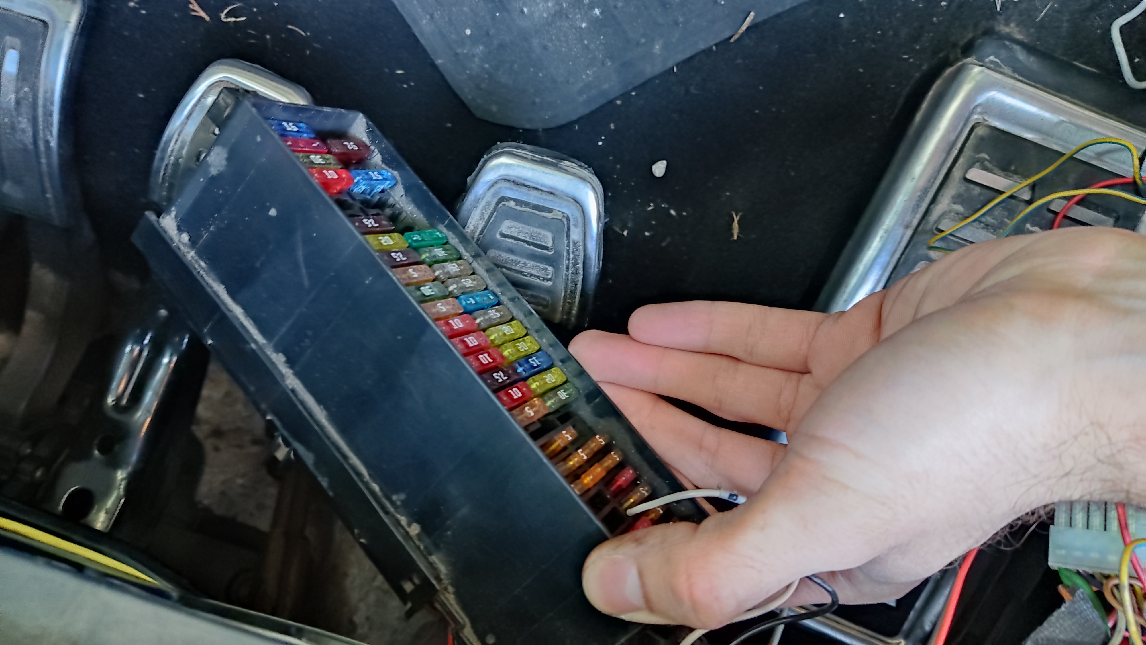

Posted: Thu Feb 23, 2023 11:54 am
by amer6R
are there any instructions how to open the fuse box cover.
I removed the air duct, Remove the fuse box down.
How do I open it to access the wires? Are there any instructions ,?
pry on small tab and slide it down
Guys can i get a little help.
How do I remove the fuse box connector from fuse box carrier?
