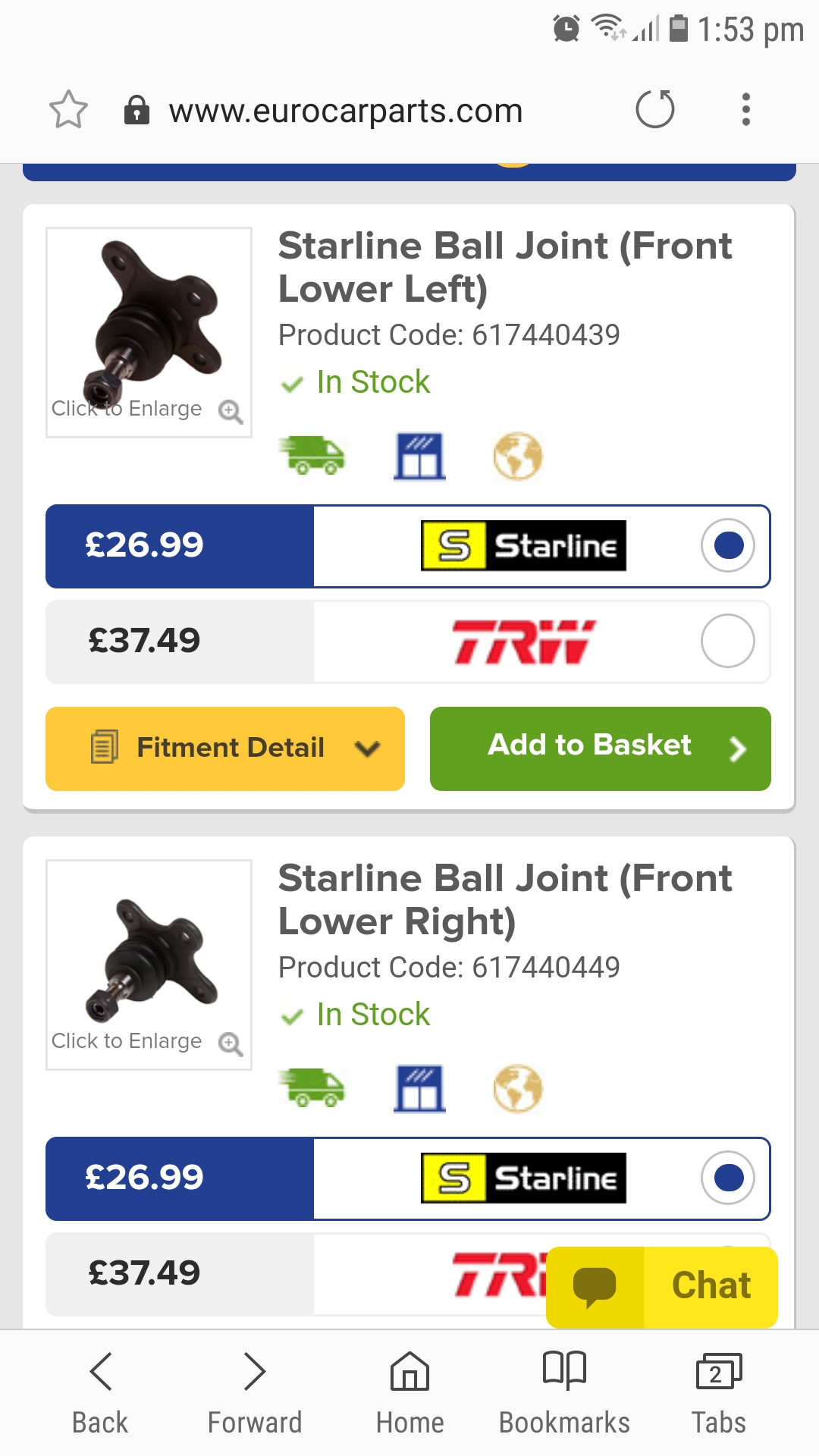

Just been on the euros website and they have left and right for my car which look handed in the pics, are these the right ones?

Re: Odd front wheels haha
Posted: Thu Aug 16, 2018 2:14 pm
by 937carrera
Part numbers are in the other thread, I suggest you call ECP and try those as I know they are correct.
Or just try changing to the quality supplier, might bring up the same part number

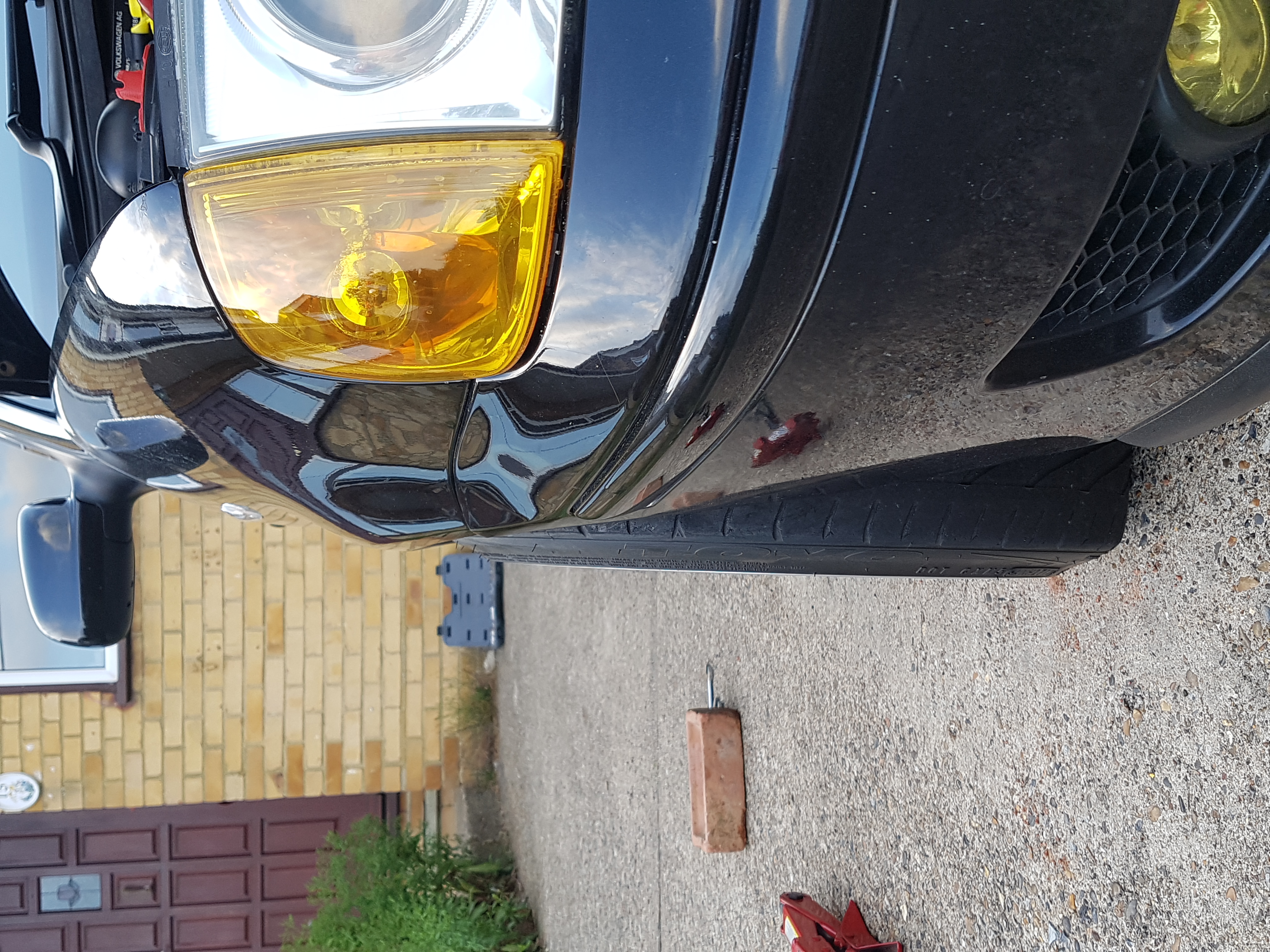

Hello again, I really appreciate everyone's help by the way, so today I swapped the ball joints over and they now look like they are sitting properly, the hub is now touching the nuts and is more central how it should be but I still can't figure out why my driver wheel is sticking out about 10mm more than the drivers side....
Passenger side
Drivers side
I did roll the arches slightly, years ago but I don't think that is the problem, it's very weird, the problem could also be that the drivers wheel is right and the passenger side is sitting in......who knows......baffled.
Posted: Sat Aug 18, 2018 8:42 pm
by alexperkins
Get the tracking camber and castor adjusted And go from there
