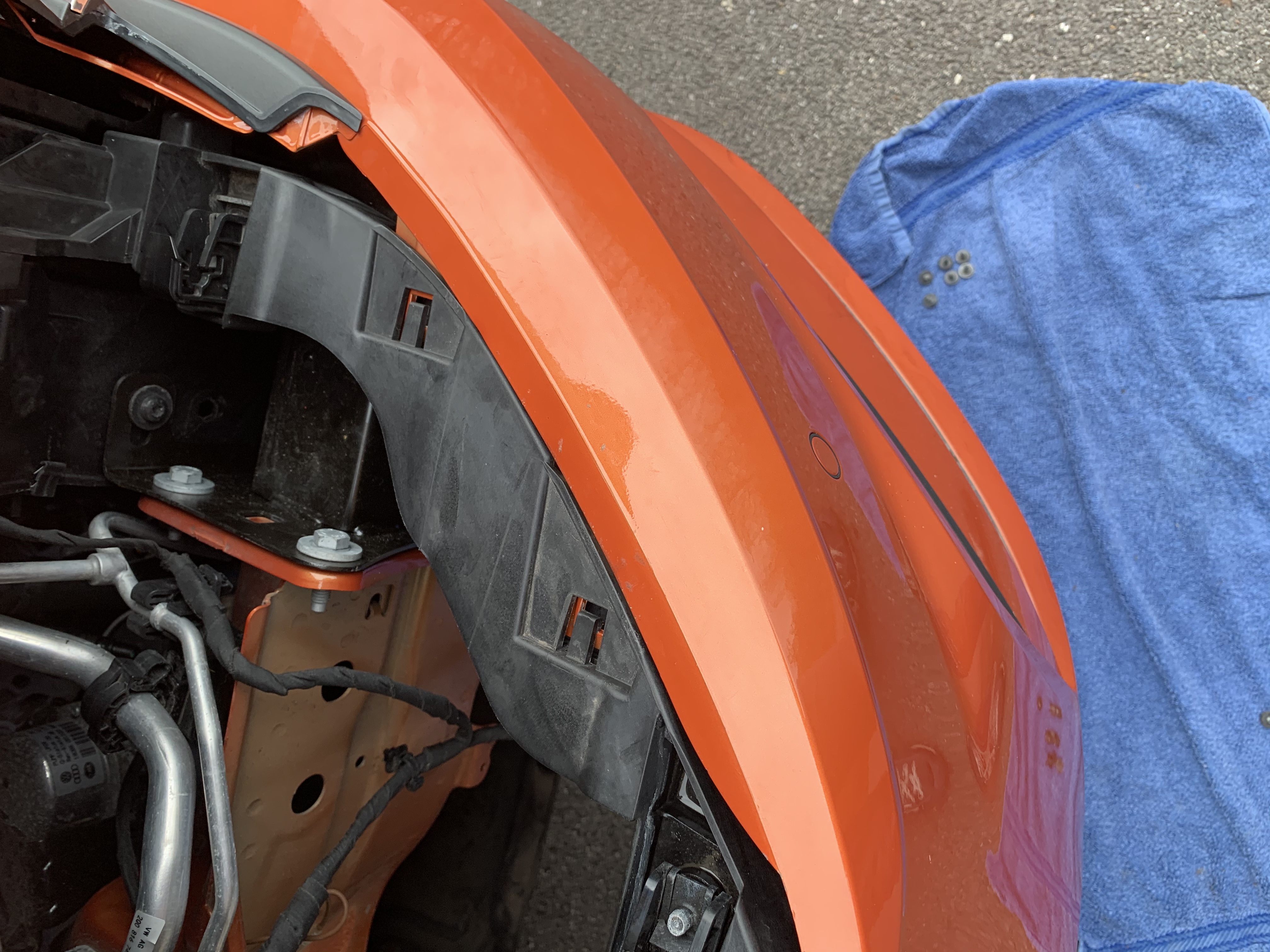

Sorry to revive an old thread but tried to remove my headlights today to switch the bulbs and loosening them was easy but no way were they coming out as the front bumper seems to overlap the bottom of the headlight. Mines a 2018 SEL so might have different front bumper?
My last Polo was easy, 2 minute job.
It looks like I’ll have to remove the front bumper to remove the headlights which is crazy, anyone able to help?

AHA polo wrote: Tue Dec 08, 2020 5:16 pm Sorry to revive an old thread but tried to remove my headlights today to switch the bulbs and loosening them was easy but no way were they coming out as the front bumper seems to overlap the bottom of the headlight. Mines a 2018 SEL so might have different front bumper?
Changed bulbs in my 2018 Beats and 2020 Gti.
They do come out, nothing obstructs them, they just need a good thump at the rear to release the plastic guide tabs at the bottom edge.
It is a good idea to put a cloth on the bumper, as the headlights don't have to fall down very far on their way out to scratch the paint.
Also be aware that you may get misty headlights after doing this.
Both my AW Polos have suffered from misty headlights after changing the bulbs, god only knows why.

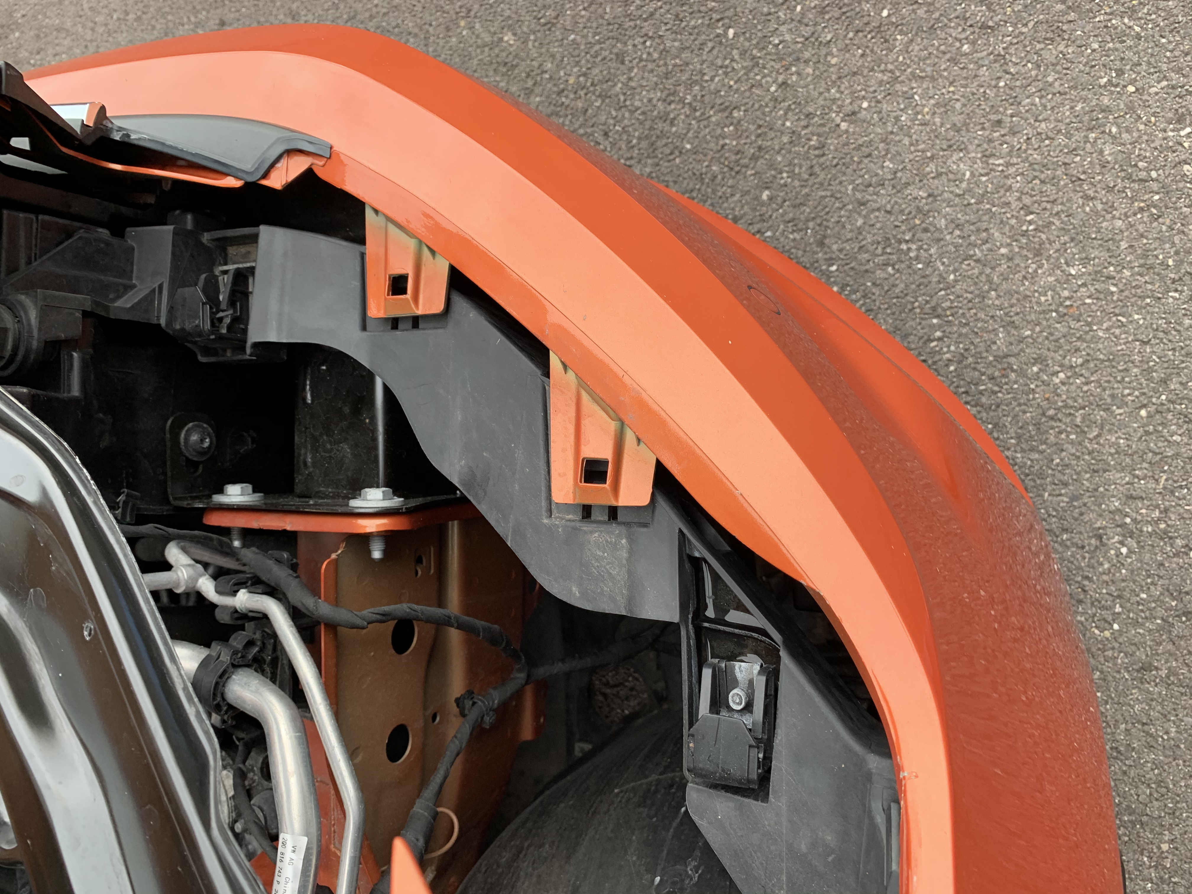

Thanks Andy Beats, I managed to get them out by slipping a couple of old plastic store cards underneath first to get them to rise over the obstruction. When I got them out I found my problem, someone has previously removed the front bumper and not put it back correctly so the two big tabs that are just under the headlights weren’t fitted into the housing, but over it. Was a right pig to get it corrected as had to remove wheel arch liner and bumper supports but just about there now!

by AHA polo
That’s better!

Don’t know but guess for re painting. Everything is straight and looks original underneath, the right side of the plastic bumper does seem to have a bit more orange peel effect than the left side but you only notice if you look really close. Sorted now anyway!
