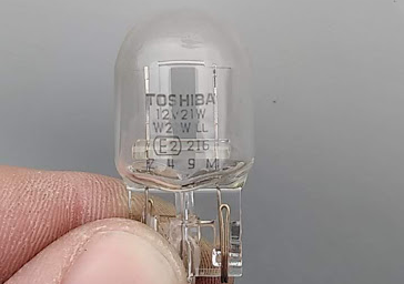

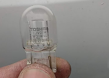

Hi all,
Visited the dealer yesterday as I was passing the place. Two of the technicians had a look and they tried all sorts to get them to come on with no luck so they checked the VW database of the original car order and it stated the car was built with daytime running lights so they suggested they should be working which they are not.
After saying I would need to pay for a diagnostics of £72 I booked the car in for a few weeks time and then emailed the dealer when I got home asking why I need to pay this if they have never worked on the car. They are going to wave the fee when I take the car in and to try and resolve the issue under warranty after a received an email back from the dealer manager this morning.
I did say I will try changing the bulbs tomorrow even that they look visually ok just to be sure but today I took both of them out to check that they was connected to the wiring loom which they are and both connected and so that I could get the bulb type. Images of both bulbs below which they look like type 582 ones which tie in what was said above and they look visually ok and unused
There is no setting in the infotainment car settings either
Chris

Yup, those (the posted images of yours) are the very ones. What do you intend replacing them with - the self same bulbs, or completely different types? If the latter, then be careful, as that could open a veritable can of worms. As for supplies of the existing DRL bulbs, I found in my audit that VW had gone to considerable lengths to use filament bulbs on the vehicle that were of the best quality around and therefore ones that'd probably last longer, so when buying direct replacements of these I'd strongly advise you get the self same ones; if necessary, even buy them direct from your VW dealer. If, however, the intention is to experiment with alternative bulbs, even LED types, than that'd be entirely your own choice.
But as for your existing DRLs - and here I'm assuming you're definitely referring to the bulbs of the outermost section) - they should definitely come on as soon as you insert and turn the ignition key, and should stay on when the engine's running. That's with the lighting switch in the 0 or AUTO position (daytime situation; it's somewhat different for night conditions). I seem to recall that it was legislation brought in about 7 or 8 years ago that required all new cars to have daytime running lights, and therefore they were organised on new cars so that you couldn't permanently turn them off. So, if those techies are certain your vehicle is fitted with DRLs - and certainly the evidence seems to point that way - those DRLs should definitely come on with the ignition.
A plausible explanation could be that someone, prior to handing over the car to you initially, disconnected them via a wiring connection somewhere but forgot to put the connection back. Did you get the vehicle brand new? One other possibility is that the lighting fuse (dashboard fusebox?) for these is either making poor contact or has blown, though I'm not sure if the DRLs have their own dedicated fuse. If it does have a dedicated fuse, then perhaps , on your Polo, the fuse value is a little on the low side and is easily blown?
PS. When you test out the DRLs don't have the sidelights or headlights on as well, because that affects the result. I notice that that's the situation in your originally-posted images. Just have the lighting switch in the 0 position, ensuring that the knob is fully down. Then insert the ignition key and turn the ignition on.
If, after all of that, the DRLs still don't come on, then surely it must be down to a software problem? There have almost certainly been one or two recommended software updates since 2015.

Thanks for the detailed reply.
The bulbs are not being replaced with anything. I am just trying to get the DRLs working as they have never worked but anyway got some Osram ones coming just to test to rule out faulty bulbs.
With regards to how the DRLs work myself and two VW technicians have all tried to get them to come on as per your suggestion below with no luck. I even made sure the wiring loom plug is connected to both which they are.
Am not aware of a separate fuse just for the DRLs. The manual does not list any and online fuse guides don't list any either just for the DRLs.
I assume they are not activated via the management system which is why VW have asked for the car to come in for a software diagnostic check which they are now providing free of charge as well as a loan car.
My only thing to do next is fit the osram bulbs when they arrive and if they still don't work there is not much else I can do so its over to VW
Chris
