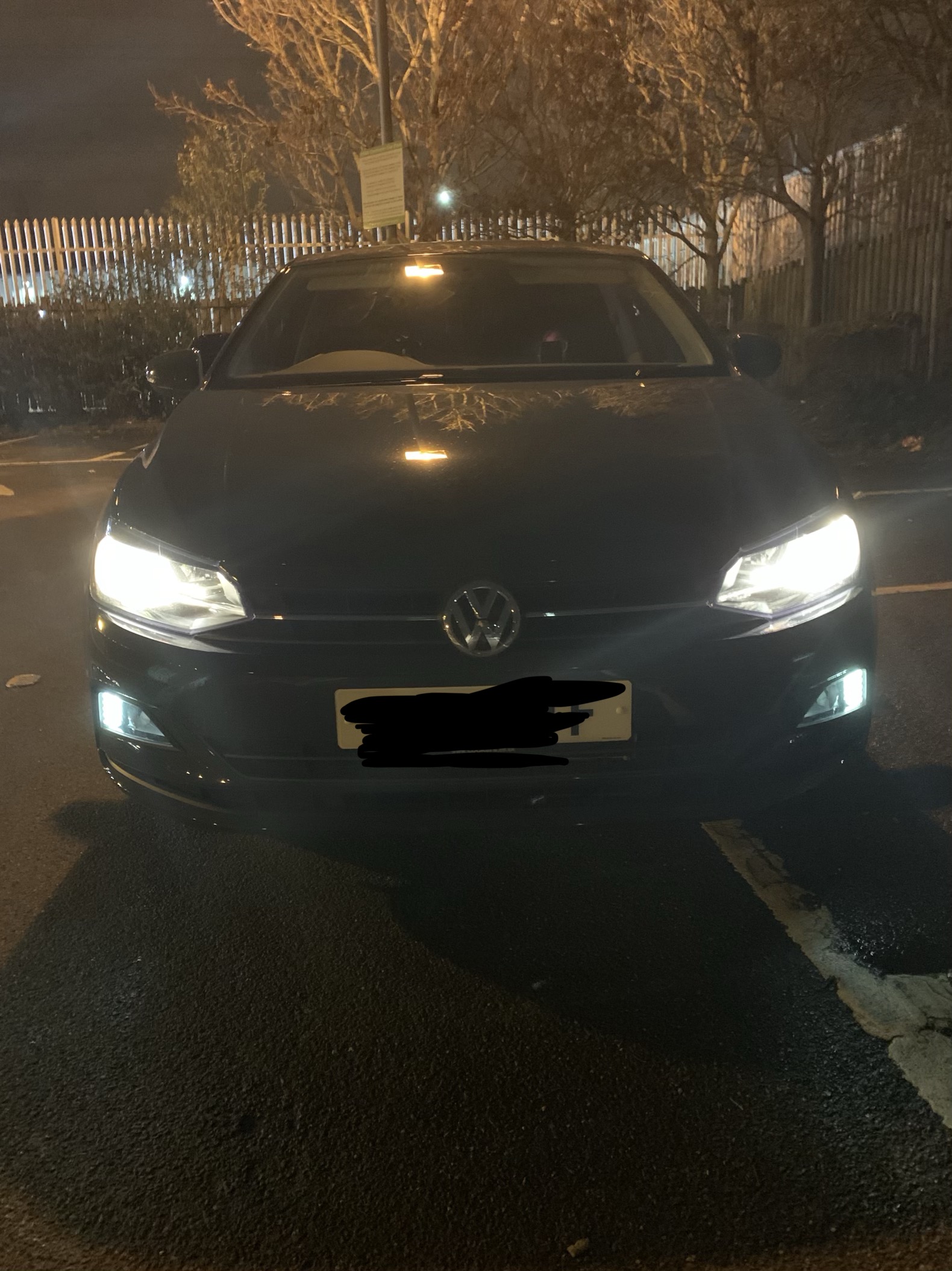

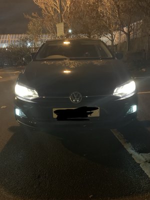

Hi Andy,
Iv already got the Phillips bulbs you want to order as my dipped beams. I’ll post some pics so you have an idea of what your getting and iv also got the Osram for my high beams. Let me know what you think. Iv had the bulbs in for about 7 months now.

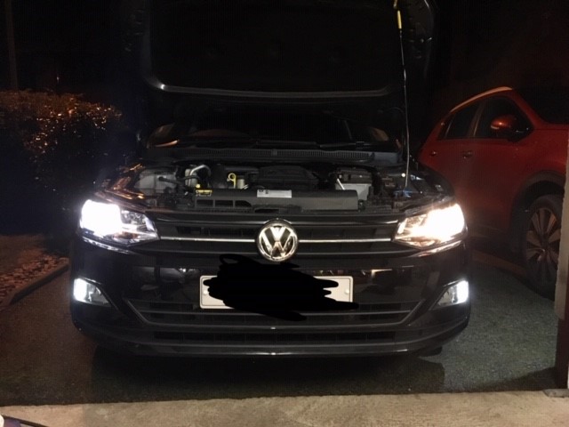

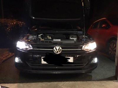

Here's the 5000K Philips bulb compared with standard.
No need to tell you which is which.
I've got this bulb change down to a fine art now, headlights out/changed and back in in minutes.
