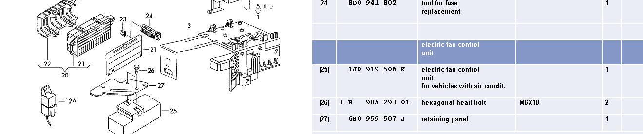

Yeah I had seen the bolts on the u it was working out where they are on the actual car that was the pain, when I had the battery tray off it’s was obvious where they were. Will be a week or so until I can have another look at the car. This is a personal challenge now I won’t be beaten by the bloody thing!

Ahhh sorry no what I meant was I have seen that the bolts are on top of the unit, but I’m not sure where they actually are from above. Any clues as to where I need to aim the WD40?

Ah, my memory is a bit rusty as it's a few years ago, maybe this will help = there's a sub plate involved
